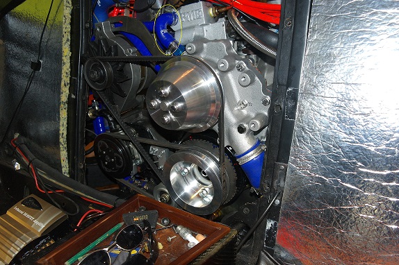

Engine is running warm/hot in stop and go traffic, it has reach 108C.
What will hapen if I disconect the bypass hose? Would the engine run cooler???
Some of the remote croosover thermostatic houses
do not have this bypass fitting.

Check the points Bill raised. However I have put a restricter in the bypass that prevents too much flow. In the normal car layout the rad is close next to the outlet with minimal flow resistance, in a GT40 there are long pipe runs with greater resistance. The restricter ensures maximum flow to the rad yet allows the thermostat function control the warm up. Some other manufacturer engines have a t/stat that has a shield or shutoff plate that covers the bypass port when the stat opens.

So you mean in a clevlandthe thermostat with neck and that plate in the block close the water feed to the pump for in engine cirkulation !?
And if I put a restrictor in that hose between the thermostatic house and the water pump it could reduce the engine temp. What will happen if it is blocked/cloosed?

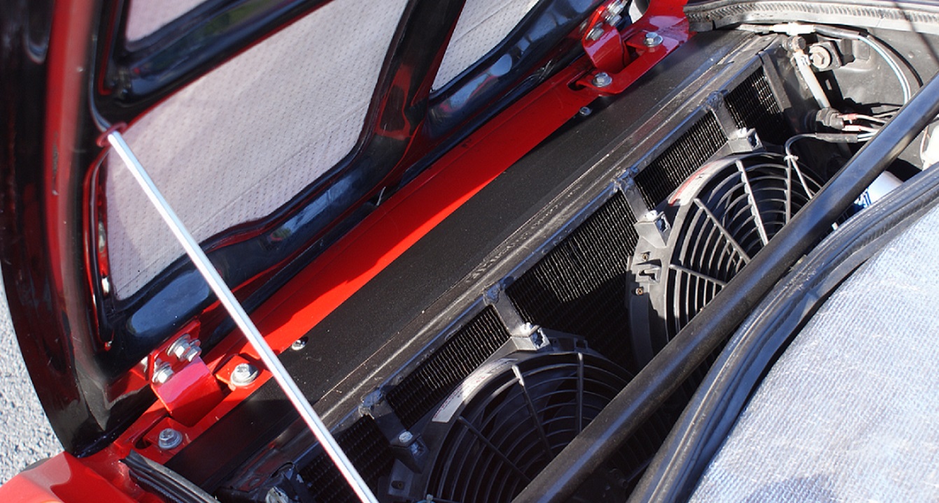

If the temperature is OK when running at speed down the road and overheating in stop/go traffic then you are getting enough airflow through the radiator when moving but not when stopped or slow then your fans are not giving enough airflow when stopped. This seems to show that your fans are not moving enough air through the radiator. Get better fans and/or ensure that they are close to the radiator or they will just spill air round the edge rather than pulling air through the rad. Maybe some pics of your rad and fan setup may help.

I have to agree. Not a 40. What I do see though is not much room for the hot air to escape from the radiator area. I guess a better pic of that area might tell me different. So my suggestion is to work on the area that the air has to follow in order to get out of there. If generating pressure in that area behind the fans then it will stagnate at low speed. May have to open some vent holes in the fender wells??

As others have pointed out, there is not a clear path for hot air to exit from out of the front hood on the Pantera and this is a common issue on them. Hood vents will help a lot to get air flowing through and out. This is quite a common modification for Pantera's.

in addition to all the good advice above......depending on available space, a fan shroud will add considerable efficiency to the fans ability to draw air over the whole radiator....
