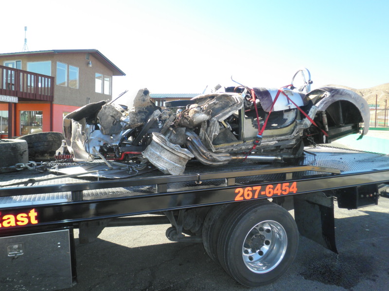

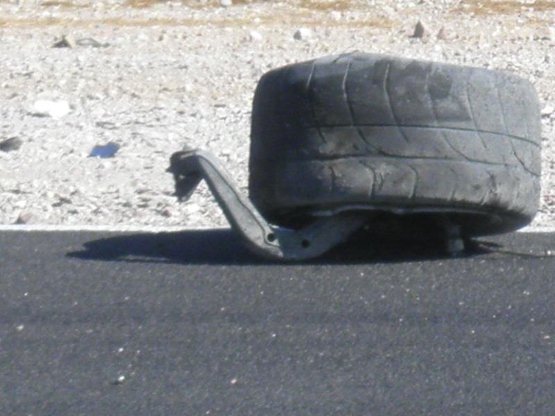

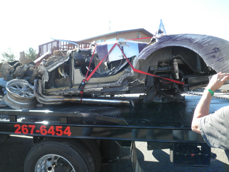

Heres what happens when a rear suspension lower a arm fails and comes off the car at 100MPH. It went over at least 3 times. Check out the roll cage and roll over bar. Just luck on this one guys.
This is why I call them "it el kill ya parts"
The driver was walking around after the insident and generally OK.
No names or other information for now. But I hope to prompt a discussion on roll over protection and general safety equip. Buy the way compair this car with Ron's T70. Tell me whitch one you would pick to take this flight it.

I realize debris and so on has been put into the car for storage, but that looks like a mess.
Track day car = full sanctioned cage as far as I am concerned. Not a four point cage, historical cage, roll bar, etc, but a full on racing cage. It isn't easy to do at all in a GT40, and I haven't seen a company provide one as an option, but it is possible and what I'd do if I seriously intended to take a GT40, or other similar car, to the track.

While it is "sanctioned" for historical racing, to my knowledge the cage would not pass through SCCA or NASA tech. We have SCCA inspectors on the site though and they could discuss that further, but when it was discussed last year I recall numerous key bars missing.
The advantage that modern cars have over a T70 spyder or a GT40 is that you can pretty much have a full cage in the car and can go largely unnoticed. You could take a Mustang or Camaro and cage it, and with careful design have a passenger seat and still use the car for daily use if you were sort of hard core about it.

I think I agree with Ron on the full sanctioned safety equip requirement for at least the "fast" group at most track day events in concept. The problem will be that most cars won't meet them and as sanctioning body rules improve (become more stringent) then the cars become more and more difficult to update. At the least, crash cages and their design could stand a rethink in many cases including open top cars. Fire systems really need to be considered as mandtory in closed cockpit cars like GT40s especially, for obivious reasons. And then there's the question of how fast is fast and WHO is going fast? Lots to think about here, but I am personally really leaning towards a NASA or SCCA license in my future. It wil cost some money, but It would be a lot of fun I supect.
I opened this thread so that we could begin a dialog about the current track day safety issue. Someone at a recent drivers meeting said that a recent Porsche club track day he attended cost $1000 A DAY because of huge increases in insurance costs. He also said that that particular GROUP (not car type so don't flame me) had a costly record of on track "events".
If people start getting badly hurt or worse then the hand writing in on the wall. This form of the hobbie will just dry up due to rental costs/insurance. One way to avoid hurting people is to insist on better safety equip and closer tech inspections. At last years mininats the inspection included lifting each corner of the car to check wheel bearing play along with a relative comprehesive look at the car in comparison to most other open track events I have attended. This was a good thing and didn't cause much of a delay or inconvenience to most people. I bet next year most people will have gotten the message and as a result everybody will benifit.
The car type or driver idenity in the above example really isn't the point. I have no idea HOW the suspension failed. Just that it did. It could have been anything, previous dammage, worn out doner part, marginal design, or even a new part that failed. It happens. What the point is, is, that we all need to have a good look at our cars and do some maintance inspection of "it el kill ya parts" on a appropriate sechedule. Even replace parts based on track time if necessary. Waiting for it to break isn't going to work. I also don't know the owner of the car so of cource I am not commenting specifically on this individual incident or the drivers roll in it.
If this thread serves the purpose of getting people to really prep their cars in light of what clearly CAN HAPPEN then we will have taken at least the first step.

Because it did, right on the front straight in front of god and everybody. The idea is to promp my friends on this forum to consider the importance of a maintance program and thoughtful dicussion related to safety equip issues in relation to open track day events. Not to try and place factual blame on anybody or on any organization. Shit happens.....but it seams to happen less on your shoes if you try and avoid the ass end of the donkey.

Which is it? I'm asking to get information. Do you have this information? I have heard a ball joint broke and rear arm left car on flips 1 through 3...
