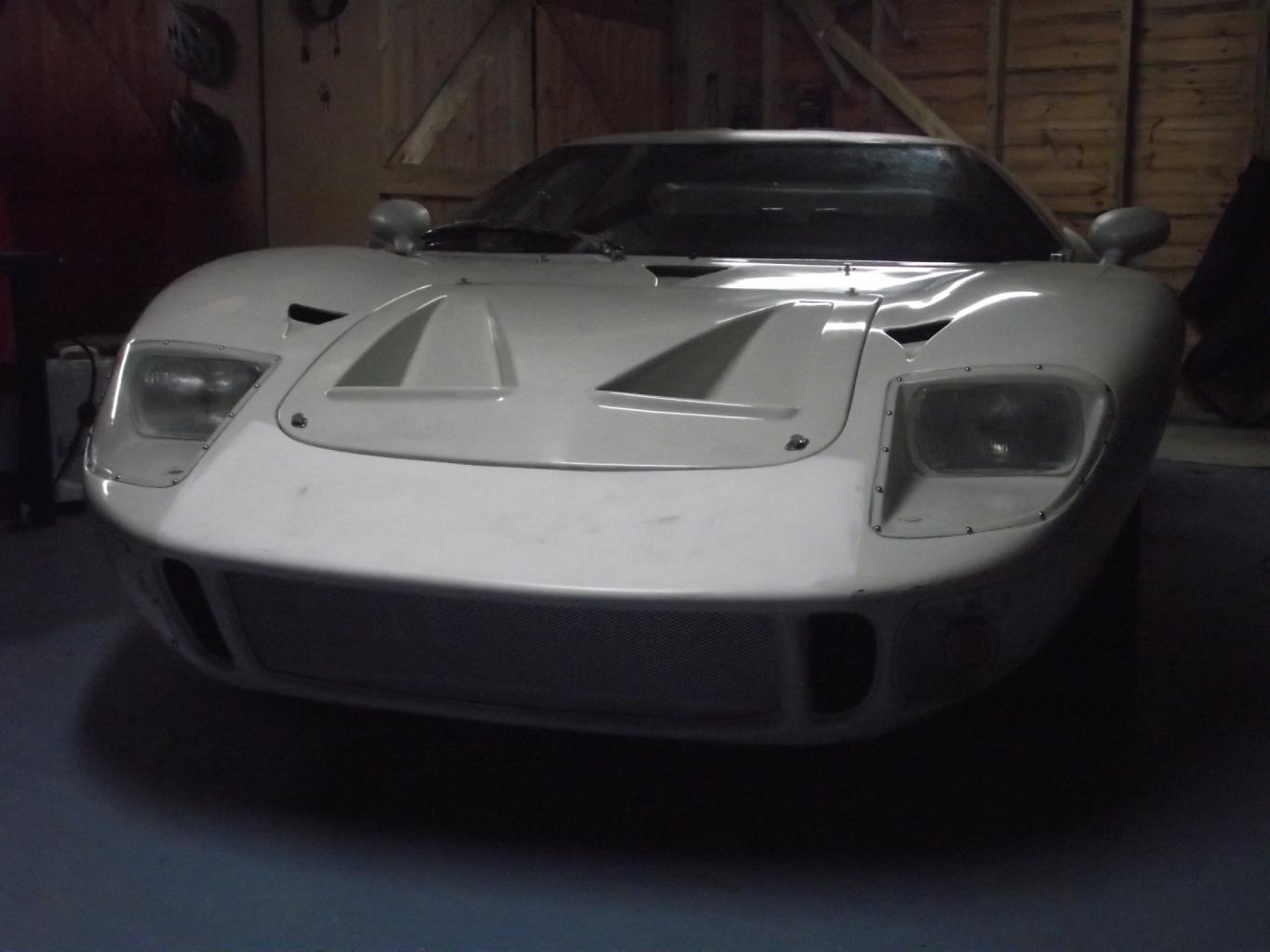

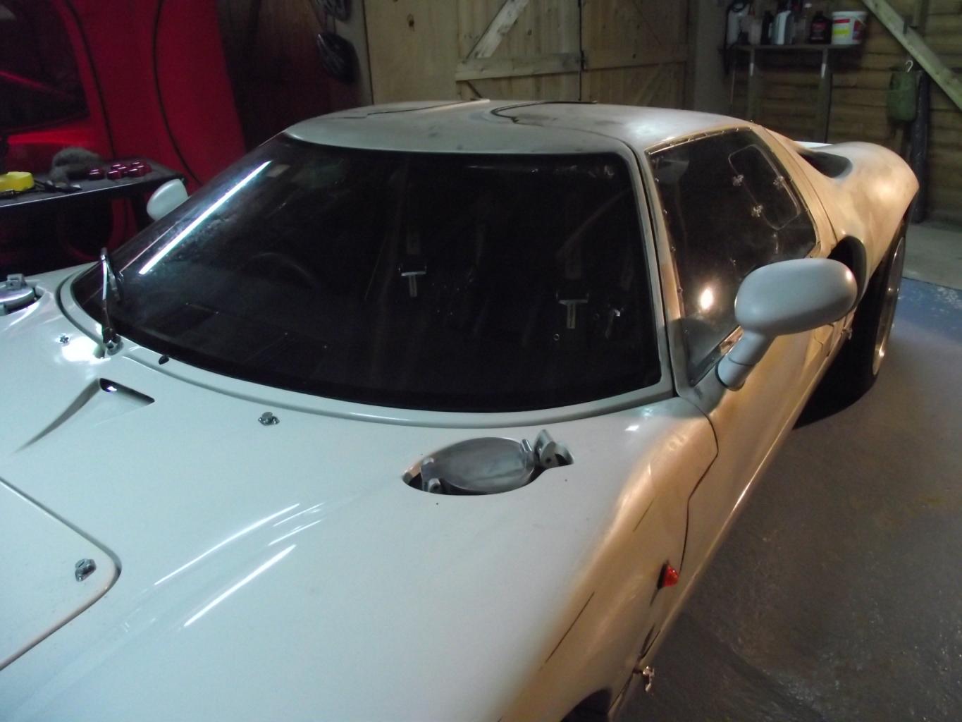

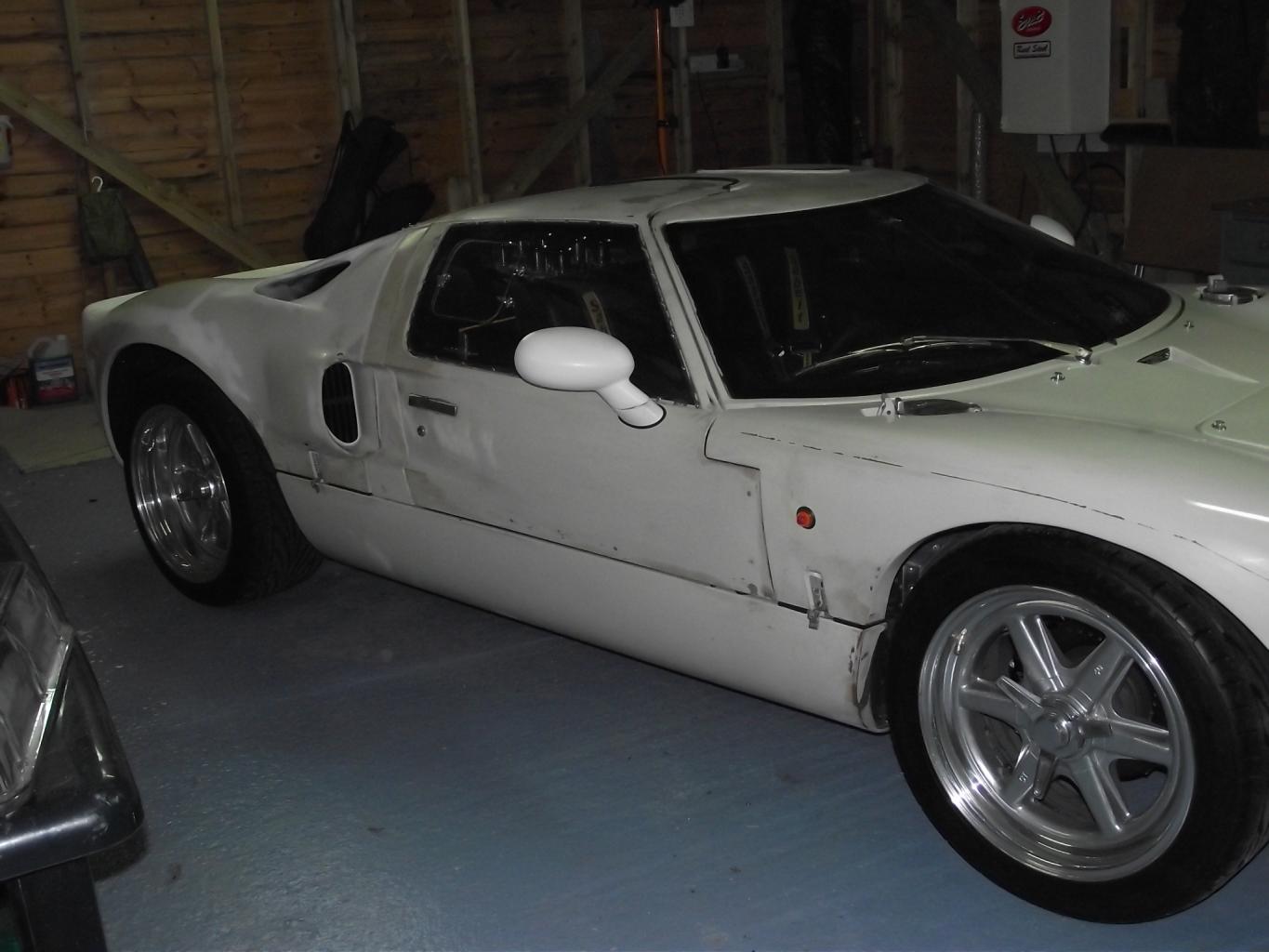

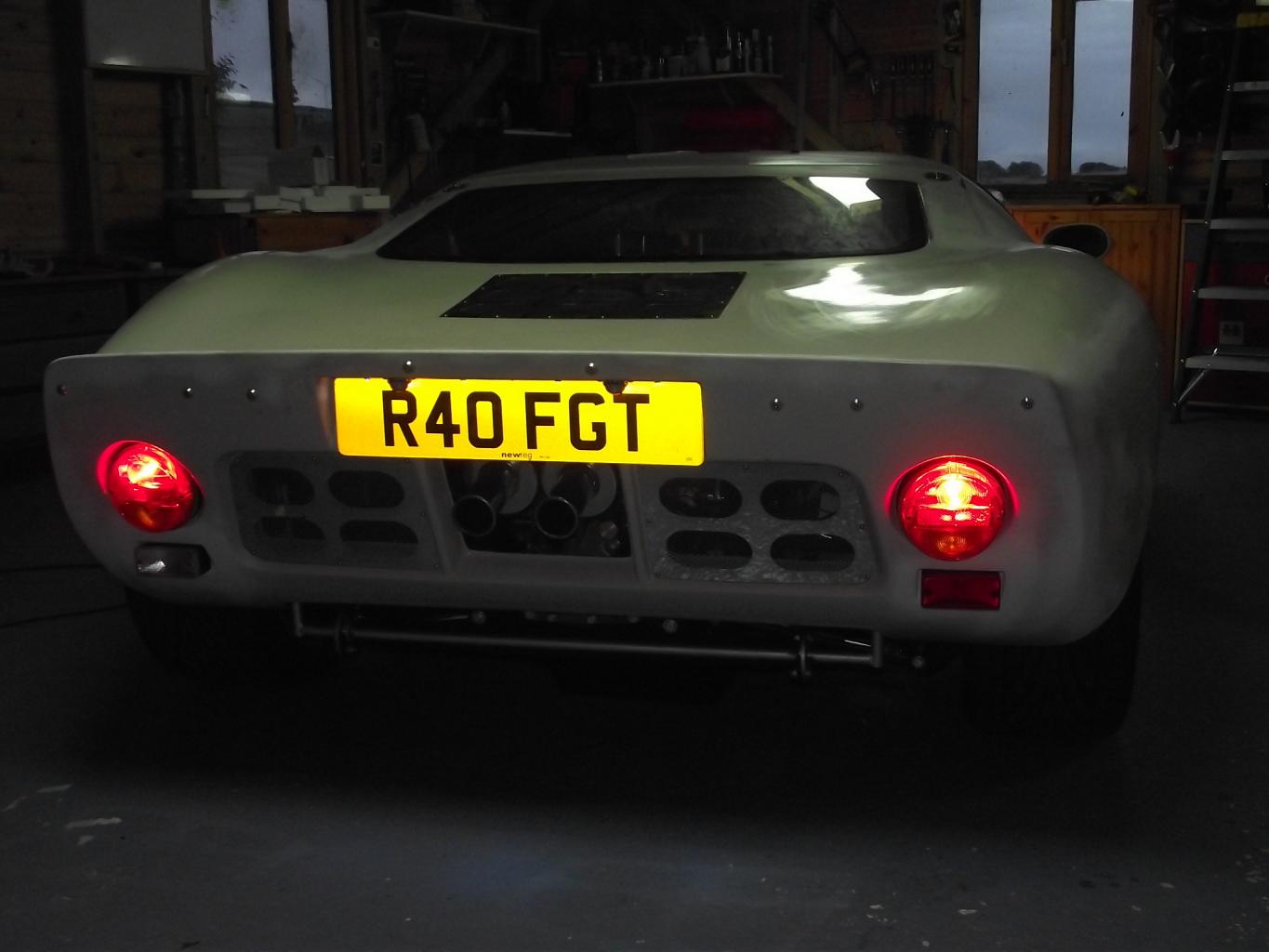

I recently learned that all the local DVLA offices across the country are shutting down over the next month or so with everything being moved to Swansea. To try and avoid all the associated confusion during this transition, and to take the advice of others on the site, I decided to pop along to the Aberdeen one today and get the car registered (it closes next week). I can confirm that you do need an insurance cover note with the chassis number, you need the V55 form completed, the IAC form, proof of ID, bills/invoices, a certificate of newness, and payment (naturally!!). Also, you do not need to present the car anymore. After completing all this and paying them they money over the counter, the DVLA then told me that none of the local offices can process this paperwork now as it all goes to Swansea already…doh! On the basis that all my paperwork was in order and they have taken my money already, I assume there will be no problems with the registration. Assuming it doesn’t go missing at Swansea, it will take up to 6 weeks now to get it processed. Meanwhile, I’ve fitted all the parts back to the car post the IVA, plus I’ve put the side windows on.

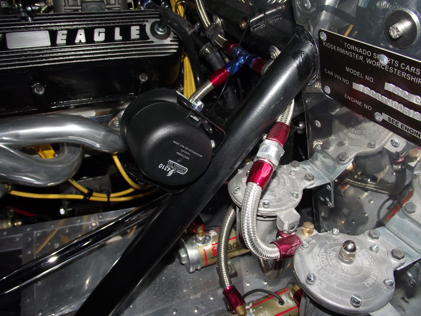

Andy G,

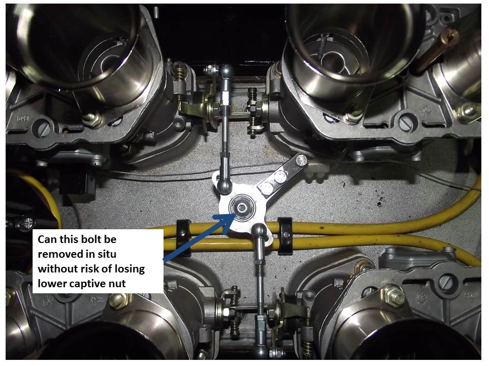

You asked me a while ago what was done to the sticky throttle to get the car through the IVA. The pedal was modified to bring the cable closer to the pivot point and the bellcrank was extended with a bracket to increase the leverage. Both were sufficient to get the car through its recent IVA, but the throttle is still resistant especially at the beginning of the travel. As the resistance is worse at the start of pedal travel, looking at the attached photo, my belief is that this is due to the initial angle of pull on the bellcrank.

Hi Ian
Firstly on the bell-crank at the carb end, I’d move the push-rods to the over holes, which will increase the lever ratio. To give more leverage at the start of the movement, I’d then start looking at making a throttle cam which give more leverage from a closed throttle, decreasing as it opens up.

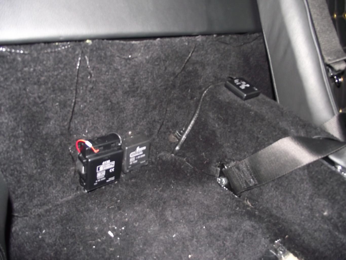

Well, it didn't take 6 week's for the dvla to process the paperwork, they did it in 4 days only! The v5 registration document arrived yesterday, the car is now fully uk road legal. I have to say, I am pretty impressed with how quickly the dvla turned this around. Meantime, I am having a Thatcham 1 alarm/immobiliser being installed as the insurance have stipulated this requirement.

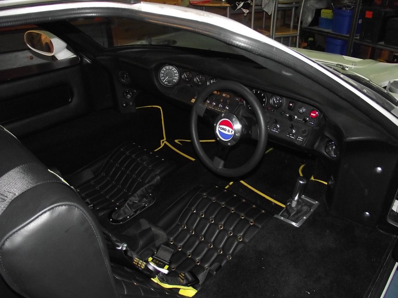

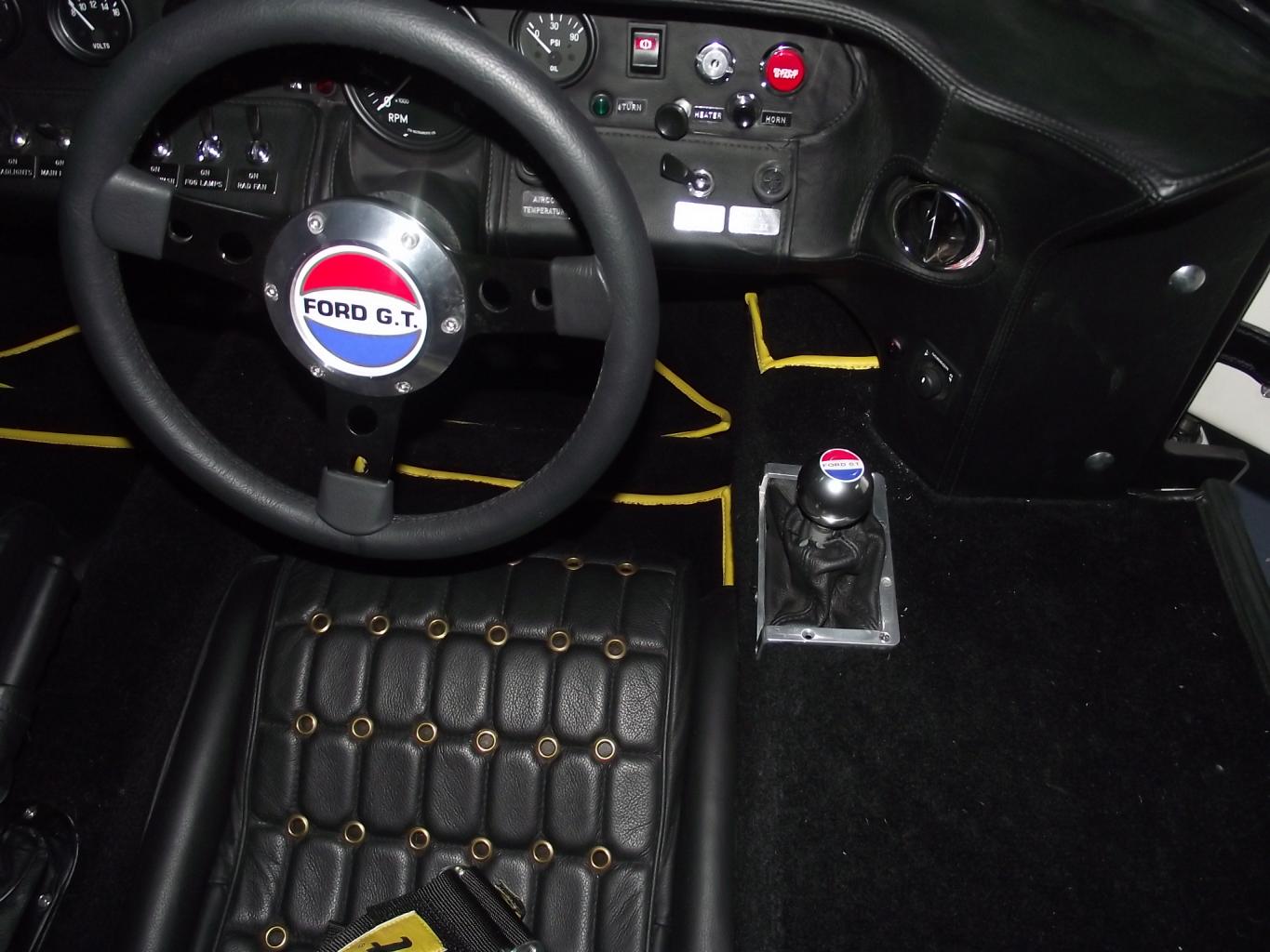

A Cobra alarm/immobiliser was fitted today with a microwave sensor. I also changed out the old gear know with a new Ford GT one which is a bit more in keeping with the steering wheel.
Irvin, the panels are cut to suit, folded, drilled out for the rivets, and then are glued and riveted in place.
