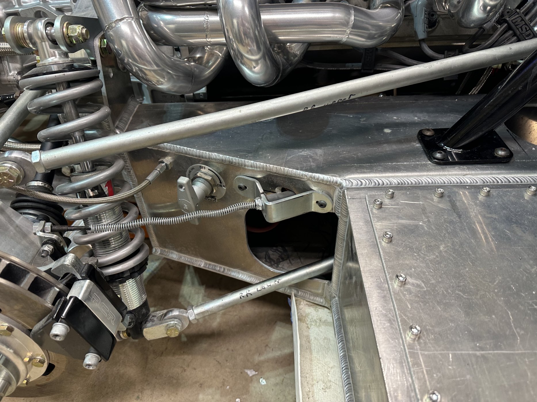

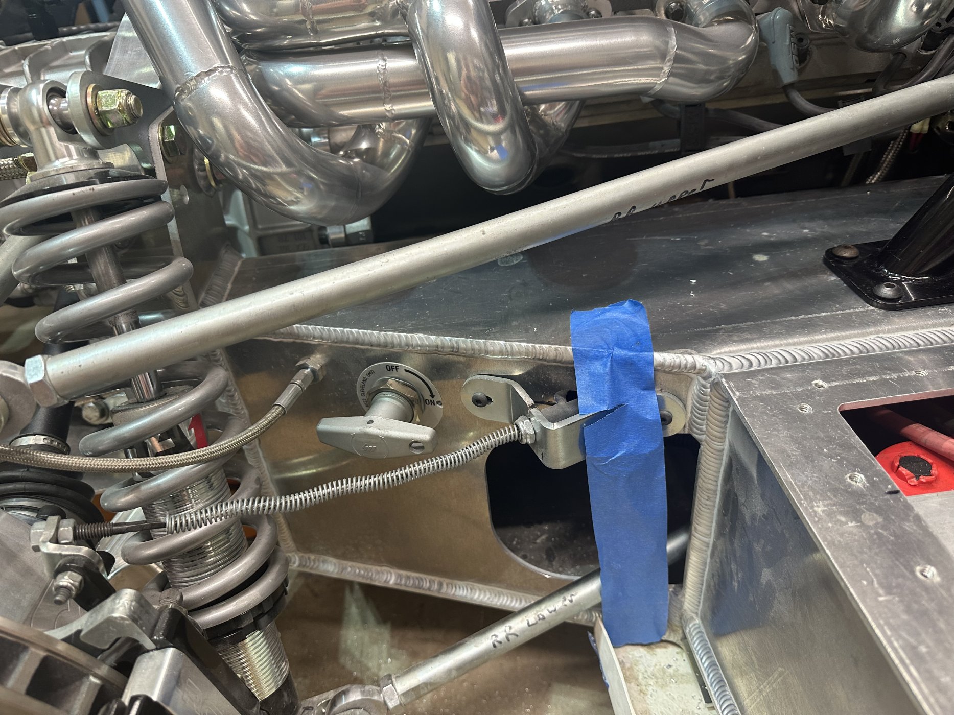

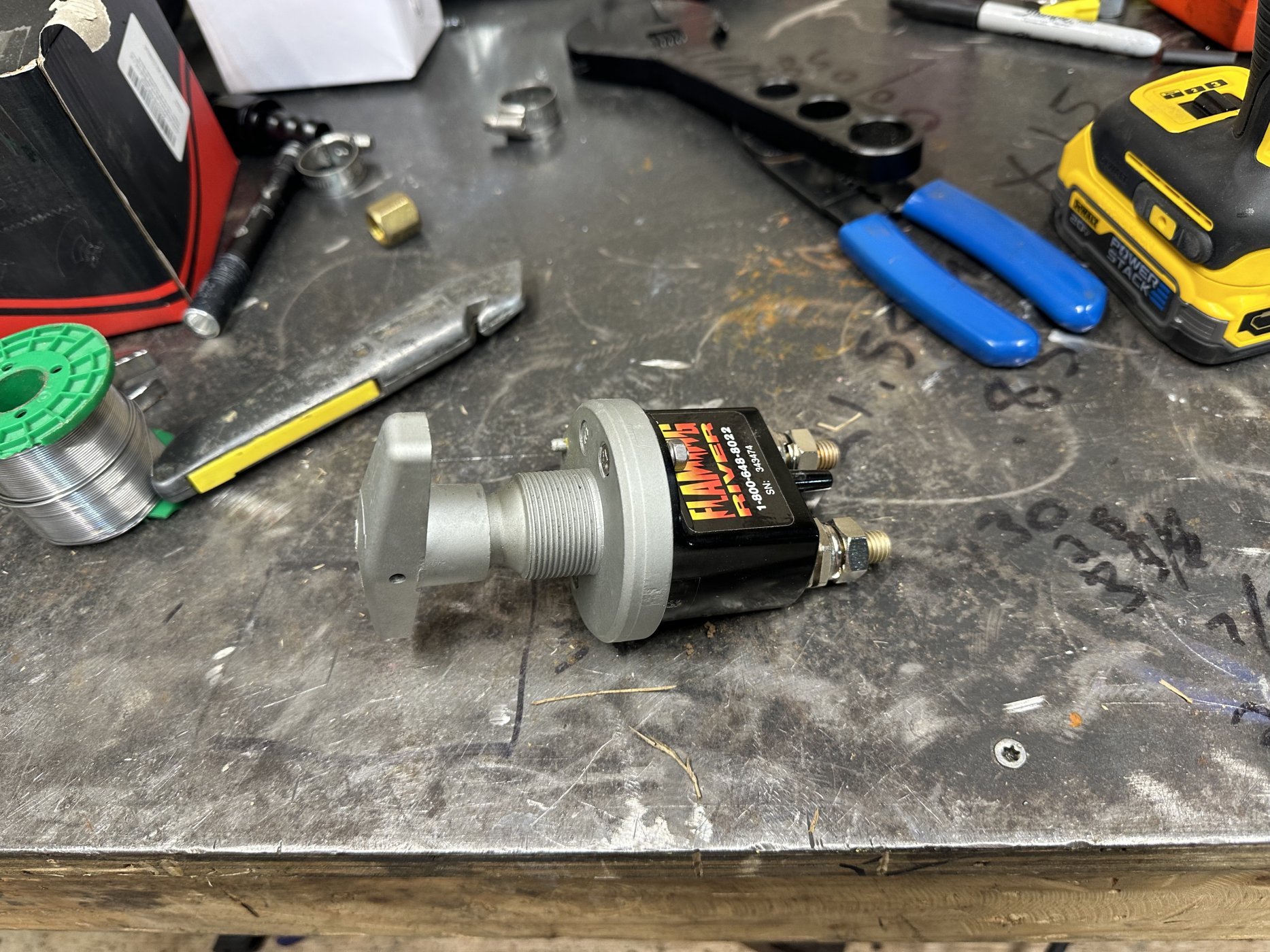

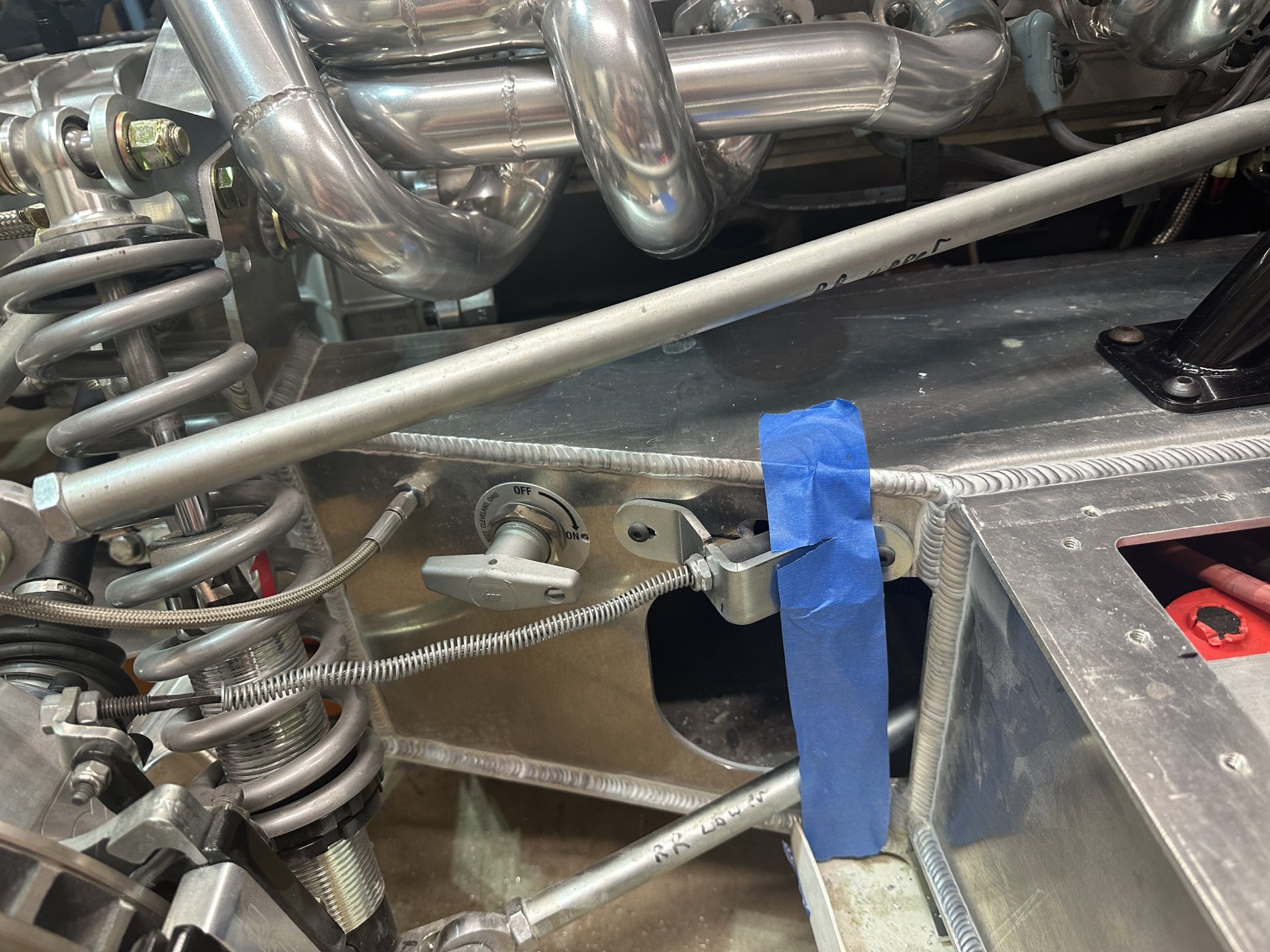

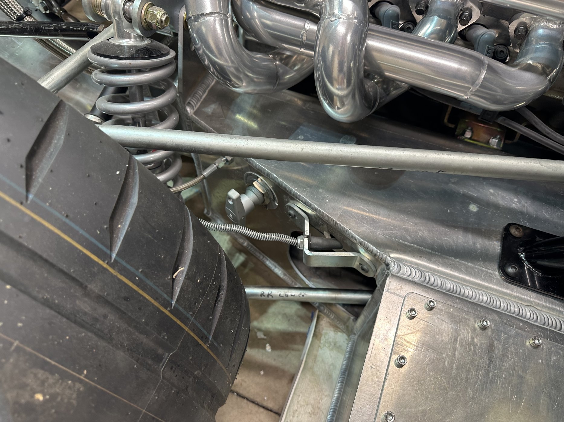

I mounted a battery kill switch on the chassis in front of the rear tire. I think it came out looking pretty good and keeps the wires hidden. Available space is definitely becoming scarce on this chassis.

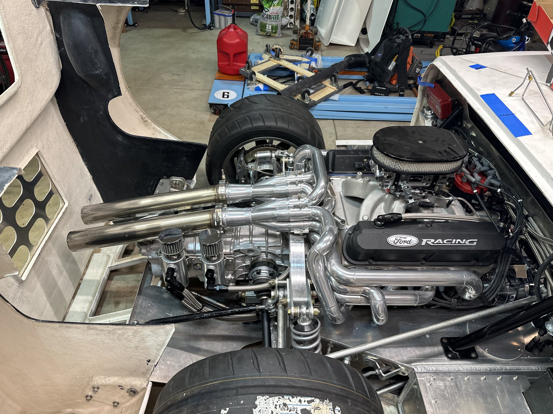

I tested the fuel tanks… found I left a couple lines loose, but other than that the fuel system seems to work great.
I also got the rear axles installed.

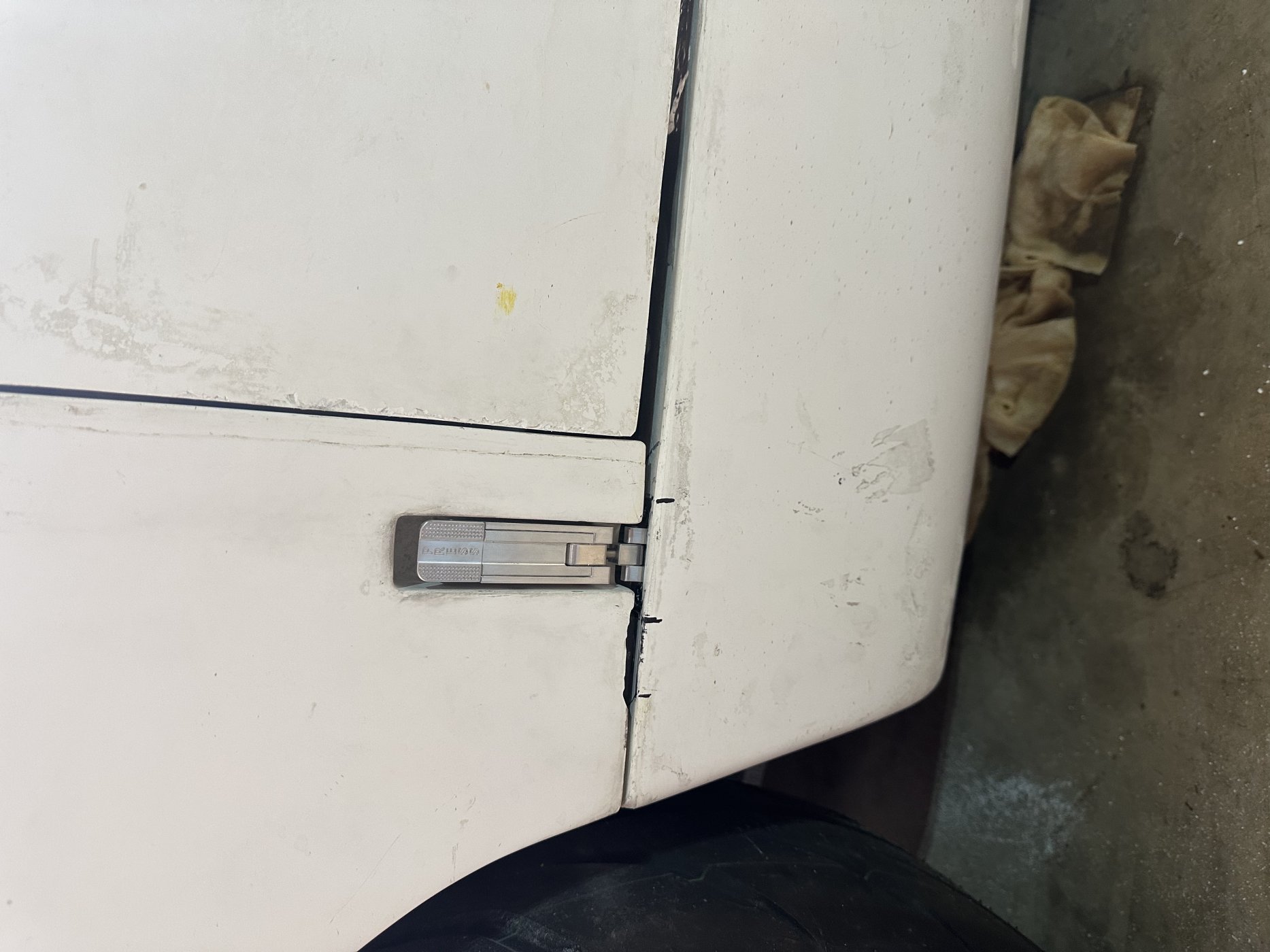

I’m hoping to go for a test drive the next time I’m home. I just need to bleed brake and slave cylinder lines, then finish installing the Hartwell latches to make it happen. :cool:

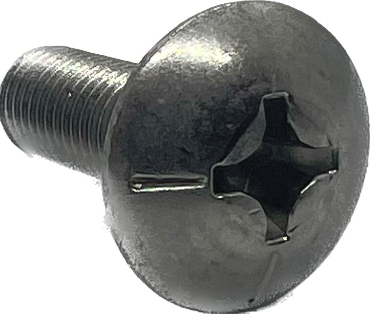

You might consider replacing the socket head cap screws holding the panel in place with AN-526 or even AN-525 button head machine screws. It is a matter of personal taste, though.
Neil
Hi Neal,
I actually tried butten head cap screws and didnt like the look, I found the socket heads looked a bit cooler.Although that might change once I have all the panels finished.
Sean
Either one works just fine; it only a matter of preference. :) You might put a flat washer under each of the socket head cap screws- the usual practice.
