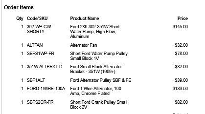

Hi Sean, What was the part number on the alternator and alternator bracket that you are using ? Thank you.
Sean Starkey
Hi Marian,
I ordered everything through CVF. Part numbers below.
Sean
Hi Marian,
Sean
Thank you very much !!!! big help for me.

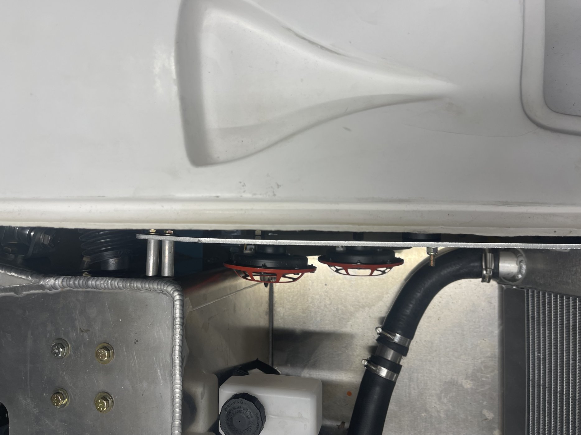

Sean Starkey

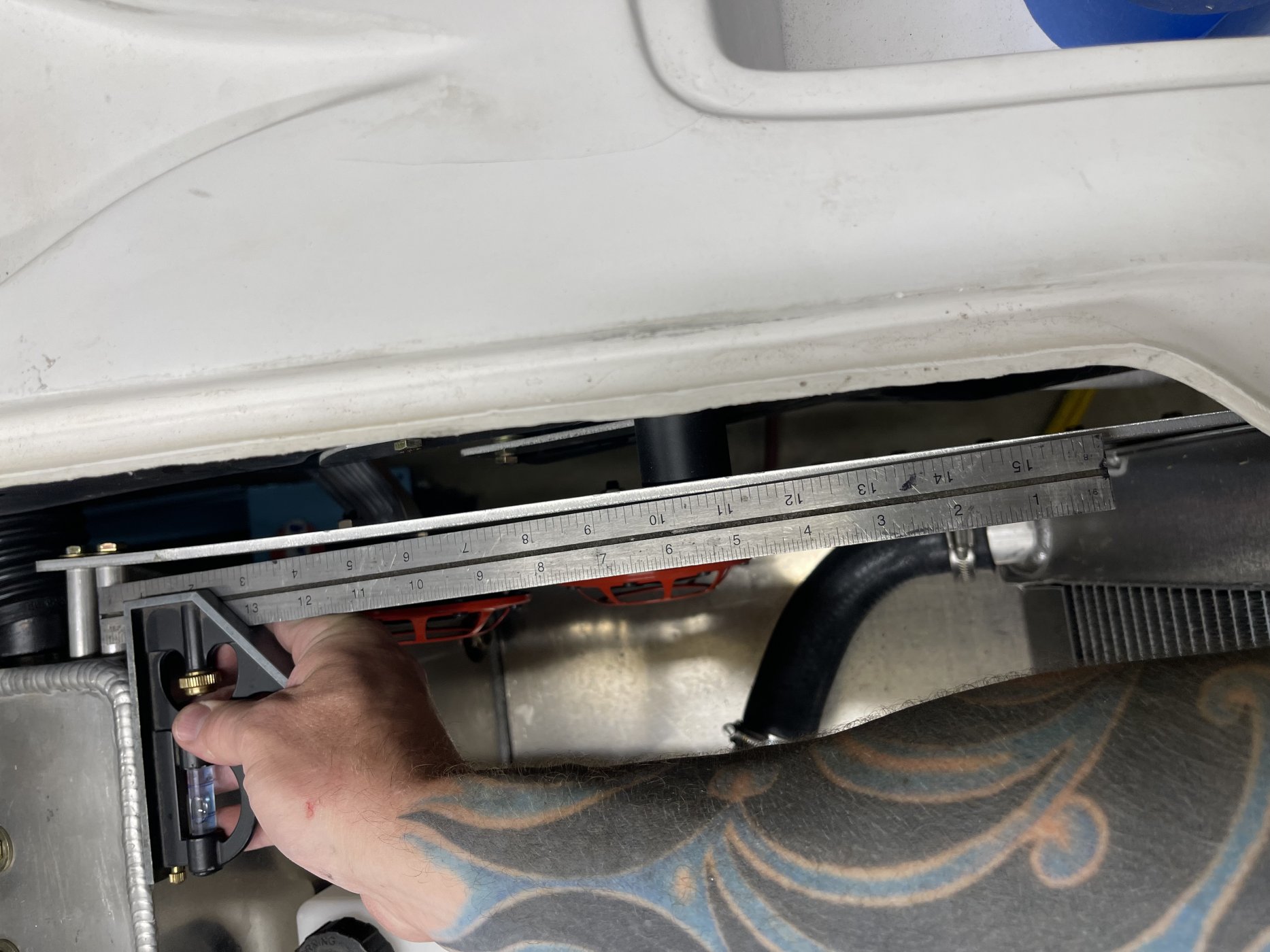

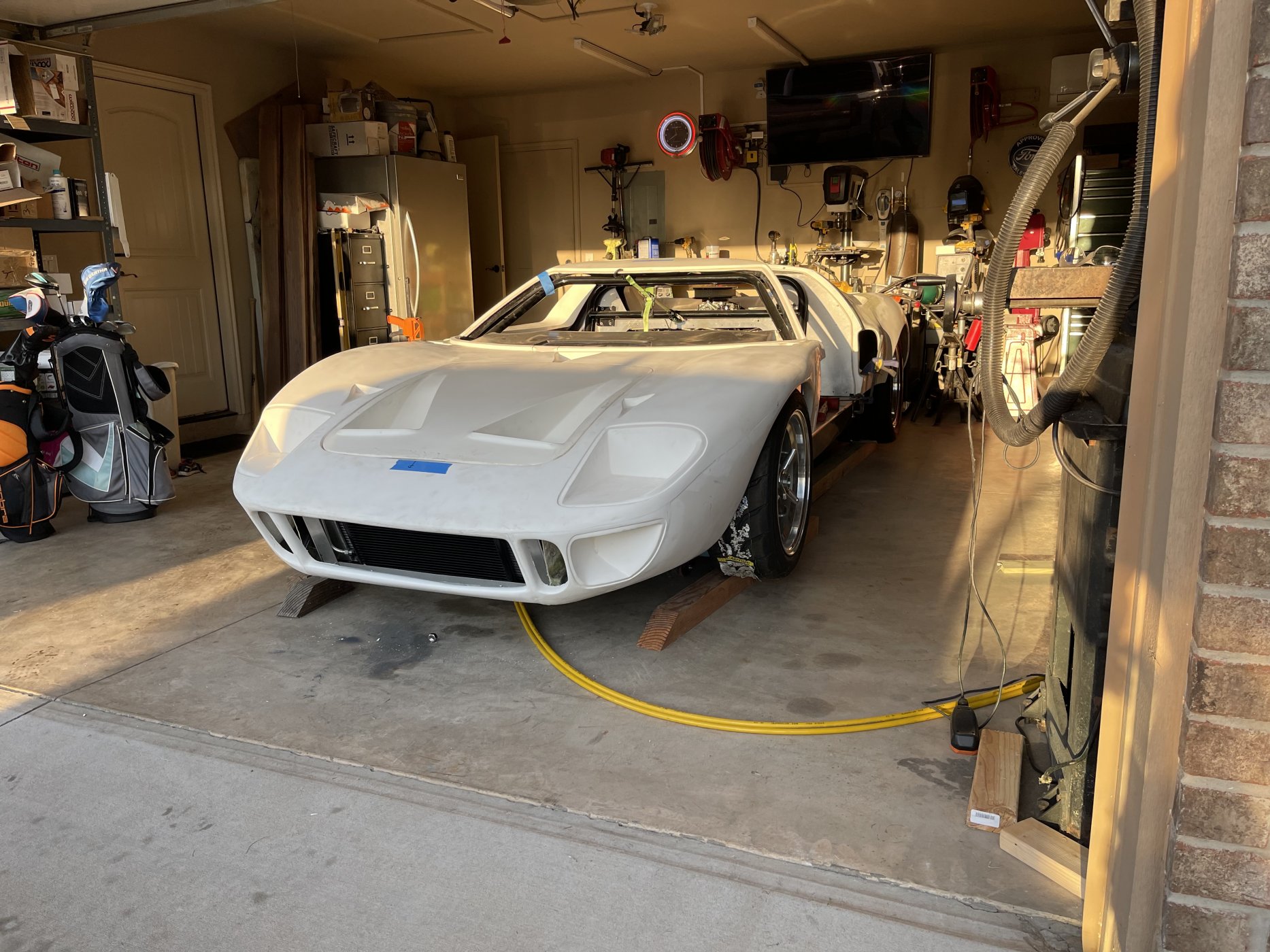

I took some time away from the car the last month and a half, but now its time to get some things done. I am moving forward with body fitment now. I am starting at the nose of the car and working my way back. I found that the radiator mount was twisted a bit and needed to be sorted out before moving forward. I ended up slotting a couple holes where it mounts to the chassis to get everything to line out square.

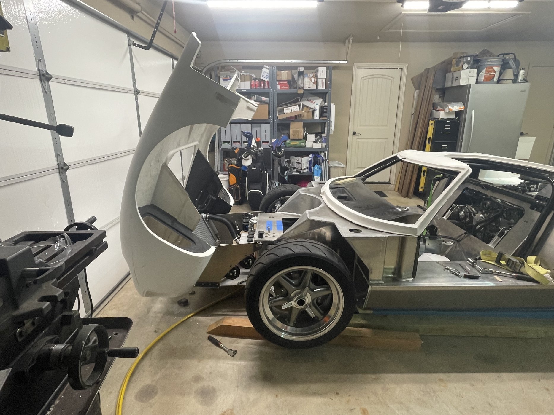

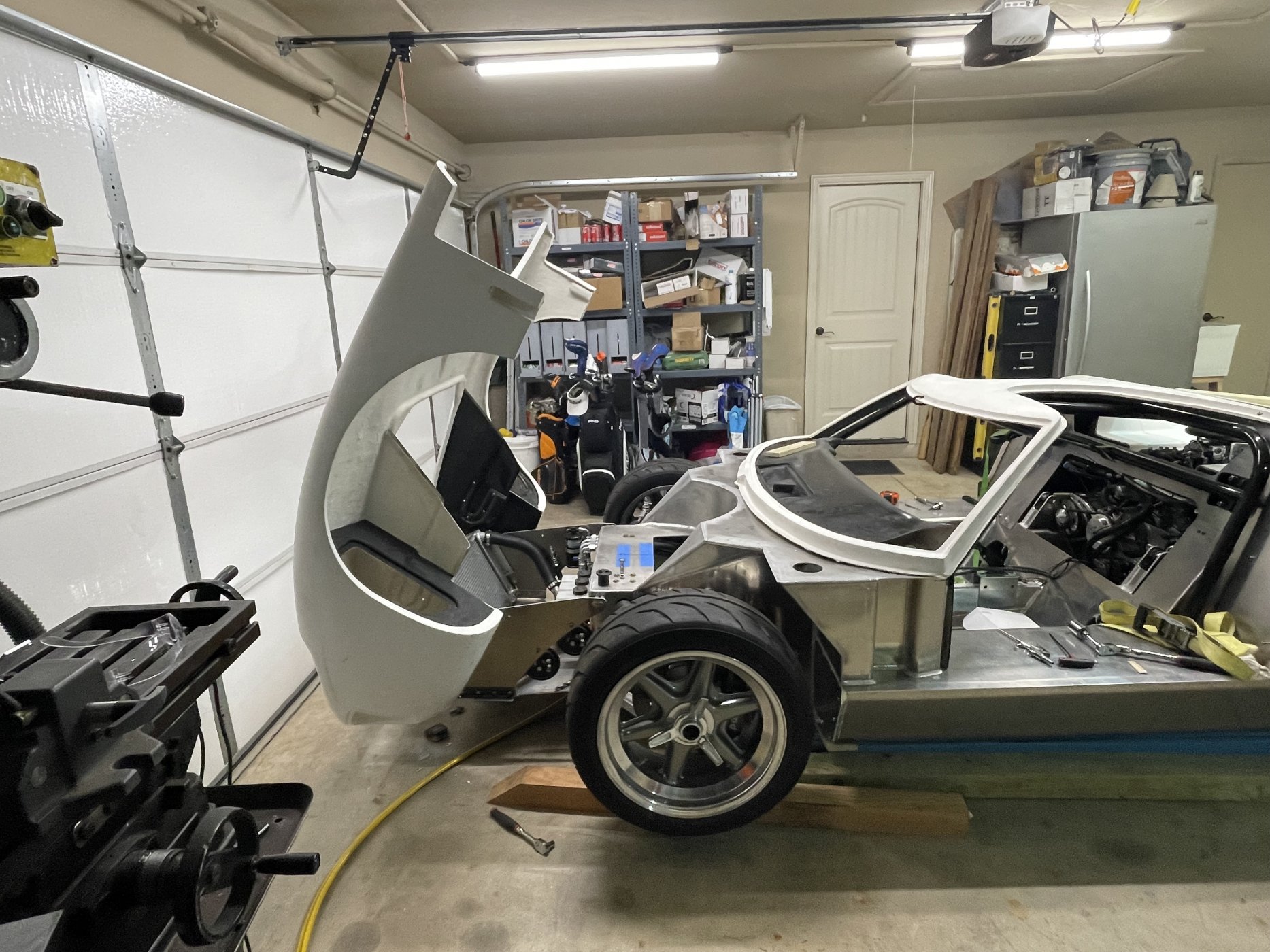

Sean Starkey

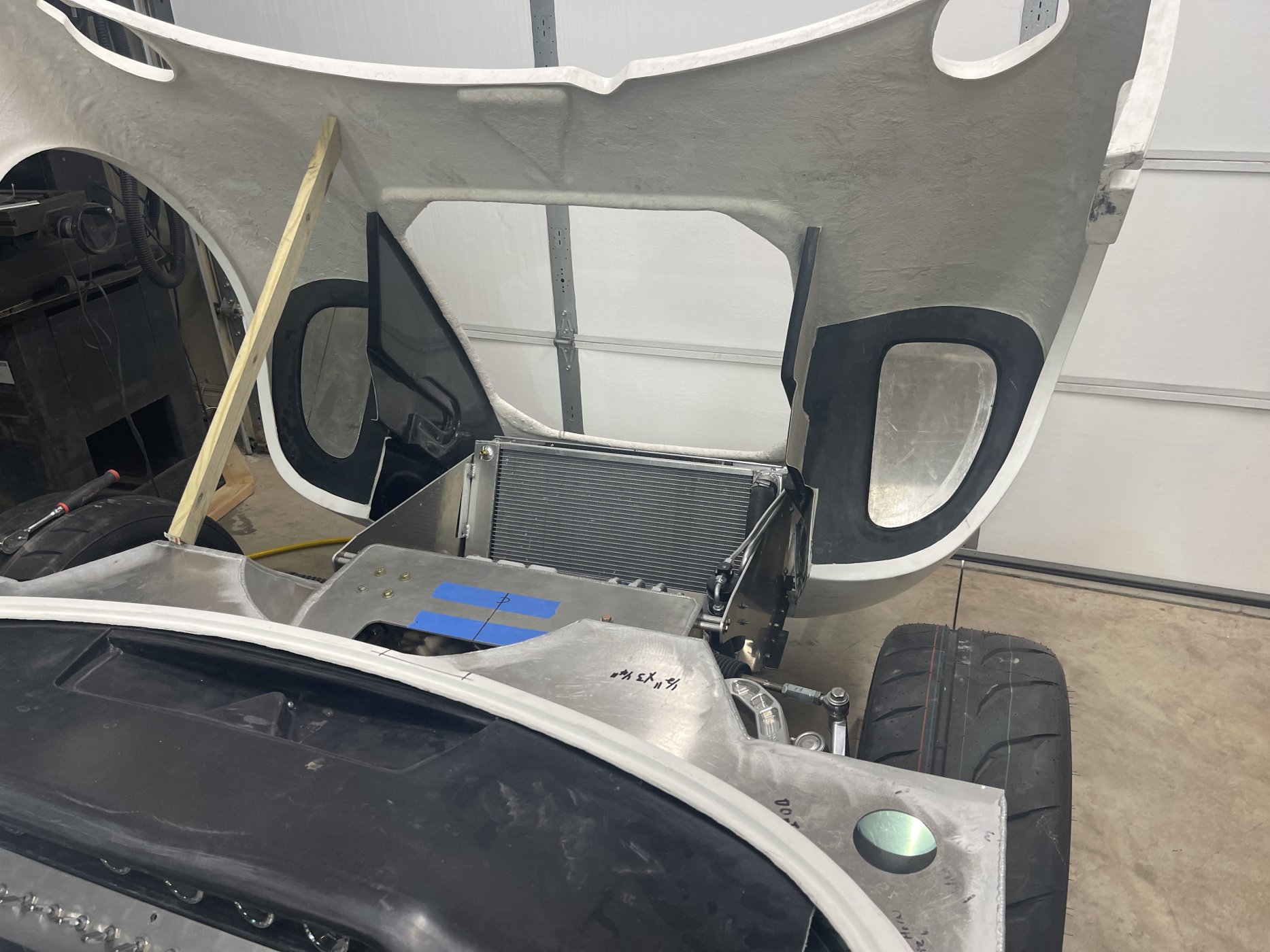

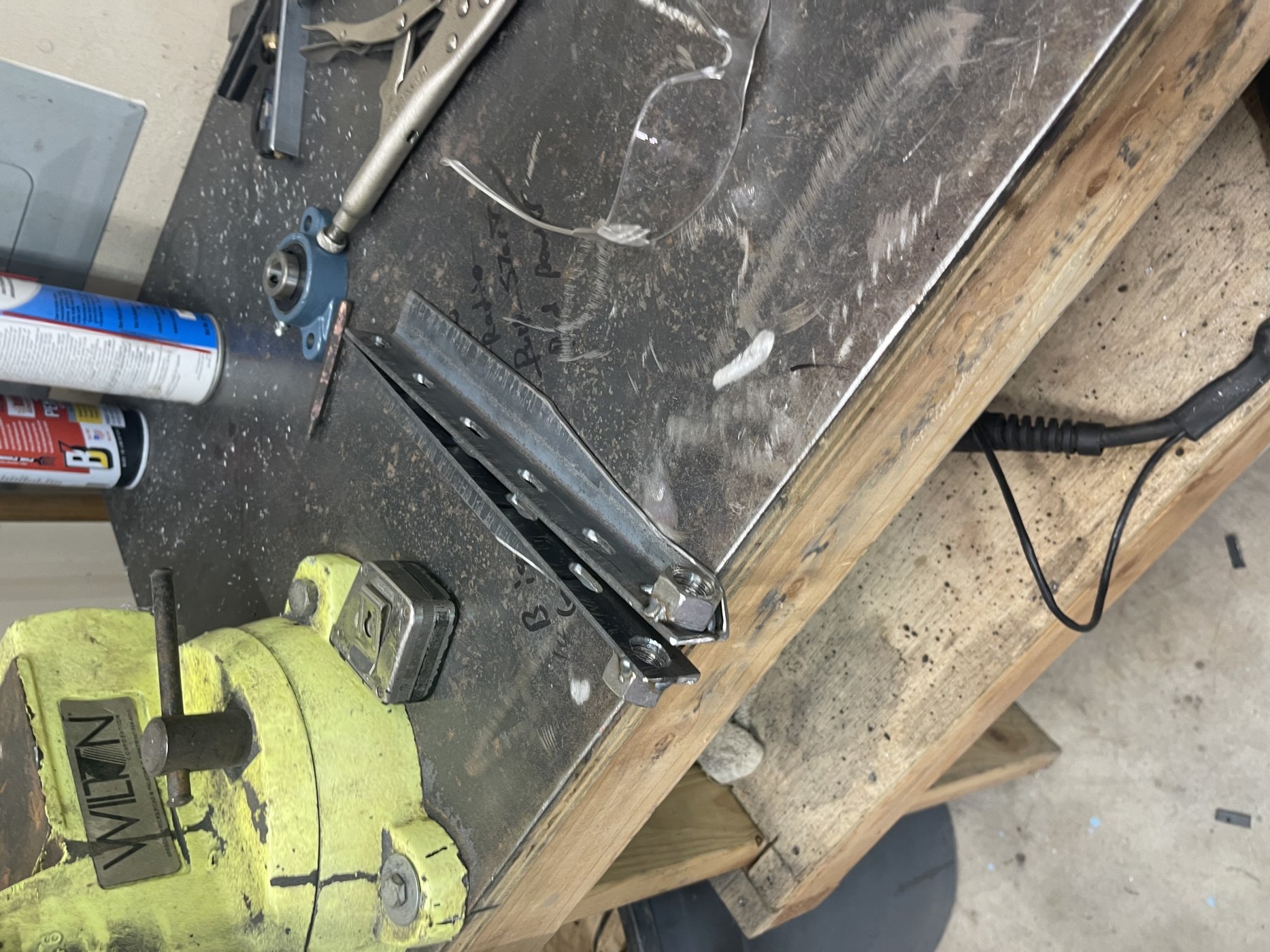

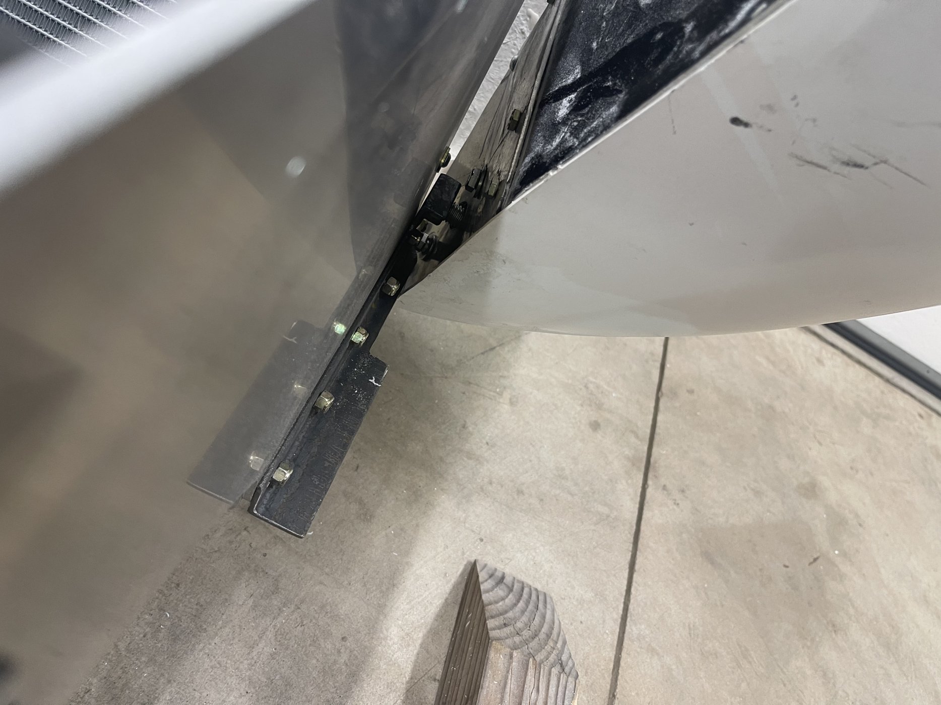

Once the front was squared off, I started fabrication some hinge brackets for a flip nose. After a couple tries, I now have a hinge design that works well. I still need to stiffen up where it will mount to the fiberglass on the nose, once completed I will post some details of the brackets. I will also need to research some gas struts to hold the hood up.
Next I moved to the rear of the car to get the clamshell centered and hinges mounted, all the lines are matching up pretty well thus far. I still need to make some brackets for the rear hinges to mount to the fiberglass, I am hoping to have those completed this week.

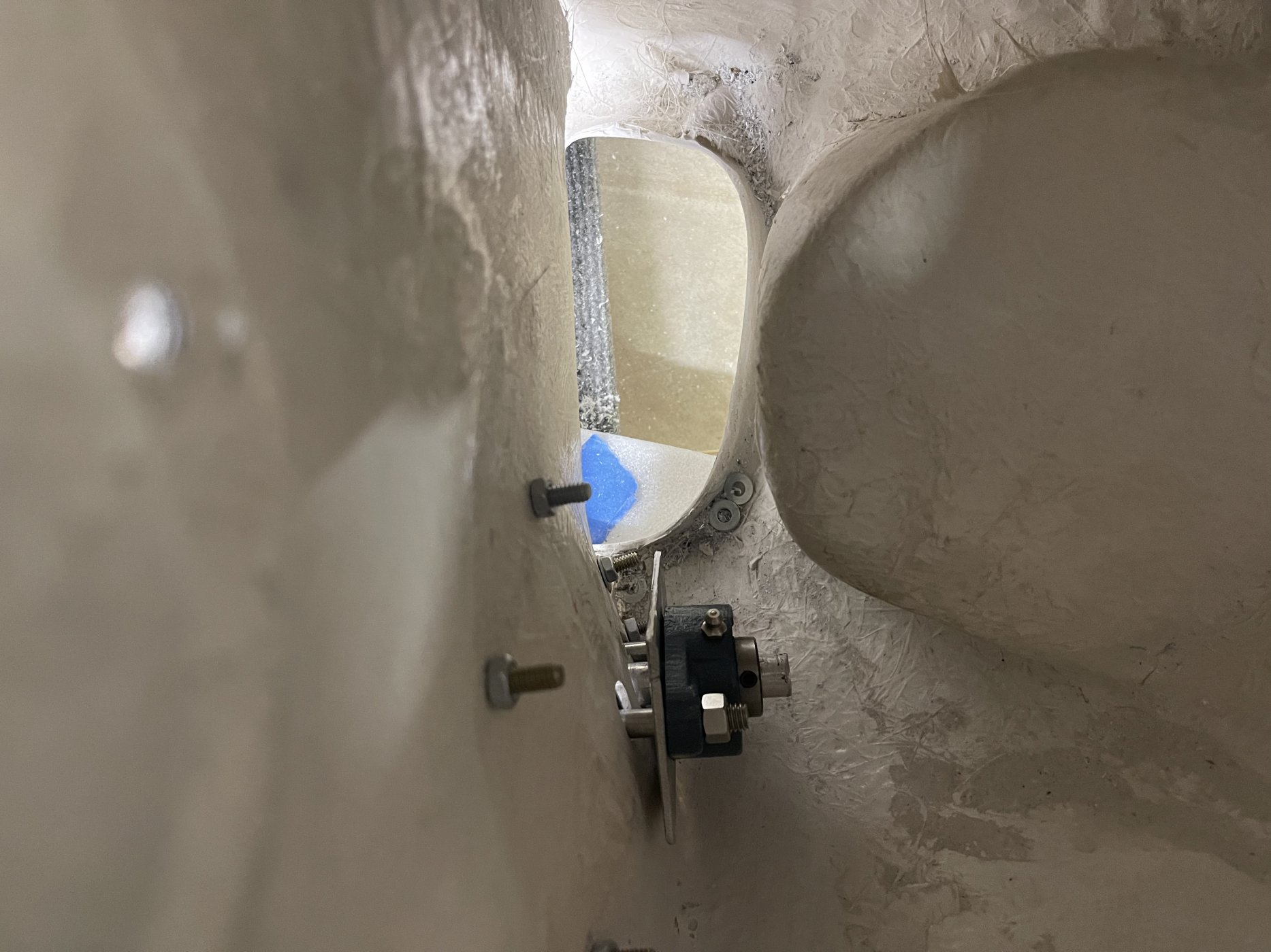

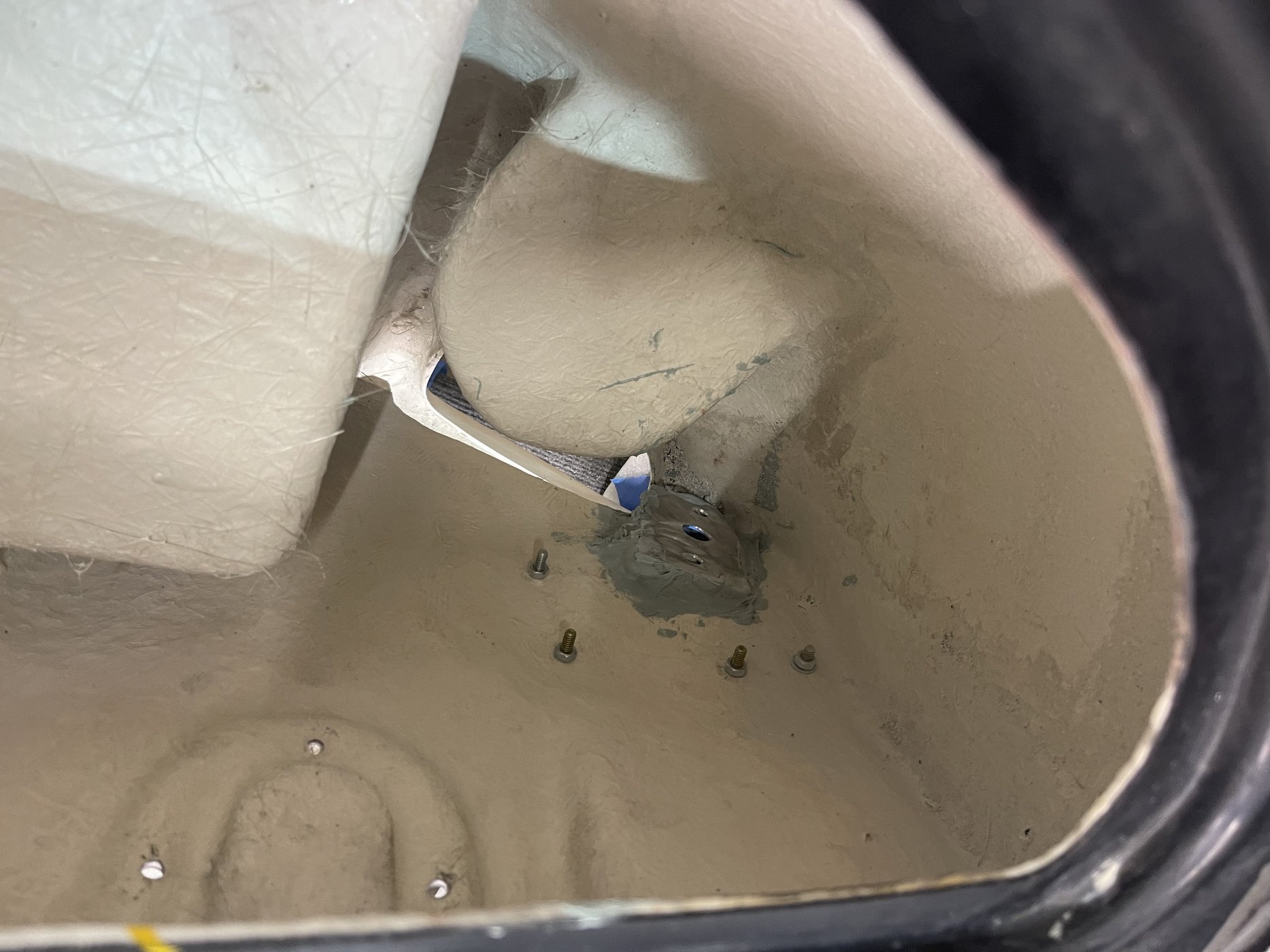

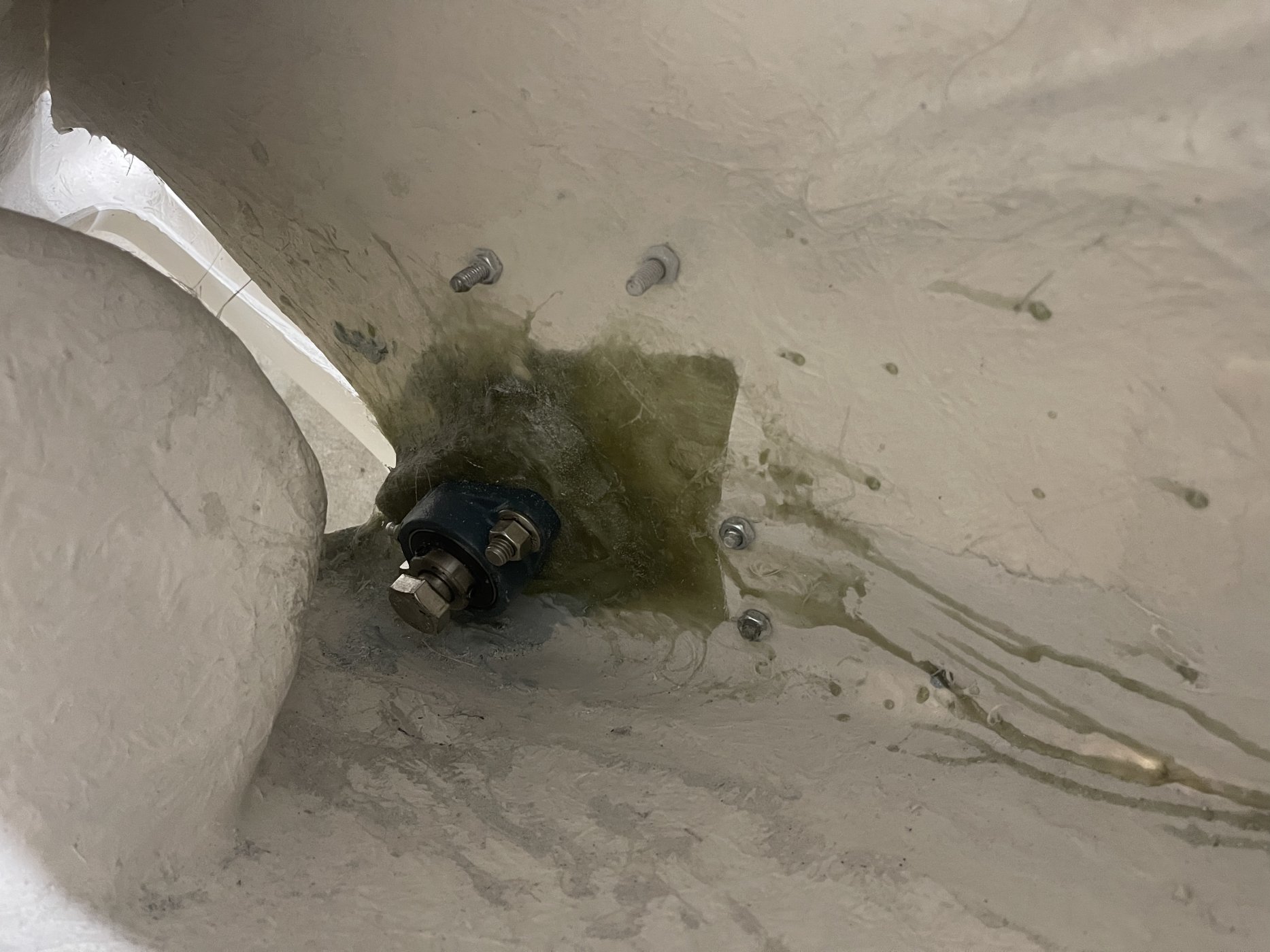

The hinges worked out very well. It is a bit overkill, but I decided to use pillow blocks for the hinge point. I needed to make where the bearings mount level to add strength. I did this by adding an aluminum plate with body filler under it. Then glasses over the whole mount. This made the front mounting point very solid on the car, and it allows the nose to lift very smoothly. I still need to add shims for side to side adjustments on the nose.

One suggestion- round off the sharp corners of the angle. Sharp corners concentrate stress and will eventually cause stress cracks in your fiberglass. Round corners look good, too.
Thanks for the Feedback Neil,
I plan to round the back and make a bit of an angle towards the hinge pivot side the next time I take it off.

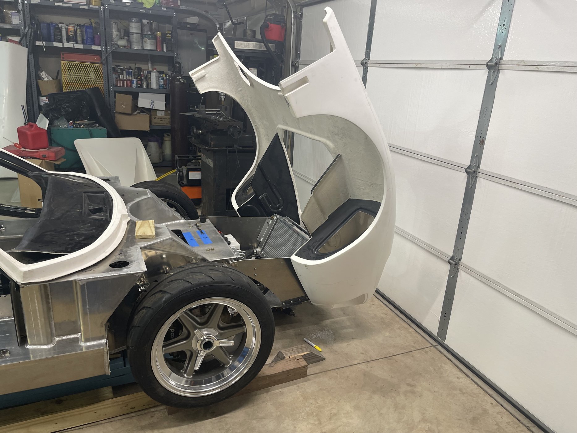

Sean Starkey
I found some gas shocks that work well. I was able to get them on Amazon. Link below for anyone else looking for them
BOXI 2pcs Rear Glass Window lift... https://www.amazon.com/dp/B01GH8TFH2?ref=ppx_pop_mob_ap_share.
A little more cleaning up and replacing with proper fasteners and the flip nose will be completed.

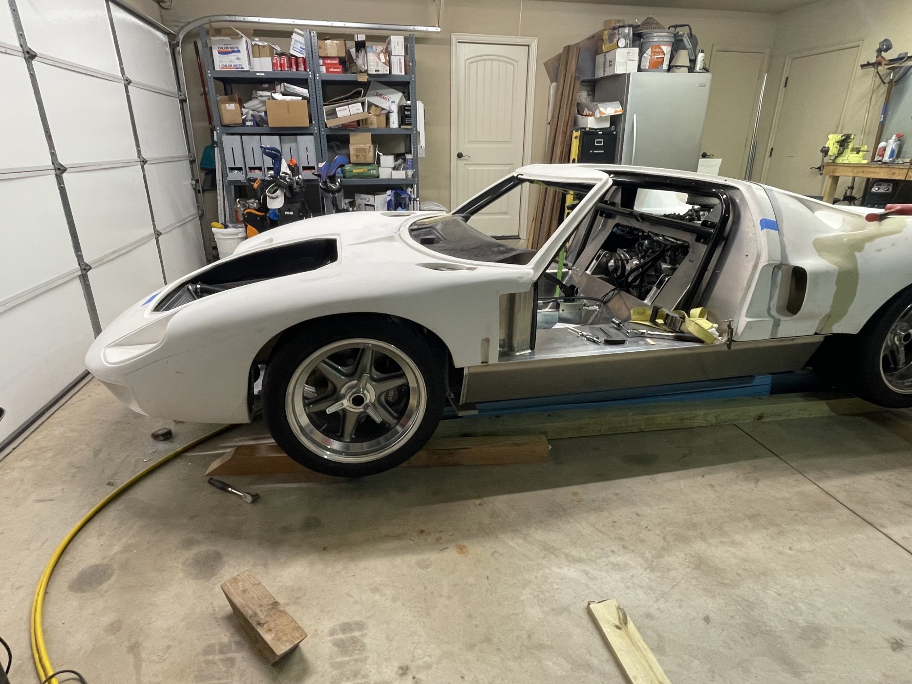

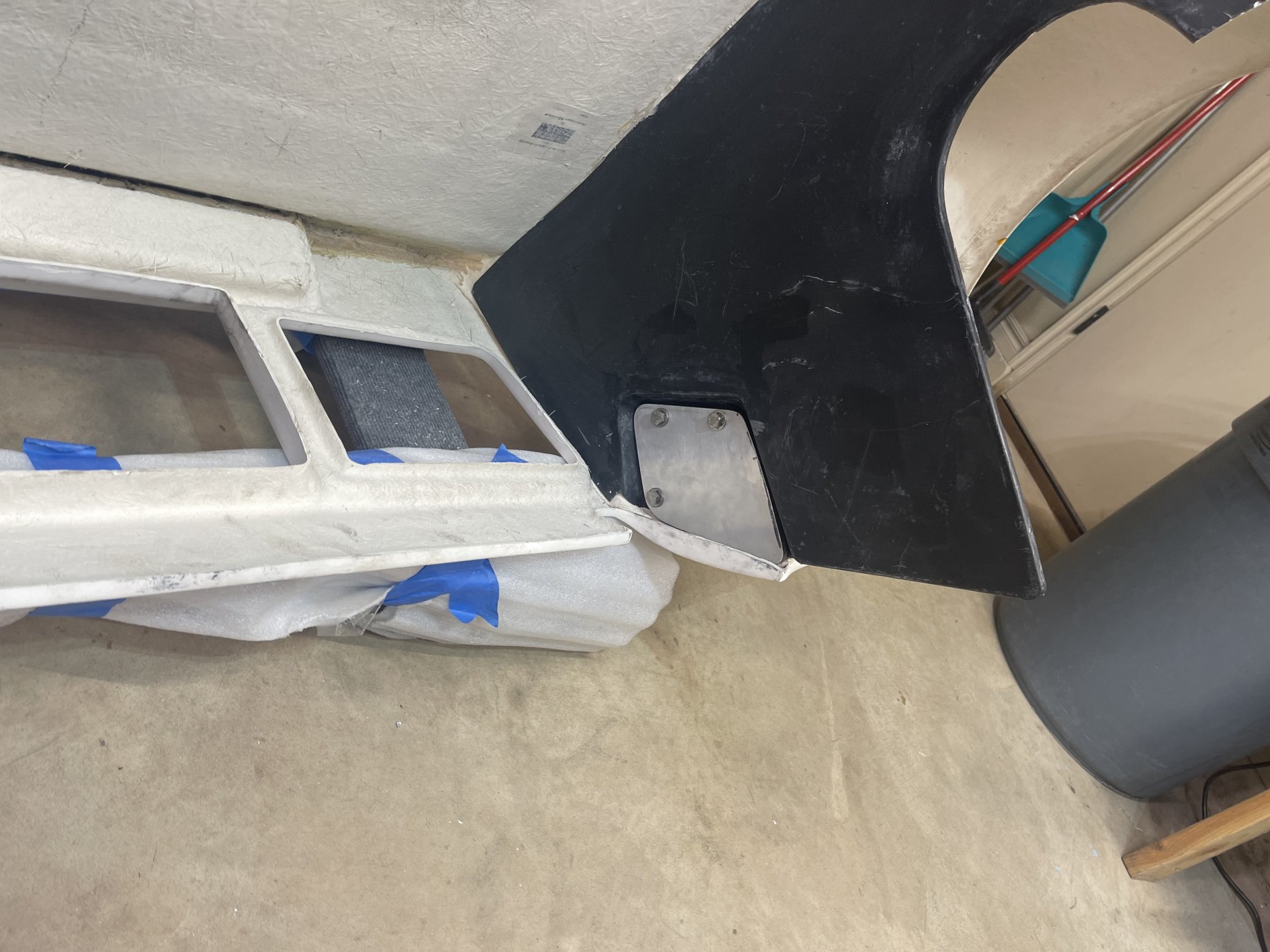

Sean Starkey

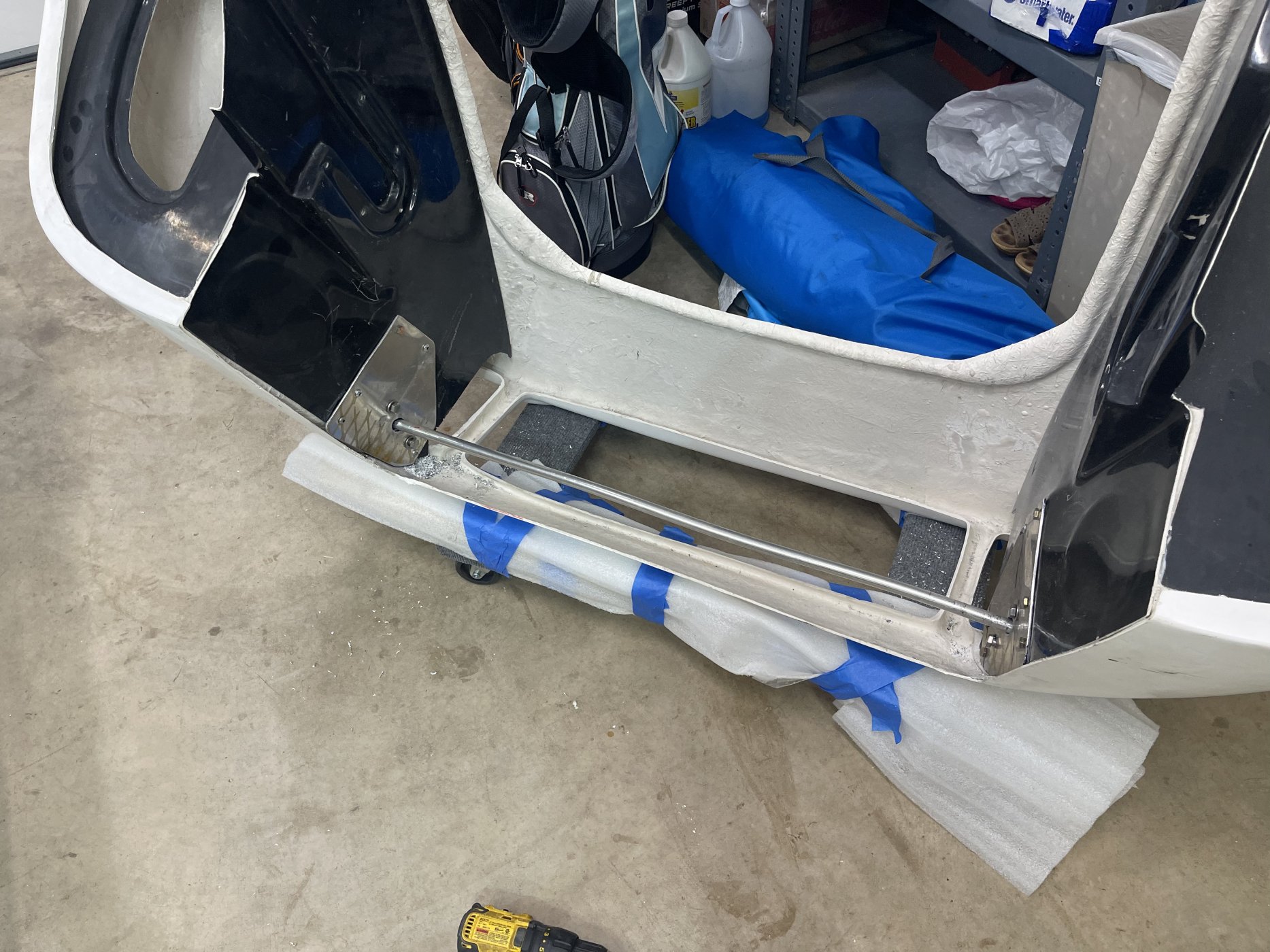

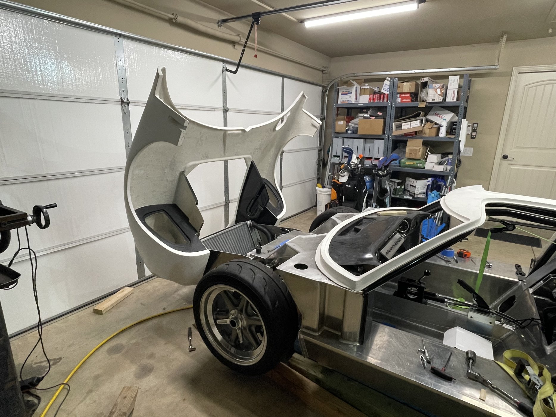

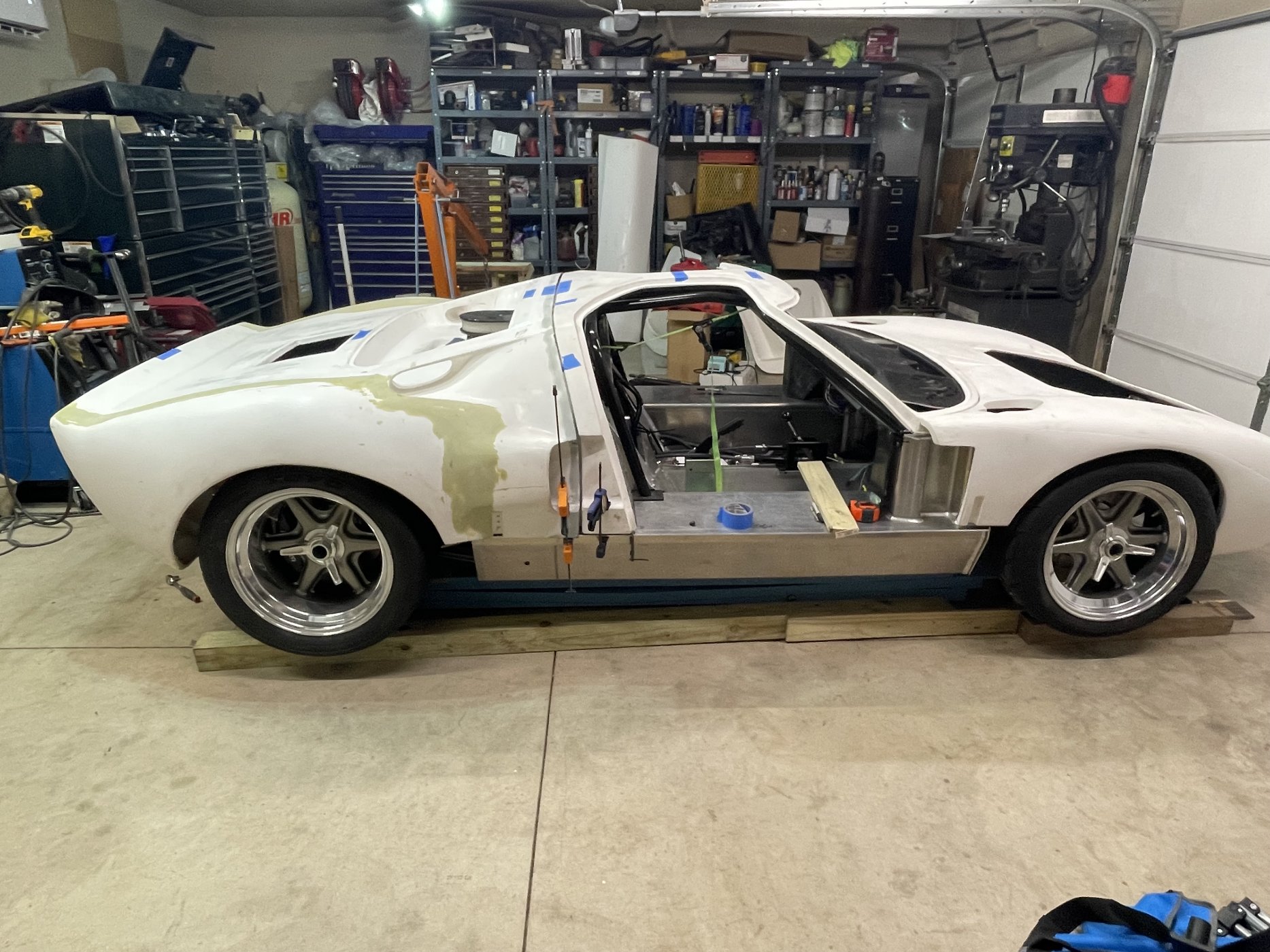

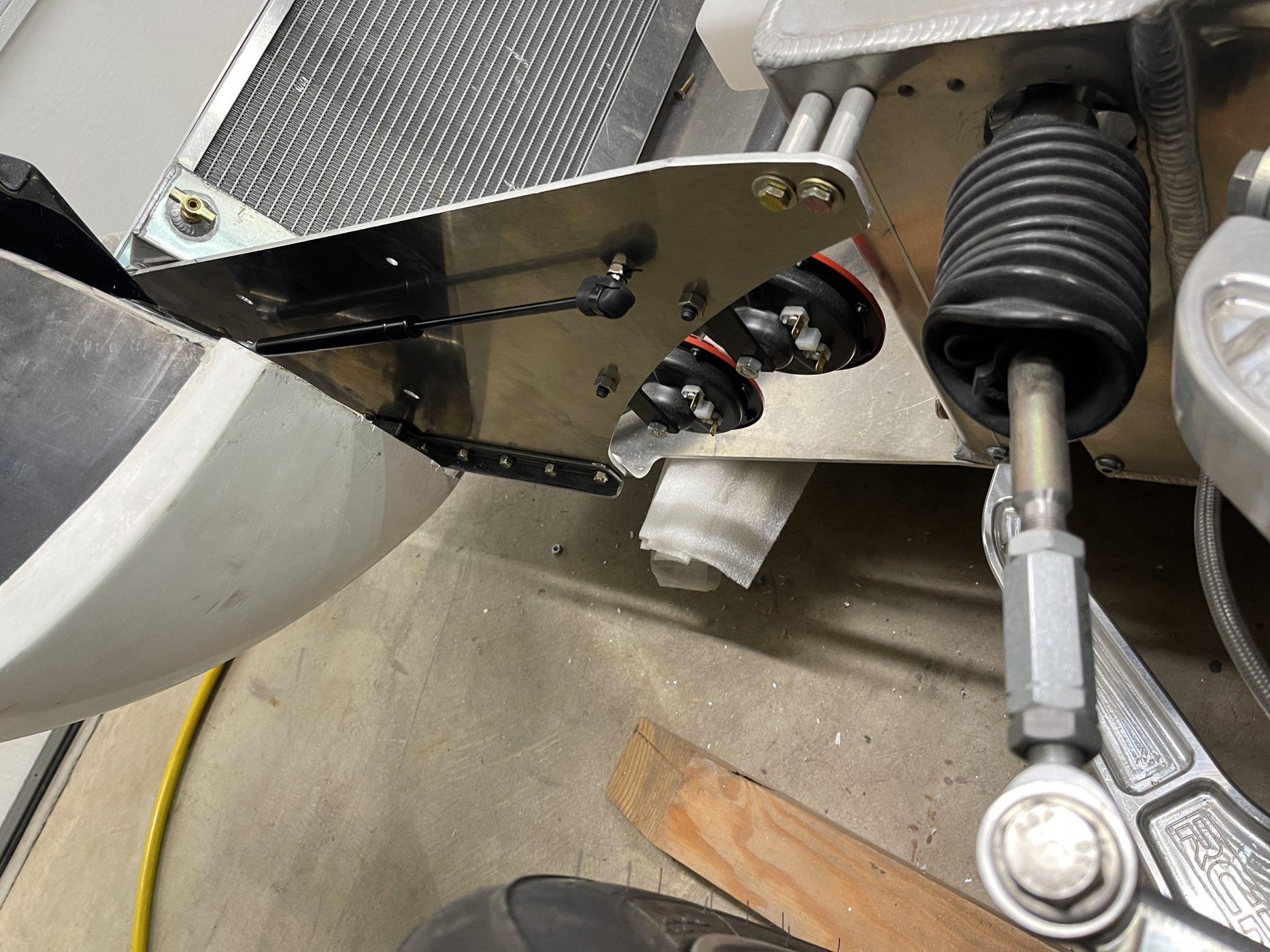

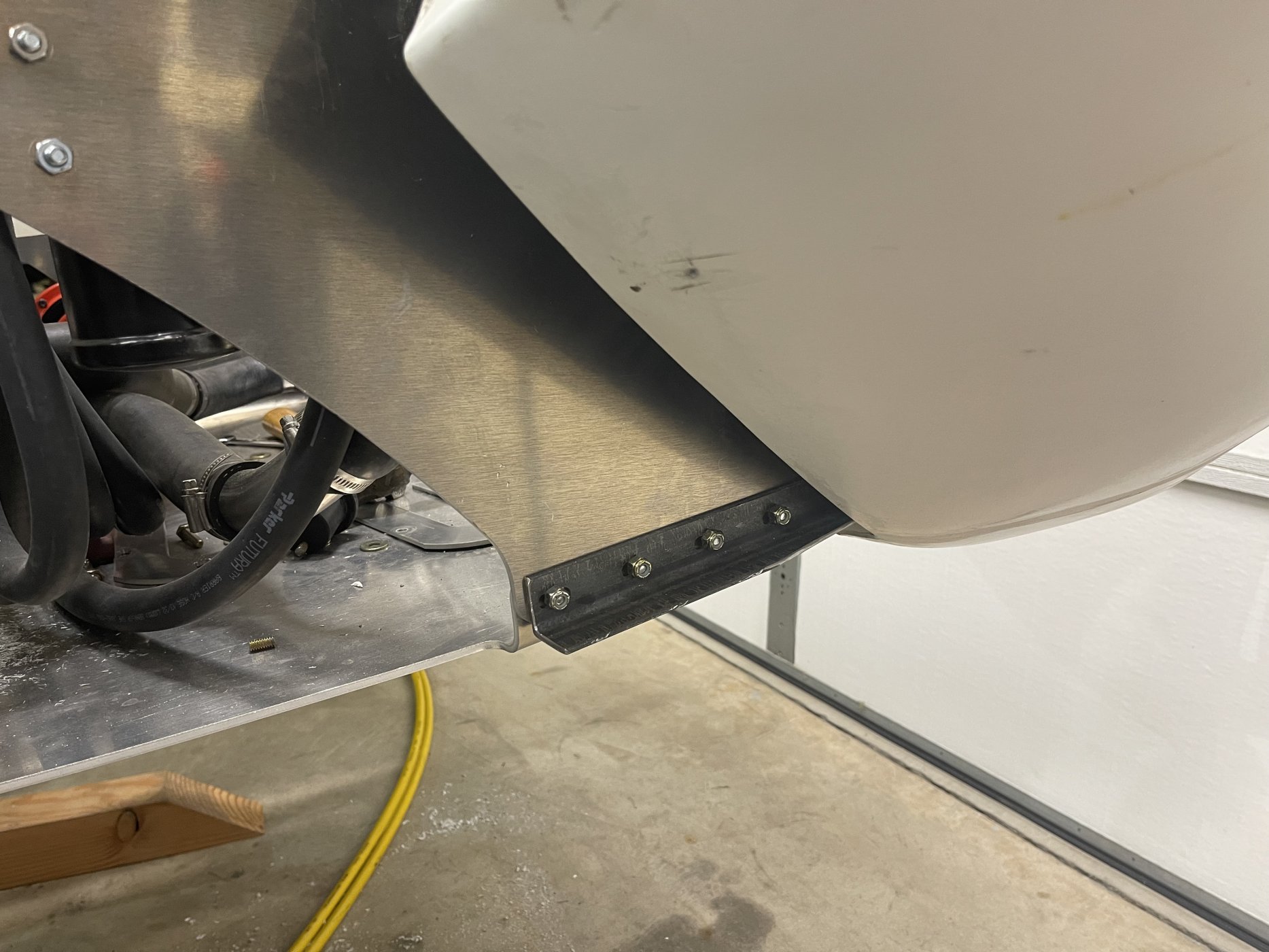

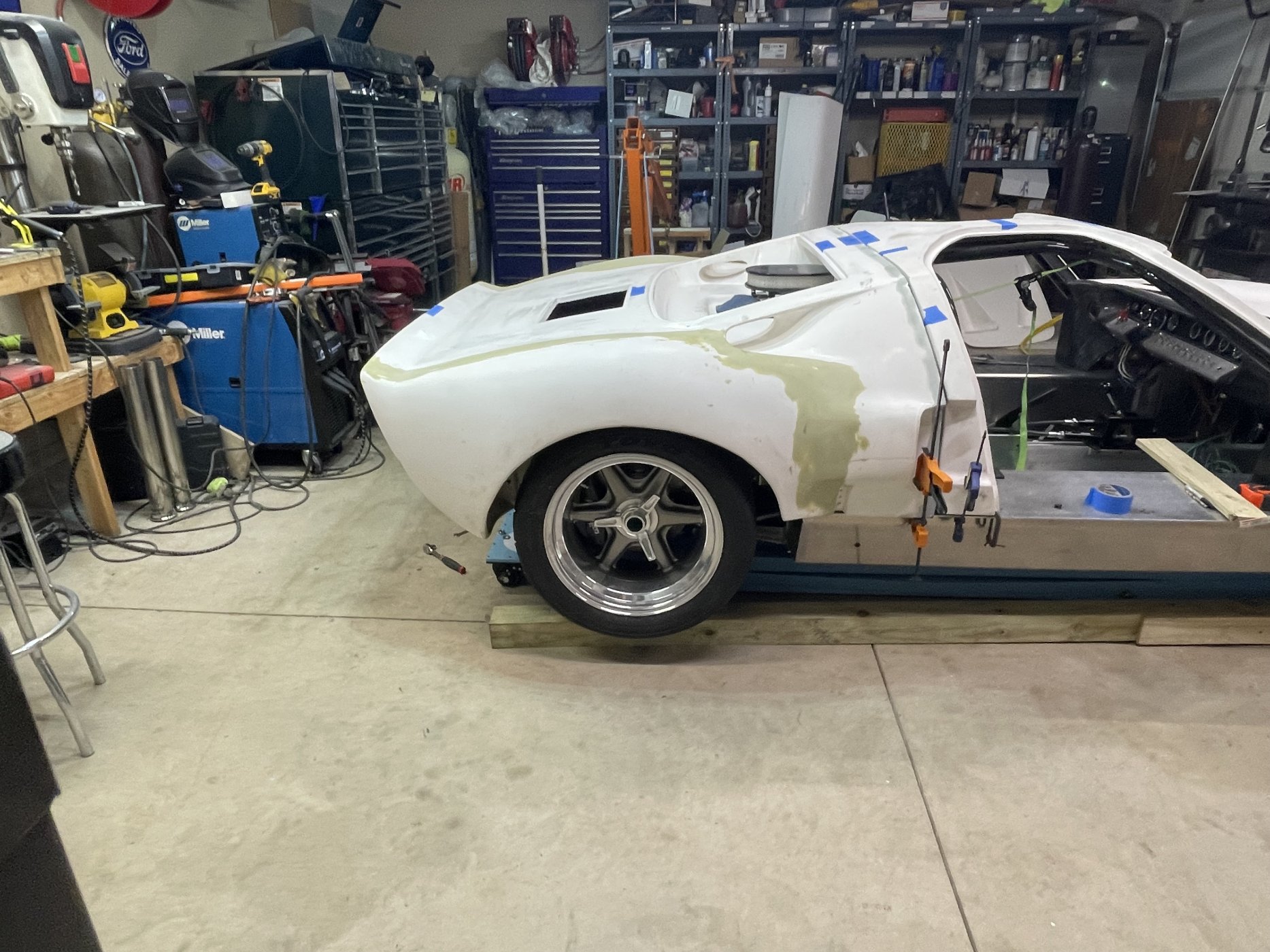

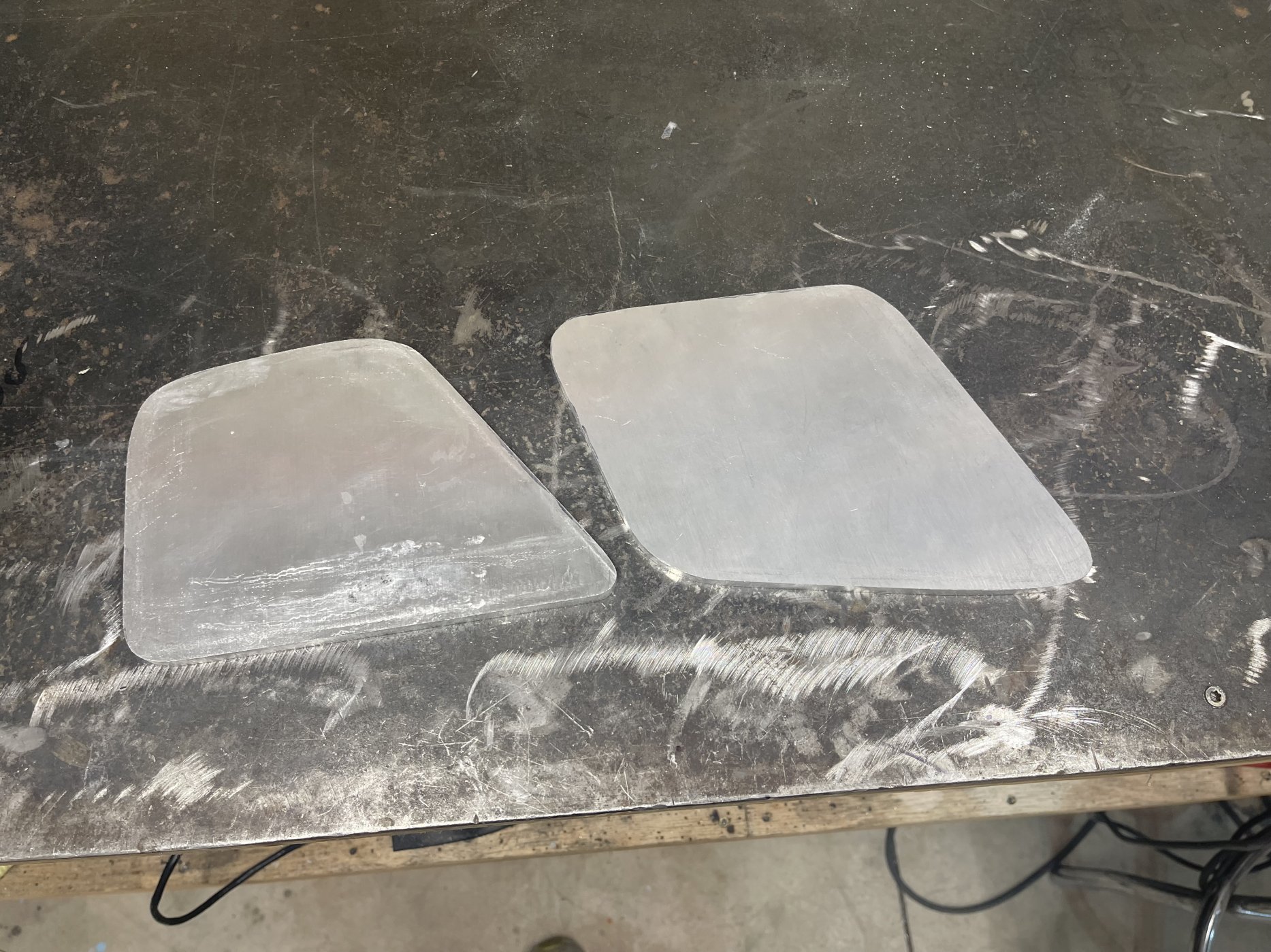

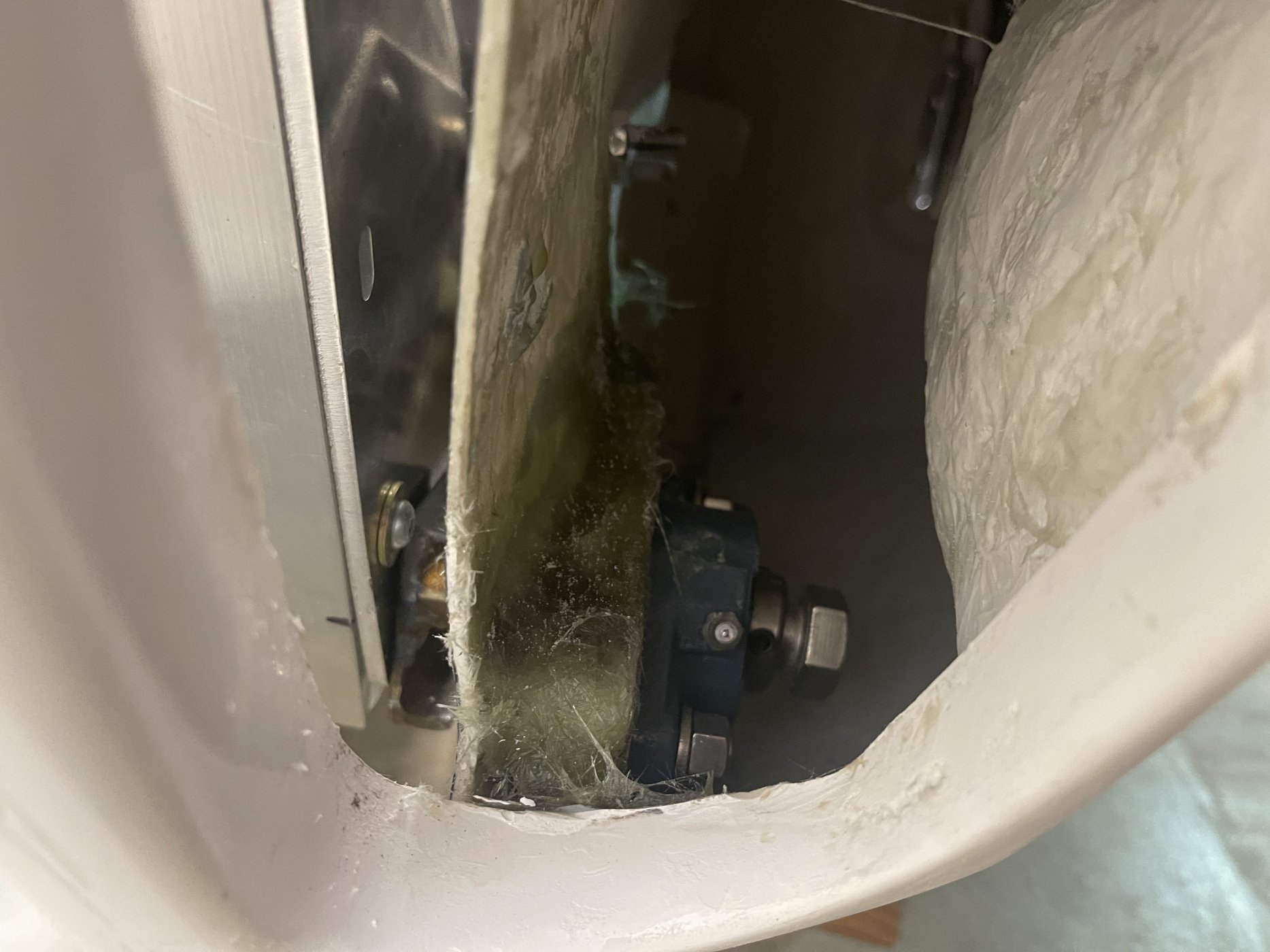

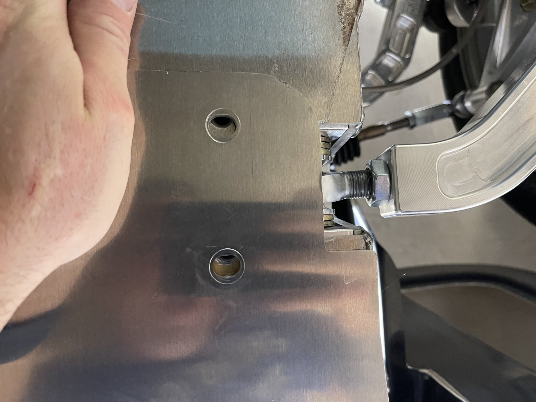

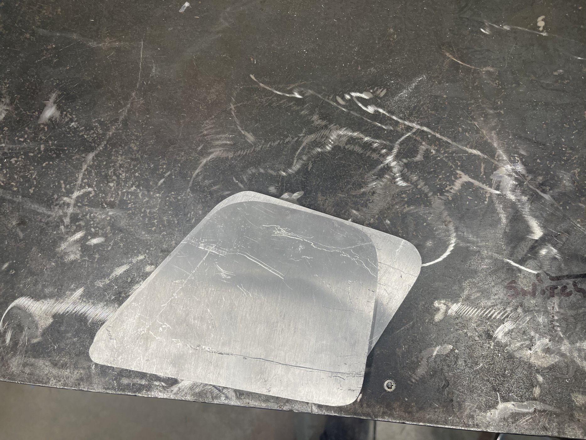

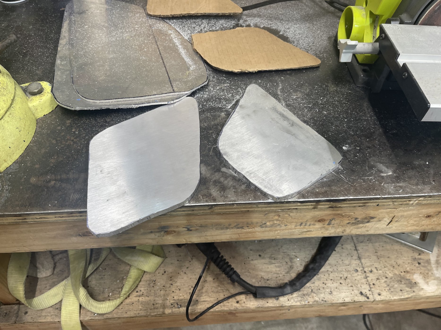

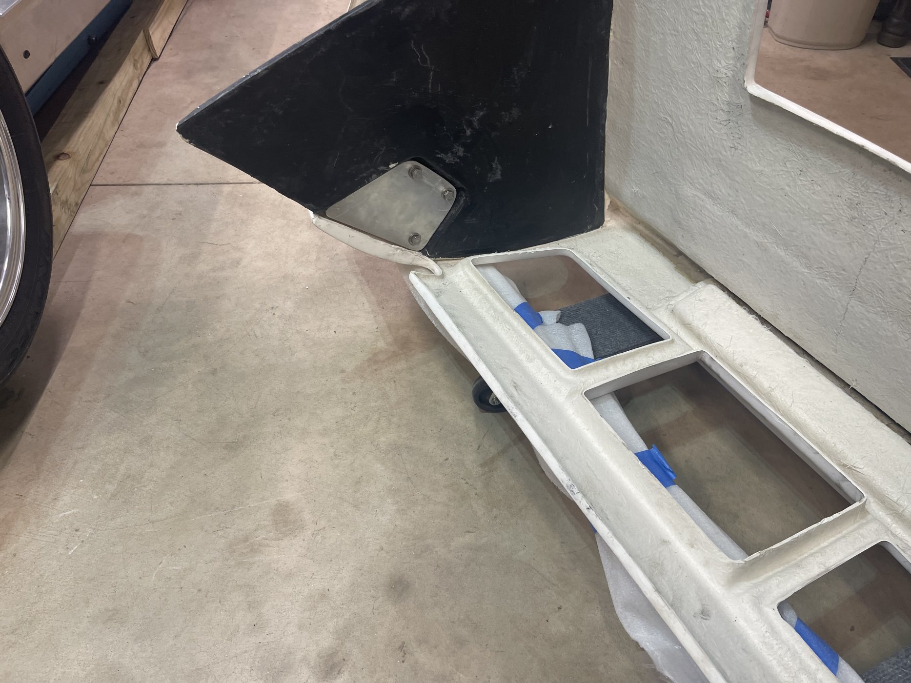

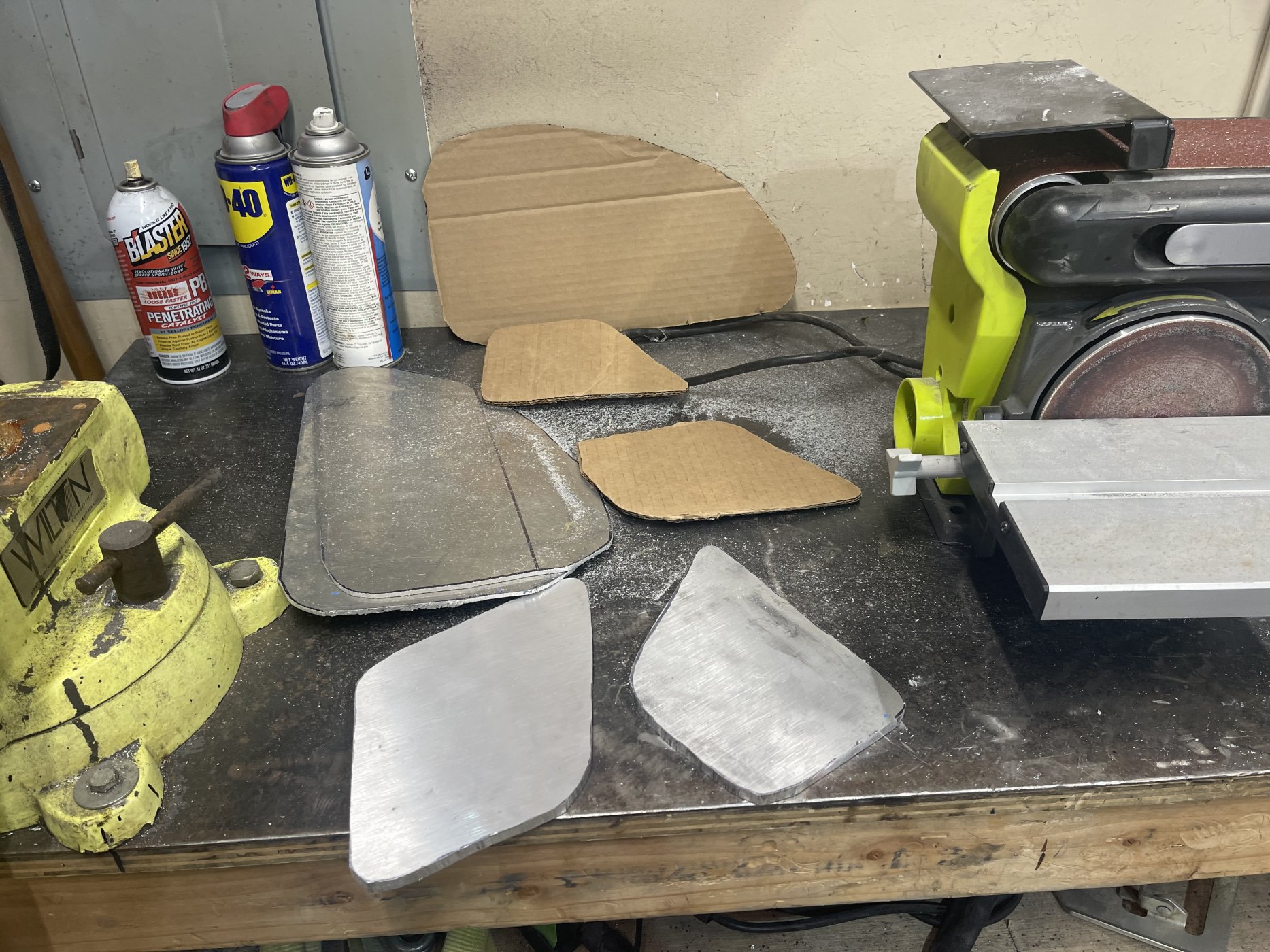

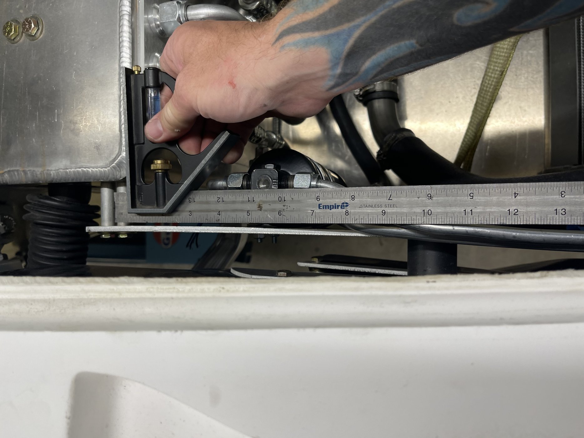

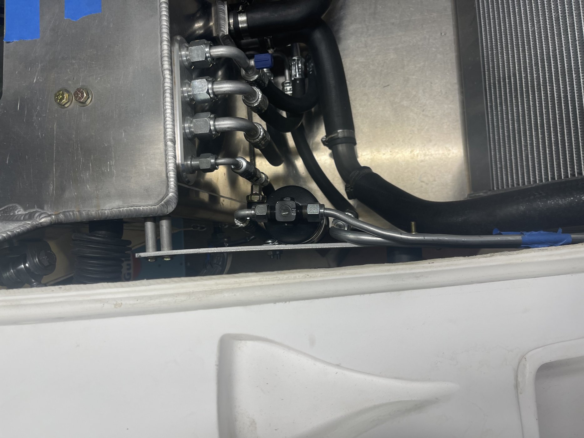

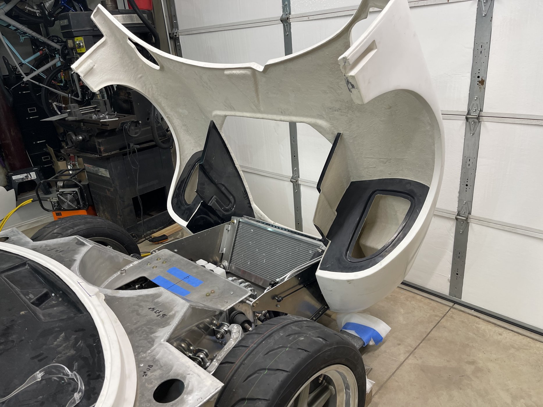

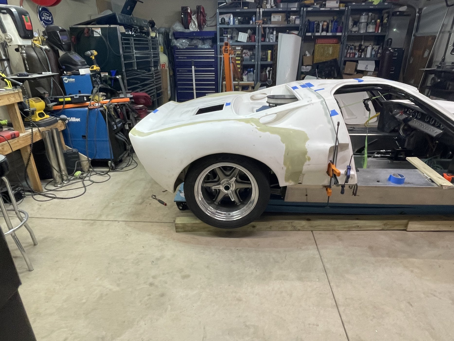

I fabricated some brackets for the hinges on the rear clam shell. I was surprised at how different each side was. I also made some panels to cover the holes in the front wheel wells while I was at it.
I'm working on dialing in the adjustments for the front clip and rear clam shell so that I can mount the spider. I am definately starting to see all the differences in these cars from side to side, got a lot of tweeking to do on this body for sure.
