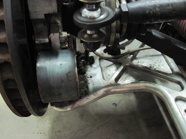

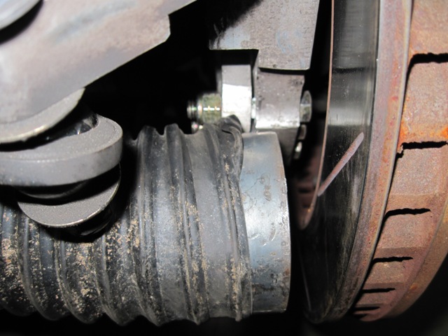

Been having problems with serious brake fade so here it what we did to get the cooling duct closer to the rotor. We have changed brake fluid to 600* and are modifying the inlet on the nose. We are also looking at the check valves in the brake system trying to get input on what to do with those. Will let you know what turns out after this weekend at Roebling Road Raceway.

Ideally you need to get the cooling air into the ID of the rotor by the vanes so they can do their job of pulling the air thru when rotating, wont hurt to have another hose/duct pointing at the caliper either,[ best situation/cure would an upright that had provision for all that cast/machined into it]
Does your brake system incorporate check valves in a circulating setup like DPI?, where you use a dual fluid line setup-one out to the calipers, one return to the Master Cyls, so that the brake fluid is being moved thru the system with each brake application.
X2 on what Jac said. A brake flud recirculation system will damatically extend your brakes. In lieu of this, I would suggest making sure you give the brakes a good bleeding after each outing to remove that fluid which has boiled in the calipers. Once fluid has boiled or even gotten extremely hot, it's resistance to heat / boiling is reduced substantially..
Bob, air directed to the rotor in the manner in which your picture shows, is - as Jac Mac mentions- not optimal, and may in fact lead to increased cracking.
The best solution is to use a properly designed duct that takes cold air from the front brake duct openings in the bodywork and directs it into the center of the rotor, with sealing to improve efficiency.

Personally, I don't think you need exotica like brake fluid recirculation systems, as the 01 car has proved over time that it didn't need it (even in a 13 hour race), and the 01 is likely both heavier, and going faster, compared to your street/track car.
The right pads, fluid, ducting and overall brake condition are what you need to get right before you go to something more exotic. You've already got way more brake hardware than most SLCs, so that's not the problem, assuming something isn't amiss there.
Most times, it's the simple stuff that has to be remedied first. If it were my car, that's where I'd start.
I do 24 hour races on a set of pads now or more. I used to go through a set in about 8 hours and have fluid issues. The brakes are plenty big enough and should have no issues. The only thing we changed, now a different car but same concept, are 3" brake ducts. As long as you are flowing more air over them it should help a ton and the more you can get the better. I now have 3 3" per front. One to the caliper, one to rotor and then one to center as I can. The idea is to keep it cool and after talking to carbotech the wear rate is exponential when it gets hotter as the pads break down fast when super hot.
I was suprised the 01 race car did not have big ducts, but those are just that good. So it can not hurt. I plan to use art least 1 3" duct per side if not two. If I can get pads to last longer then I would be happy. I like my carbotech rp2 compound for the track as that is their long lasting endurance pads.
RRR is pretty easy on brakes too. If they won't last there then they've got no chance at CMP.
Ditto what has been said - get the duct to the center of the rotor so the air can flow outward as it is designed to do. A caliper duct certainly won't hurt, and neither will a rotor hat, but the center duct is the key.
