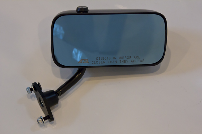

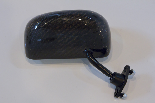

I received my APR mirrors, and took some photos for you guys. I have to say, they are a nice quality piece, and unbelievably light. The size is smaller than I had envisioned, which I hope isn't an issue when mounted.
I had the same reaction about the size of them at first. Now I don't even notice them, they blend so well with the look of the car.
Make sure to mount them up higher than I had the original mirrors like Mesa did and the visiblility behind the car will be really good.

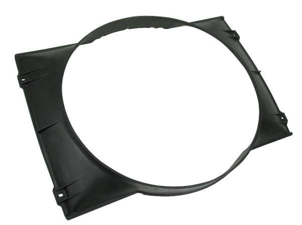

I'm not Allen but I bit a shroud.
I <3 my shroud
Silly question, but here goes: If the shroud is placed directly on the radiator, would you effectively decrease the air flow in all areas that the fan is not directly pulling air from?
I was thinking that if the shroud were spaced a few centimeters off of the radiator, which would also increase the distance from the radiator to the fans, air could be pulled from all areas of the radiator.
It's hard to tell from the photo Alex, so my apologies if I'm not quite seeing it correctly.
In the attached photo you can see how the shroud is "domed" away from where it would attach to the radiator.
Ben,
I think you are right! You need to have some room behind the fins for proper airflow.
Alex,
Nice job. I assume you left some space for airflow. If not, you could always space the shroud further if it doesn't work.
