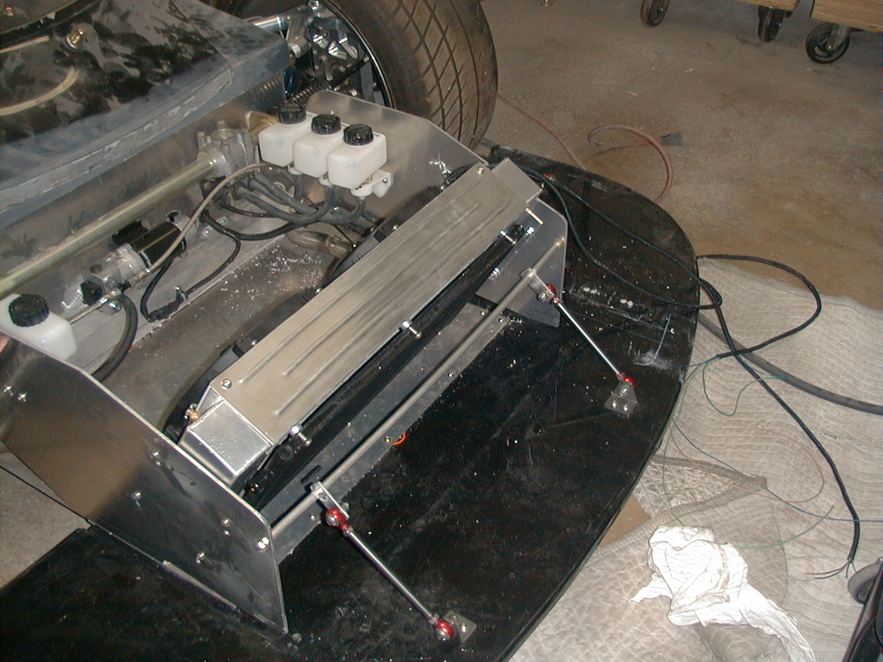

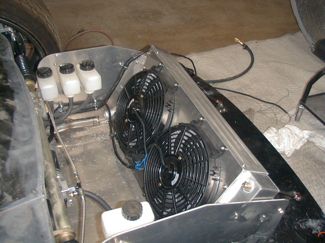

Silly question, but here goes: If the shroud is placed directly on the radiator, would you effectively decrease the air flow in all areas that the fan is not directly pulling air from?
I was thinking that if the shroud were spaced a few centimeters off of the radiator, which would also increase the distance from the radiator to the fans, air could be pulled from all areas of the radiator.
It's hard to tell from the photo Alex, so my apologies if I'm not quite seeing it correctly.
In the attached photo you can see how the shroud is "domed" away from where it would attach to the radiator.
That's correct - (at least according to my research) - you want space between the fan and the radiator. I believe it was something like 2'' is the ideal distance.
it's hard to tell from the picture, but the fan shroud is not flat on the radiator
Before I cut the fan holes and had it welded up
That photo is really helpful. Thank you very much. I was wondering how I was going to go about designing something.
I made a frame of 1" square tube aluminum welded to the radiator. The cover/fan mount is 1/8" aluminum with riv-nuts to mount the cover and fans. The top cover is 16 gauge aluminum run through a bead roller. The condencer mounts with riv-nuts and spacers on the radiator lip.
