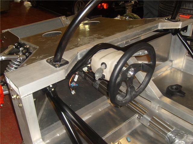

Just while we're on the topic of the SL-C monocoque, does any of the roof add to the structural strength. I'm asking because I wonder if you could take the roof and upper doors off and have it more like a LMP Le mans open design?

Thanks for that. I was thinking more of removing all the glass and just having two small screens LMP style, with the nose bodywork continuing up to just in front of the instruments. And then behind the seats, two roll hoops and engine intake.
Don't know how to edit my last message, the two small screens would be about where the Dashboard changes colour/texture in the first photo.
David,
If you had the remainder of the roll cage present I wouldn't think that there would be much of a structural compromise.
You would want a little more side protection around your shoulders/helmet. Maybe a removable hard cover over the passenger side?

Unless the roof is bonded/bolted to the chassis and roll cage and constructed of stout materials, it won't contribute anything to chassis stiffness. Doc is right, the only contribution would come from the roll cage itself.

I was thinking there was enough room behind the seats and around the engine to put a rollbar in. I could take the line that the top of the door follows around and up to fit in with an engine cover and roll protection. Not sure about the shape the bodywork would take now that the windscreen has gone, I suppose it would be easiest to take the screen out and have a look.
