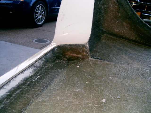

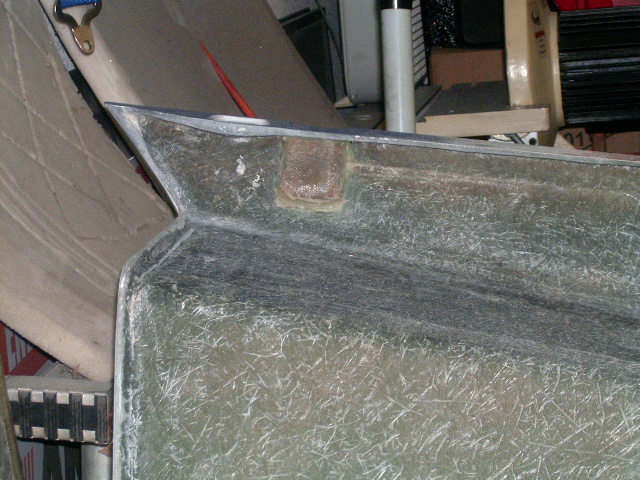

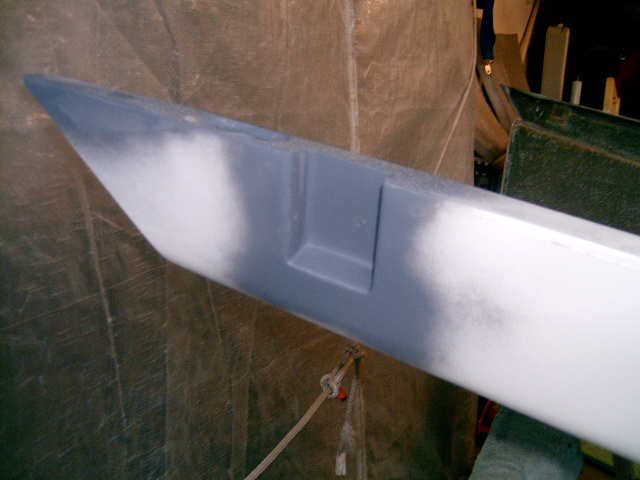

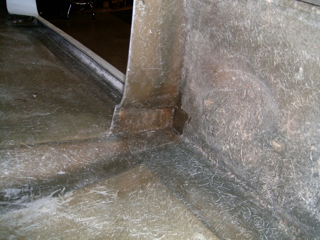

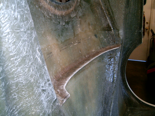

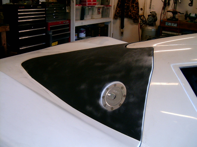

More minor fiberglass work. The top rear latch pockets are in and I added vertical slats to the interior vertical member of the rear bodywork. These seam to have really stiffened up this area of the bodywork.

Howard Jones
Yes, I made them out of the leftover material that came from the inter door panels opening cutouts. I cut two per side aprox 2"X4" and bonded them together with Plexus. This resulted in a 1/4 " thick two ply piece. I sanded the edges to fit tightly into the body gaps and then again used Plexus to bond them into place. The next day I overlay-ed a few plys of glass mat to add thickness and additional strength.

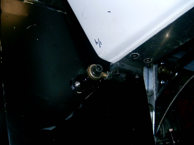

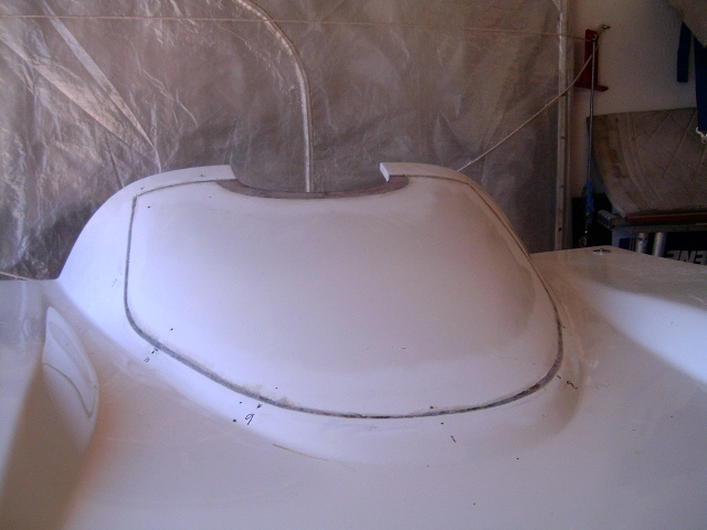

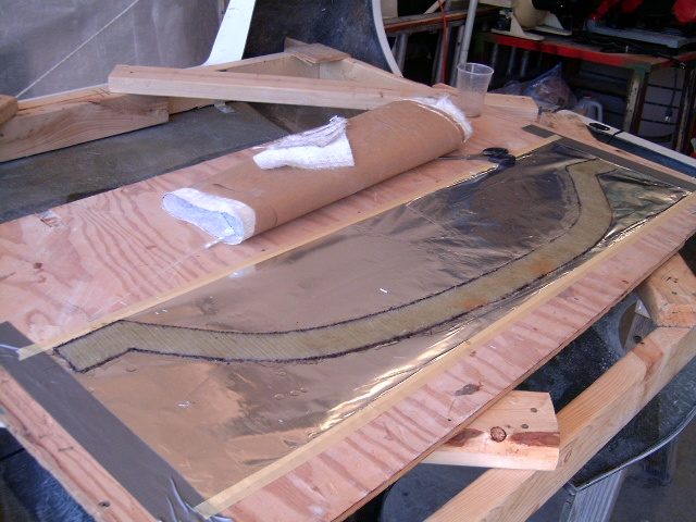

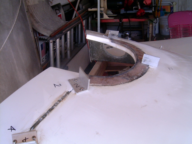

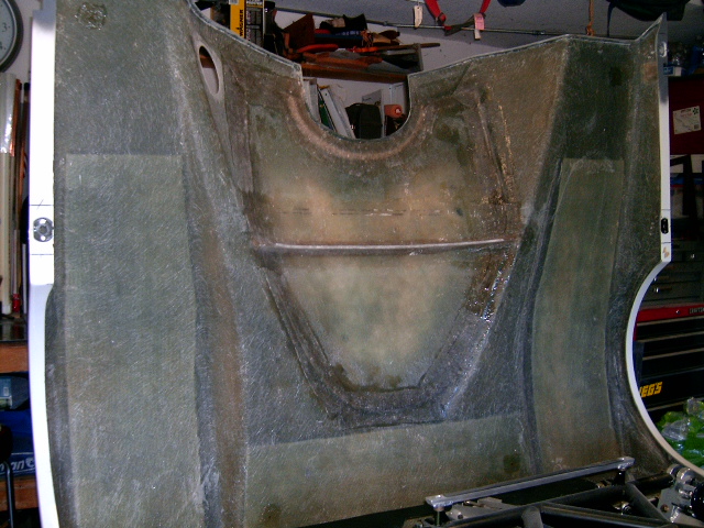

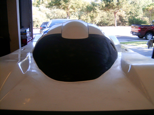

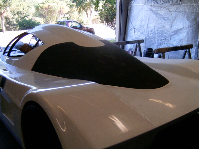

Continued rear bodywork changes. So, no rear window, can't see out the firewall anyway. What the hell, glass it all in and forget about the lexan cracking, and all that extra stuff. What I did was cut out the window all the way to the edge, move it up a 1/4" or so and glass it back in. A little body filler (very little) and you can't even tell its not all one piece. I think the race tail should come like this anyway, but I'm not paying for the bucks, am I.
I also added a stiffener. It seems to have made quite a bit of difference. I can now open and close the rear from one side alone and the rear bodywork doesn't flex much at all.

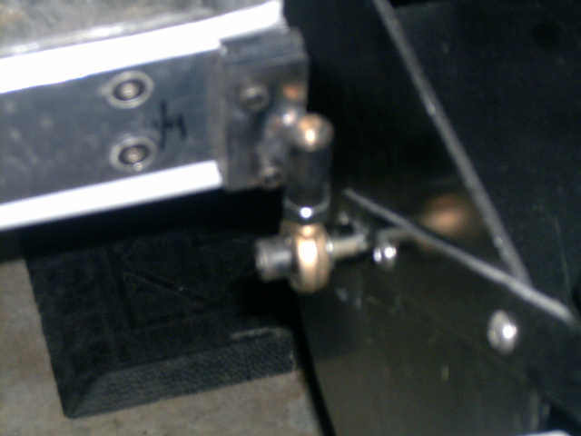

The last picture is of a neat little henge. The rear can now be moved for and aft about a 1/2 inch. Simply turn the rod end. Easy alignment later.

I'm hiding the SBC. I run the majority of my track days with a local shelby club. Sort of a joke but, not really, No need for a window, You can't see out of it anyway.
Thought of doing the same guy's. Only difference is to make a mold from the actual window (will fit better & a bit less work to post finish). Could mold in some additional vents for the race tail too. It would also lend itself to some very nice two-tone paint job. Still mulling over this. By increasing the thickness of the fiberglass around the rear clip "horseshoe", and adding a simple stiffener it makes the whole clip much
stiffer (I think Rob was first to do this).
Howard Jones
The thing is, I don't think its any more weight this way but its stronger. The mold is pretty thin in the area that is cut out if you install a window and if you leave a nice wide border for strength it is double thick in that area. Then you have whatever hardware you would use. Pretty much a wash on weight if not a bit lighter. I may add two NACA ducts later for ventilation of the engine room.

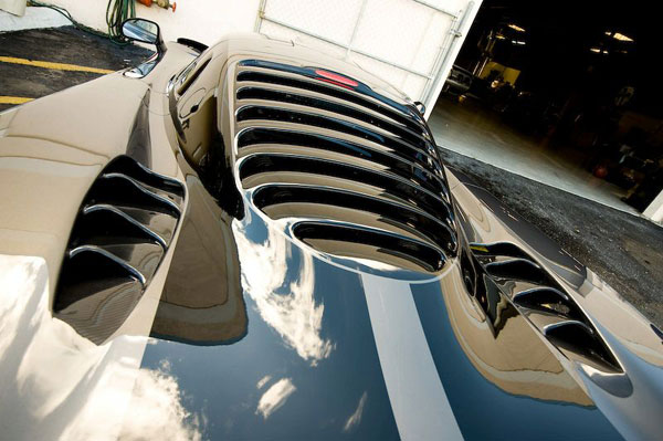

I would like to see some MT900 rear "window" vents and some Zonda R styled rear brake duct intakes on the SL-C. As has been pointed out, the rear window is useless except for showing off the engine.
I've been trying to picture these on the SL-C.
