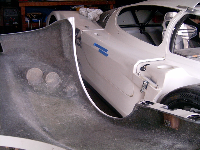

Agreed Fran. The bigger exhaust for the radiator should reduce restrictor in the airstream that is used for cooling the water. Ducting it inside the hood so that it all leaves the car at the cowl takes care of that segment of the total airflow over the front to the car. The other three, as I see it, are brake cooling, wheel well inflow and the portion that goes under the car.
You guys seam to have addressed the wheel well issue with holes in the inter wheel humps and slots in the top of them. By the way how much $$$$$$$$ are the two fender slots? Also how much did the inboard holes on the fenders help. More than the slots? or less? I'm trying to access them as % of improvement in relation to the slots.

Ditto on those comments. Howard- I have read through your entire build thread several times. Like a few other builders, you have a remarkable talent. Thanks for sharing everything. I intent to widen my rear side vents too. However, I am having side exhaust. It appears that may create an issue for adequate area for the exhaust plates? Do you have a contact at Mesa Design for a mock up? Thanks again!
Howard Jones
ha ha ha .........mock up eh! There's no mockup! just mark 1 eyeball. Really I used the lower body line as a lower perimeter and cut out the old inlet bottom. Then I cut the body out fixed the old cut out lower inlet piece in place in place and glassed it back in. Once that was done I used the cut out body piece to fill the gap.
Once it all got hard I filled the part lines with body filler. Done. Fiberglass is easy. Just hack it out and go for it. My modo is "you can always grind it off and do it again".

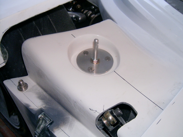

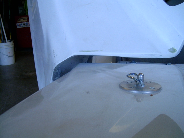

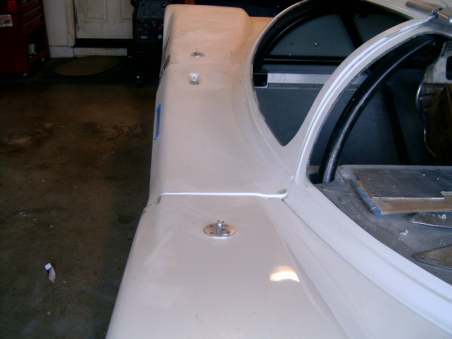

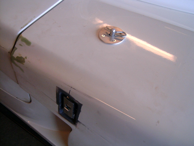

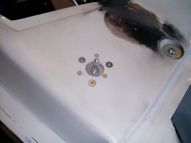

Finished the hood pins. I tried a few different kinds and settled on these. They are not as big as the 1/2 inch diameter ones that have a much bigger pin. I thought they looked too big and not in the SLC style. I also tried the kind that the pin remains on the mount and slides forward and then is flipped over. I think they are chincy.
These meet my needs for a redundant system. In this case double redundancy at the front and triple at the rear if you count the doors need to be opened to lift the rear bodywork up.
As I said elsewhere these are hard to miss. In one you can see I trimmed the door top leading edges to clear the nose bodywork when it is opened. I also trimmed the front wheel well openings. I'm going to have to start sanding pretty soon to prep the body. I hate sanding!

Highly unlikely the Aerocatches will fail as 95% of all pro race cars use them from Grand Am to Le Mans...and they seem to provide good long lasting service
Howard Jones
Alex......alex.......alex............ No I don't expect ANYTHING to fail. I like to build things that suit my expected use. I am old and I don't re-learn things easily. I have had my GT40 on the road for more than 10 years and have run it about 20 weekends on track at least. I have learned how to do it without screwing my car or myself up and I don't want to change ingrained habits that I am pretty certain work.
I always look at the hood pins right before I get into the car and belt up. It's something that ALWAYS catches the mistake of leaving the pins out. Never have missed this. Many of the changes I have made on my car are because that's the way I do things. Not that my way is better but because it's my way. I am sure you have similar methods.
The Aero catches are really nice pieces, I don't see how they COULD fail unless you broke the bodywork around them in a crash. However where I would need to mount them on the car would be out of direct view up inside the scoops in the rear and in the wheel well exhausts ducts at the front. I don't want them there on my track car. They look better there as on a street car BUT I might miss them in my old man in a hurry state at the track.
So don't worry about them they work fine and are well made. OK

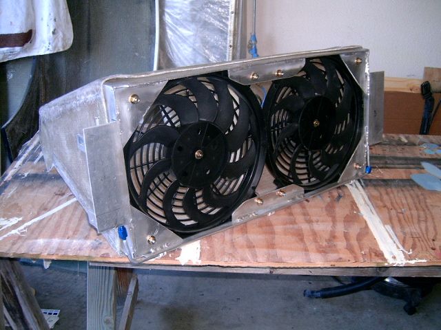

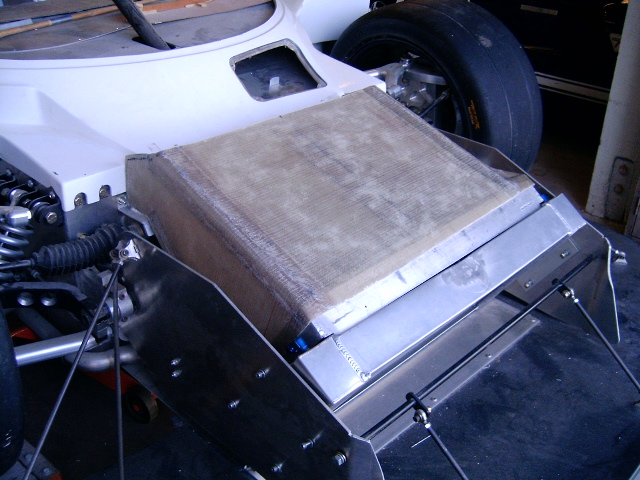

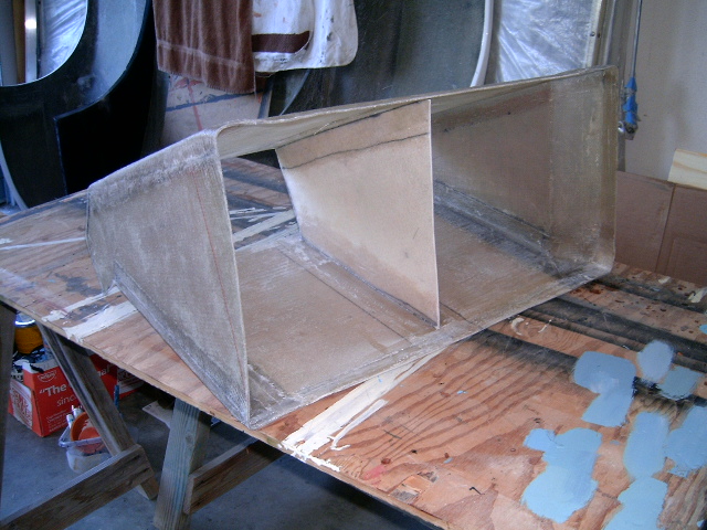

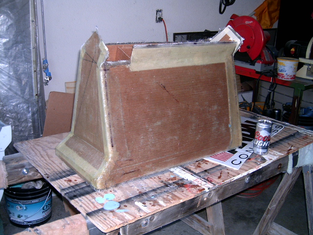

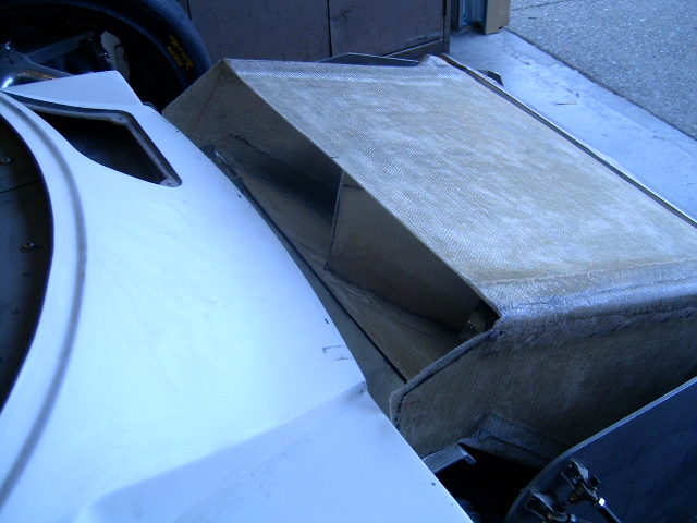

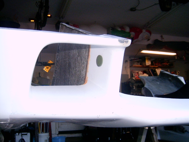

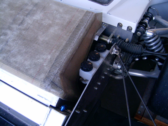

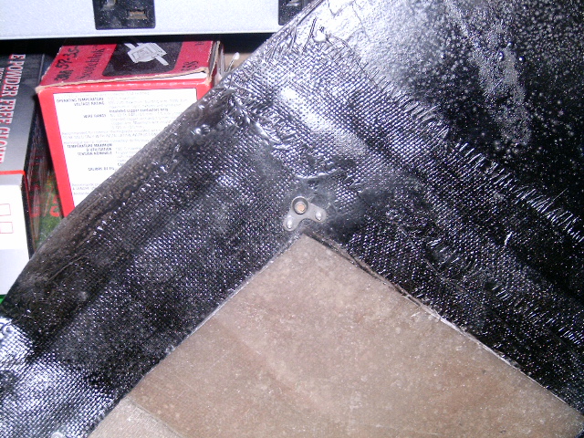

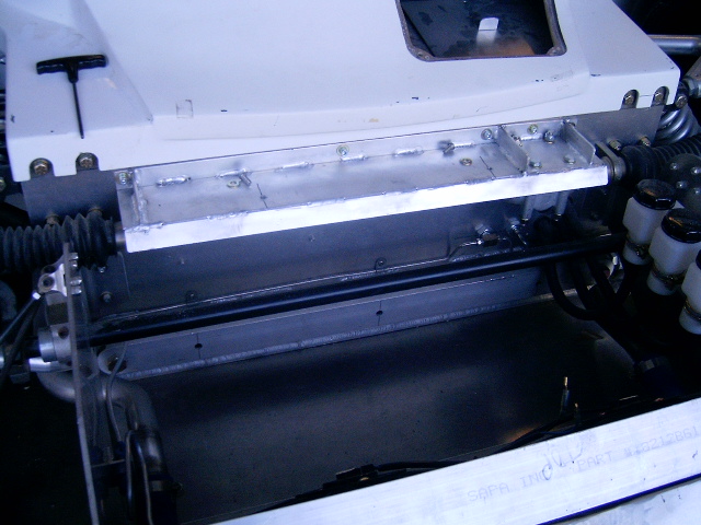

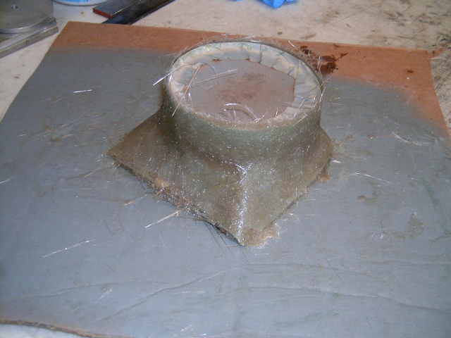

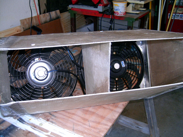

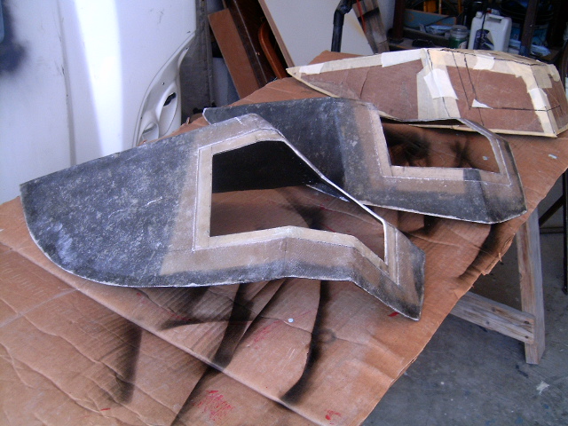

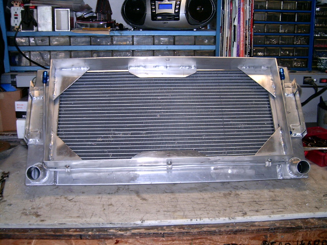

I have been taking about radiator ducting so here's my best shot. The idea again is to force all of the air that goes into the front of the car to pass through the radiator and then out of the car through the hood exhaust opening. This achieves a couple of things. First, prevents radiator exhaust airflow from ending up in the wheel wells and creating lift. And second using the airflow inside the duct to create down force.

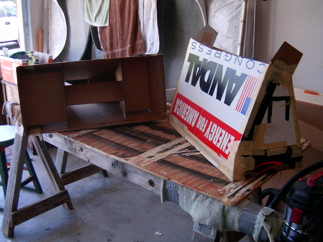

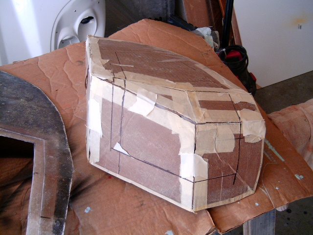

I only needed one piece so I made the mold out of cardboard, covered it in wax and painted on PVA release. This worked pretty good except that if you do it this way you must be vary careful not to distort the cardboard form or the result will not be the correct shape. Mine was out of square about a 1/8 inch but it will work and that's all I really needed.
I used some leftover fiberglass decking mat. It was a bit of a chore to make conform to the 90 degree corners so I made it in pieces and bonded it all together before it fully set up. The bottom of the duct has a added honeycomb fabric imbedded in it to add strength.
The whole think weights about 2 pounds.

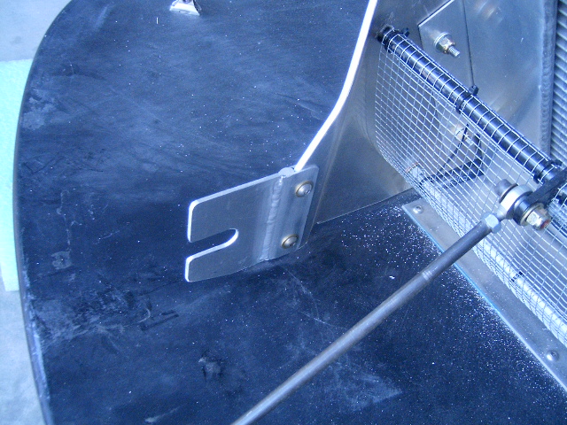

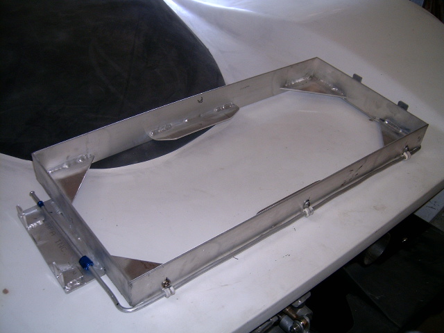

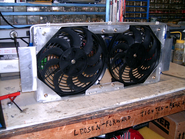

I also made the radiator fan tray again. The first one wouldn't work with the duct. It's aluminum and seals pretty good to the radiator. The other mount is across the foot box and incorporates a steering box mount.
Here's some pictures.

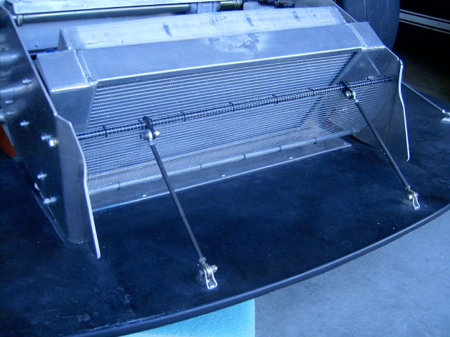

Here's two I missed, steering box support/rear radiator duct mount and the debris screen.

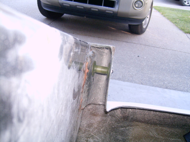

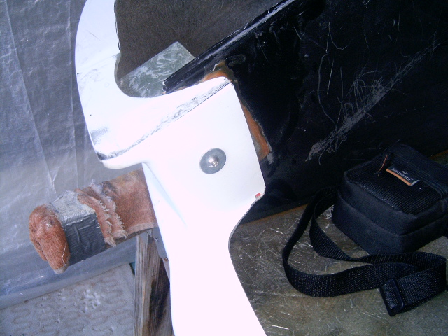

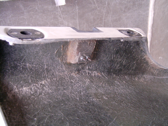

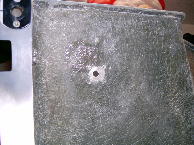

Front body nose catches. I made the bobbins that fit into the vertical nostril divider from behind out of some tubing and a couple of washers. The pin fits into the bobbin from one side and the other is threaded so that it can be fastened with a socket head screw. The whole thing was to avoid just running a bolt through the fiberglass with out any load bearing support on the inside.
The U thingies are pretty self explanatory. On to the headlights.

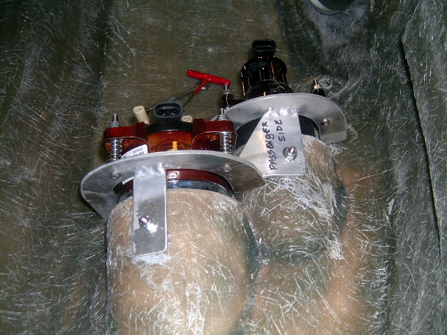

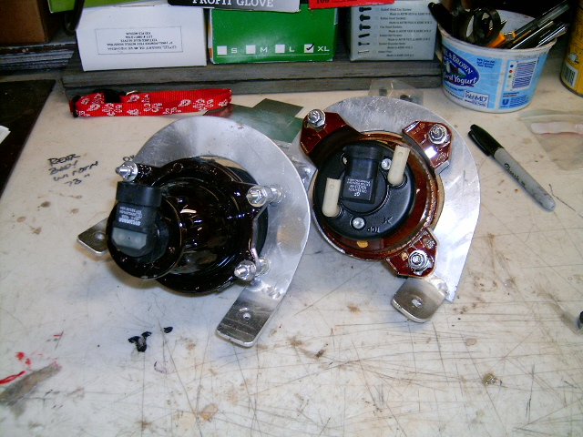

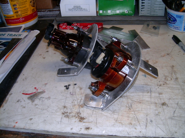

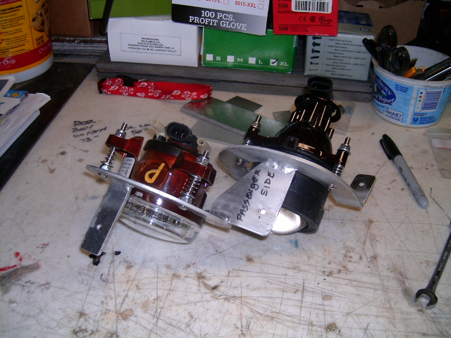

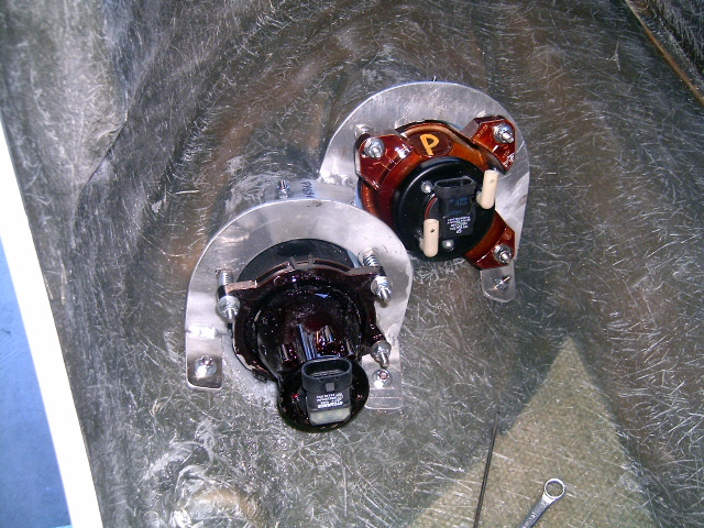

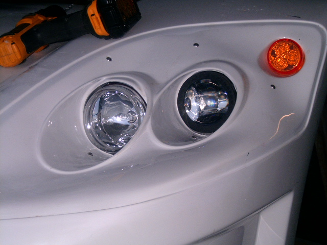

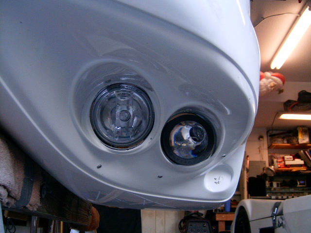

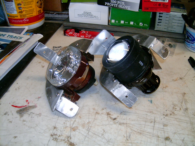

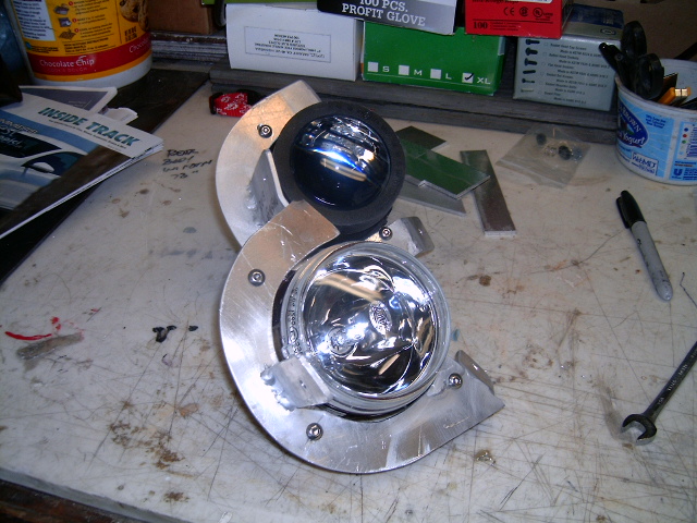

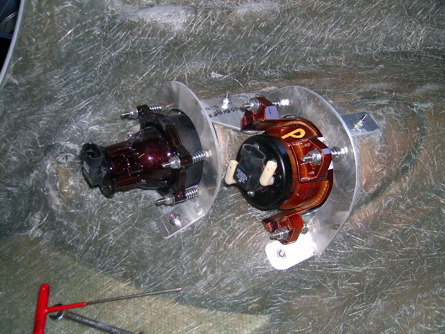

Ok, here's the passenger side head light assembly. I made the aluminum pieces from some 6160 1/8" thick plate with a big hole saw, disk sander, and a sawsall. My version of a CNC machine.
The headlights are Hella's. I am using a 90MM high beam for the low beam element and the 60mm high beam for the high beam. I intend to wire them up so both are on in high beam mode using relays for both. If I ever do drive this thing at night I want people to SEE me coming.
I was going to bond the mounting system in place but I was thinking if I ever hit anything I want to be able to salvage the mounts if possible. The way they are bolted in place with 10-32 screws I can simply remove them. On to the drivers side and then fiberglass surround housings to keep them from being ruined from debris coming off the tires.

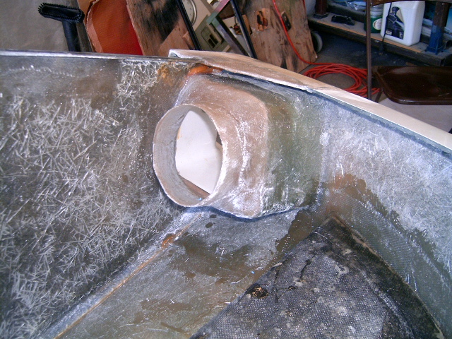

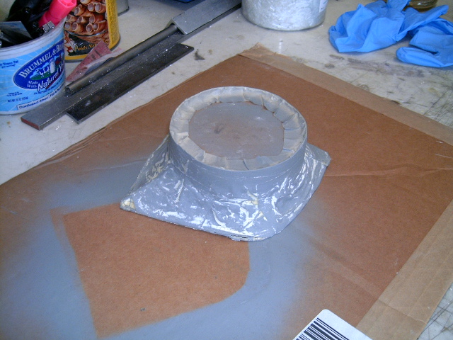

Howard Jones

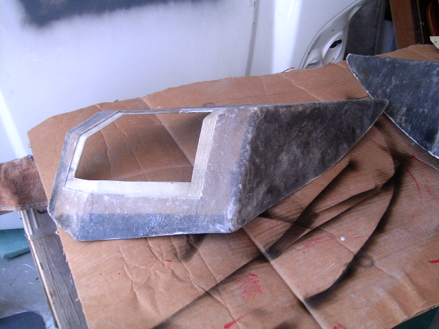

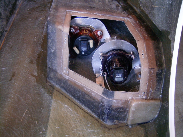

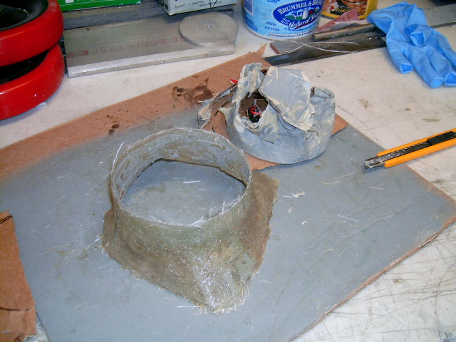

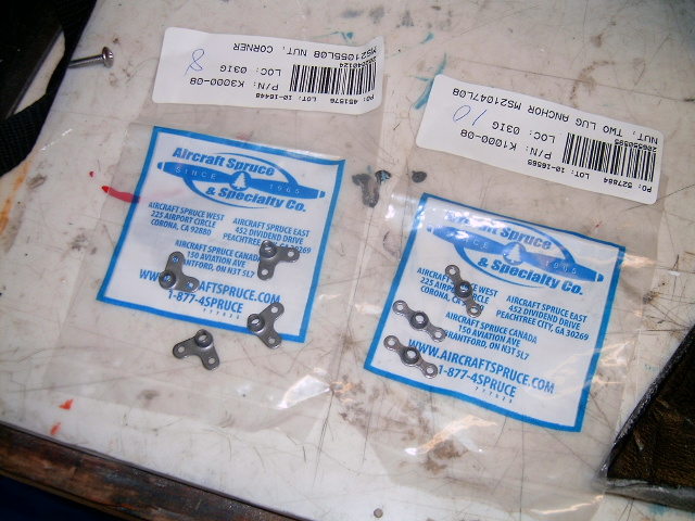

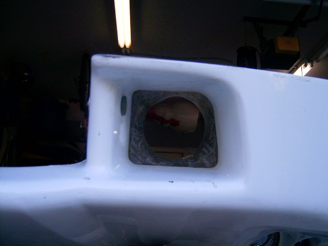

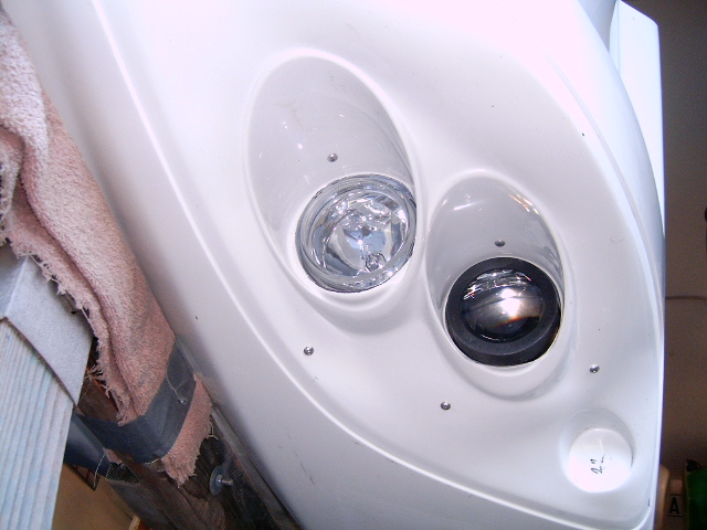

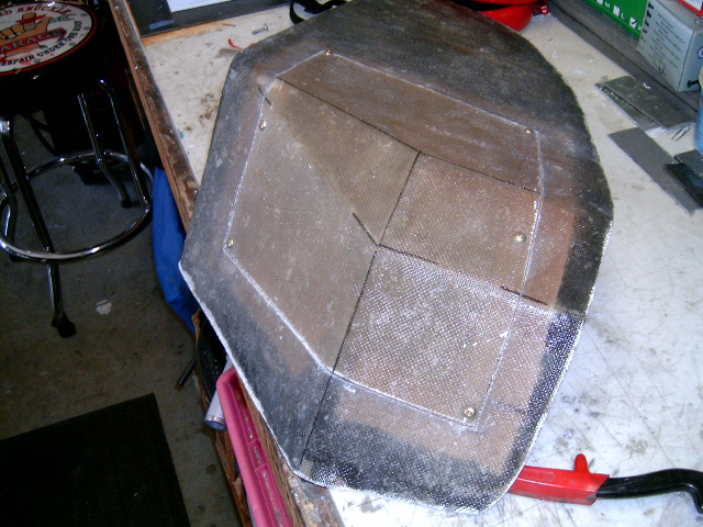

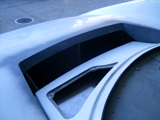

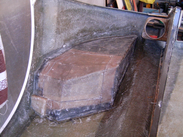

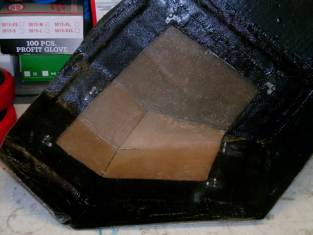

So I'll catch up a bit. I have pretty much finished up all the stuff on the nose of the car I wanted to change. Lights in, Light enclosure, brake cooling duct, increased radiator exhaust opening, hood pins, and latches.

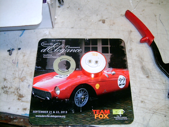

Here's the new pictures. The little screw thingies came from Aircraft Spruce. The turn lights came from Super Bright LEDs.
I made the bayonet plates for the turn lights.

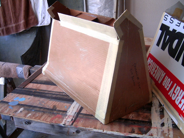

Lots of cardboard went into this stuff. It works but it's only for a one time mold.

Nice work, protecting the lights from road trash and moisture. Do you have a seal of any type on the cover panel?
Enjoy watching your progress.
Howard Jones
Ya, I'll put a thin foam seal around the perimeter of the cover in the end. Still along way to go before final assembly, that's when I do stuff like that.
I will never drive it in the wet anyway.
