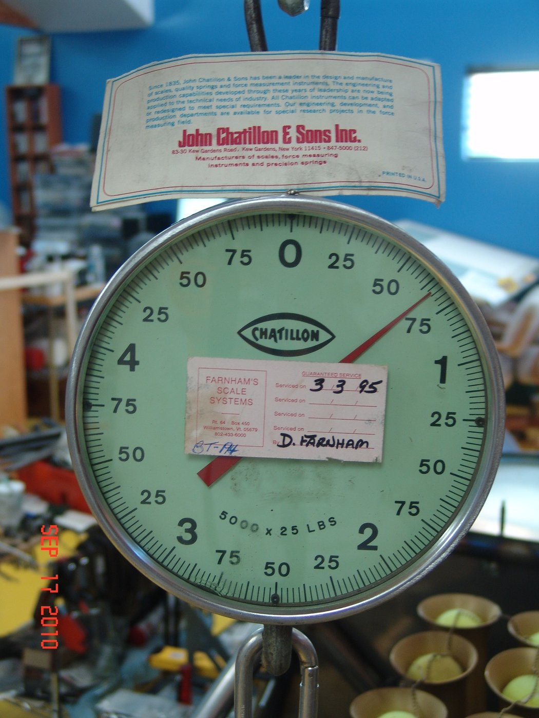

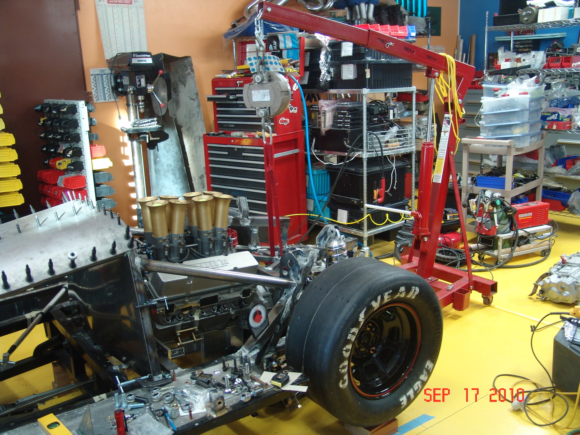

I don't know yet, Chris. I have a Chatillon 5,000 lb scale that I've weighed some of the heavier parts on but my engine hoist can't lift the whole car so that I can measure its weight with that scale. I did have a preliminary look at the rear axle weight earlier just to get an idea of what to expect. As you can see in the photo there were many panels and components that had not been installed and, of course, the rear body. When I get the engine back in I'll try to find a certified truck scale and weigh the car. I'll be interested, too, in how accurate the spreadsheet is.
