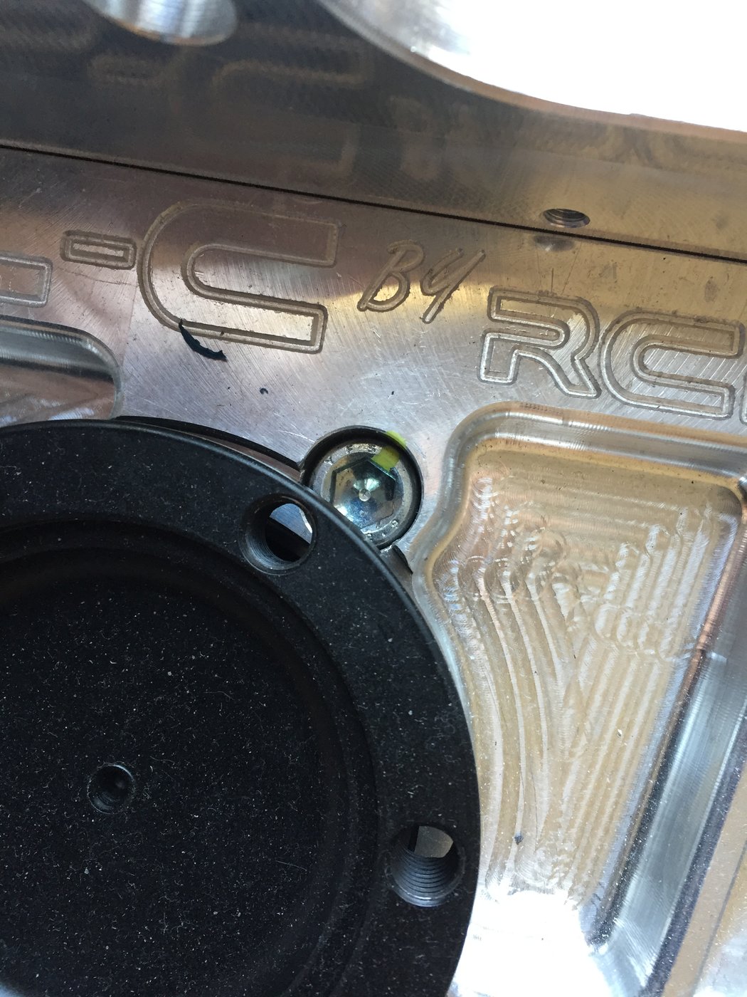

If you bolt the C7 hub up without the shim then the rotor would be .190" out of position with the brake caliper unfortunately. Paul took this into account with his new upright by machining the caliper mounting bracket inboard by the same amount. Howard took this into account by machining the rotor hat.
To answer your question.....yes it would just clear. The bolt heads would still need to be countersunk level with the surface though. (shown in the picture). Howard countersunk his bolt heads as well. Same with Paul I believe. The next set of rear uprights I have machined will have less clearance although the extra clearance might be better in case of a failure.

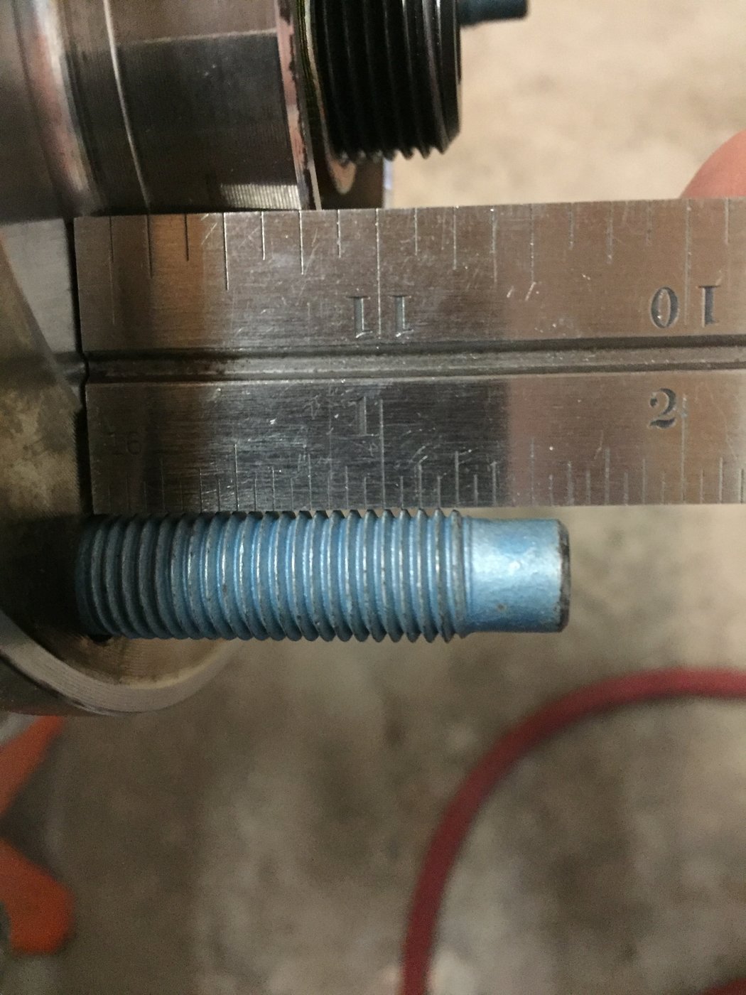

Are the wheel studs in the C7 hubs longer than those in the RCR provided hubs? The RCR hub studs are "just" long enough, I keep expecting the tech guys to point out I need longer wheel studs...

Here is a picture of the C7 stud length.
Those studs look about the same length.

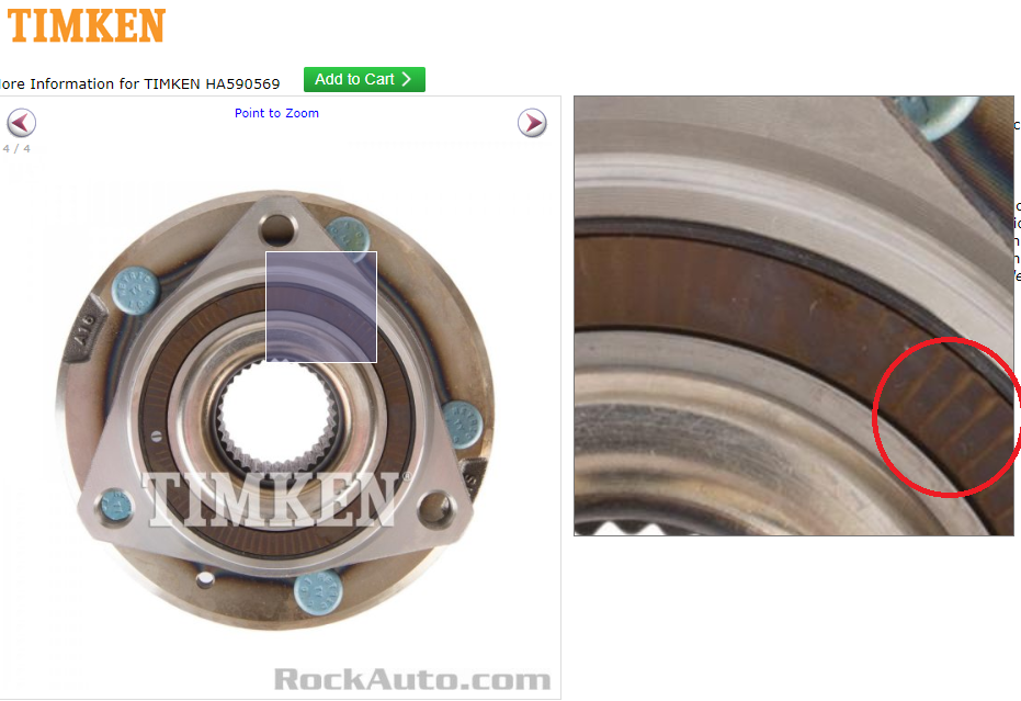

On RockAuto, the ACDelco's are listed as:
Anti Lock Braking System = Yes, Anti Lock Braking System Type=Encoder
I took that to mean the "tone wheel" is in the hub (but not the sensor). From the limited diagrams I can find, it kind of looks like the sensor is placed in the upright on the backside of the hub. In the Timken unit, it looks like you can "see" the outline of the tone wheel.
Of course the tone wheel could be steel or magnetic, but I can deal with either. For the price of these, it is hard to imagine the tone wheel being anything other than some type of steel. The C7 abs sensors look like 2-wire (non powered) units.
If the C7 are the 'best' bearing solution, I think I will order 1 and play with it to make sure I'll have no insurmountable issues.

Pretty sure that isn't a tone wheel. Even if it was there would be no way of getting a outboard sensor close enough to read it. The stubshaft flange faces that area not too far away. Zero chance of getting any type of sensor in between the face and the 33 spline stub shaft. My abs BMW sensors are two wire and also "active"
