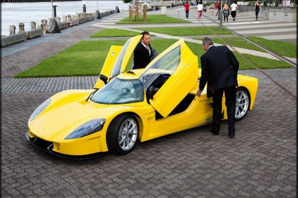

Many of the cars you see are indeed the factory gelcoat....it's that good. Look at EFNFAST's or Cam's threads for example.

Thank you for the pointers. Cam's car is beautiful. Unfortunately I think yellow is the color I am least interested in. My last go fast toy was yellow and while I still dig the color I want to do something different. I couldn't locate EFNFAST's build but I am on a tablet with my son asleep on my shoulder. Poor guy is sick as a dog and its the only way he can catch any shuteye. I will resume a search for Alex's build after I come back from the doctor.
Its good to know I can count on just buffing the gel coat. That means I can get it on the road that much sooner. I am not the fastest worker and it would probably take me a few weeks at least to paint that car to the level I would want it.
