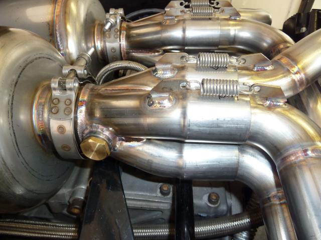

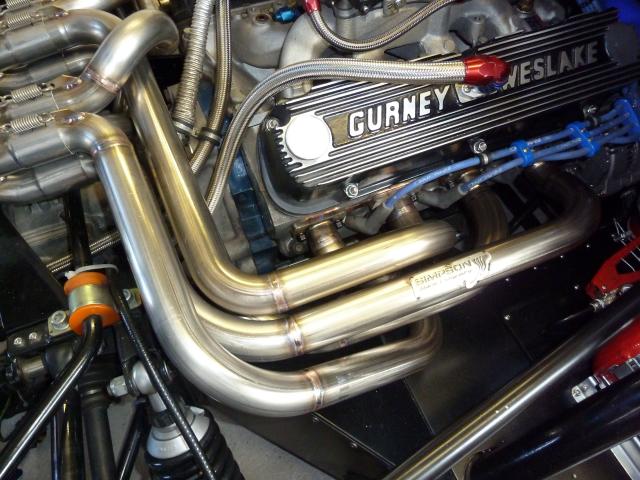

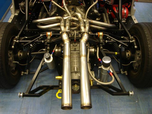

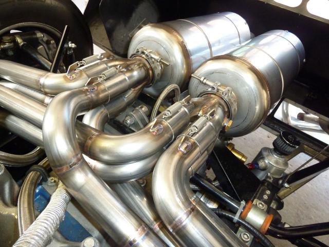

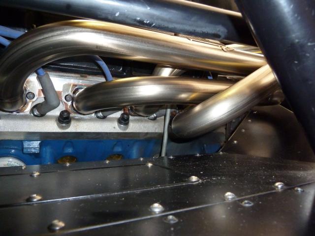

Check out my new exhaust.
Martin - Now there is some seriously NICE fabrication work!!! :thumbsup:
I love the quality of the welding!

Martin,
I am seeing several(4) lines running very close to some of the exhast tubes in your pics. Two of them seem to be block breather lines, and the third is the vent for the trans. What is the one running down by the #8 cylinder? Does it need to be relocated? Should the trans line use a 90 degree fitting? That is a pretty hot point right there. Nice work though.
Hi Bill
The photo's are a little misleading as the trans and breather pipes are not that close. The cool tube one protects the throttle cable which I am going to work on as it is about 1" away from the exhaust. Not bothered with the car for months due to the cold weather but that is improving as well as my interest in the car.
Not sure what to do with the throttle cable may put a crank or wheel in at the back of the carb to take the cable across the back of the engine at 90 degrees to parallel the exhaust pipes then into the sills. Any ideas would be welcome.
Martin
Hi Bill
Martin
Could you flip the carb around 180 degrees and run the cable forward through the cabin? That is what I did and it has worked very well. No issues with interference with the headers. Details on my build blog.
Unfortunately at this point it might be a big job.
Contests on your good progress. Sure looks good.
