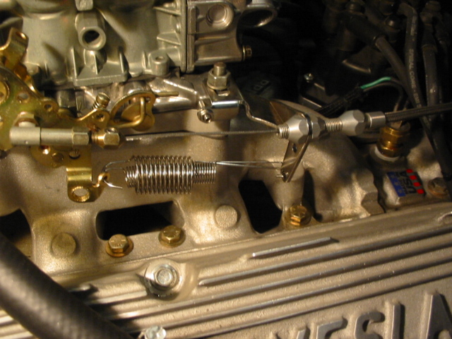

Martin:

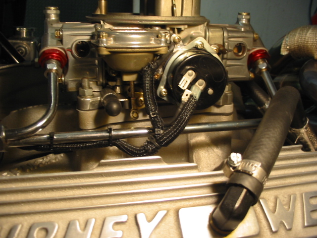

Looks like several good options have been placed on the table for your consideration. Just to close the loop on my suggestion to turn the carb around 180 degrees here is a follow up.
We both are using an Edelbrock air gap intake manifold. I am using a similar carb. So functionally we are in the same ball park.
A nine foot long stainless braid covered Lokar cable was used. It works just fine in this application. The cable was held to the front of the engine on the AC bracket, although any point that keeps it away from the pulleys would be fine.
Two return springs are used to comply with track regulations. The stainless cable / spring bracket comes from Holley (If my memory serves me correctly).
There is an angled spacer under the carb that keeps the carb level. It is visible in the second picture of the opposite side. Without the spacer the reversion plate on top of the air cleaner would not be parrallel to the clip.
I have had no problems with performance whatsoever. It idles fine, accellerates fine, does exactly what a SB Ford is supposed to do. Actually it runs like a scalded cat and is a hoot to drive.
There are obviously different solutions to the problem. Good luck.

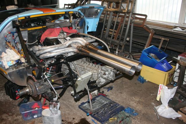

Yes I meant the club day on the 25th April, easter monday I think. I have been told I can run my mega phones, not as nice as yours but should be loud enough! I suspect that will be the only day I ever run them, but they look great on the shelf. I plan to take my normal exhaust as well for when my ears give up. This picture was taken during manufacture of them and so they are a bit shorter now!

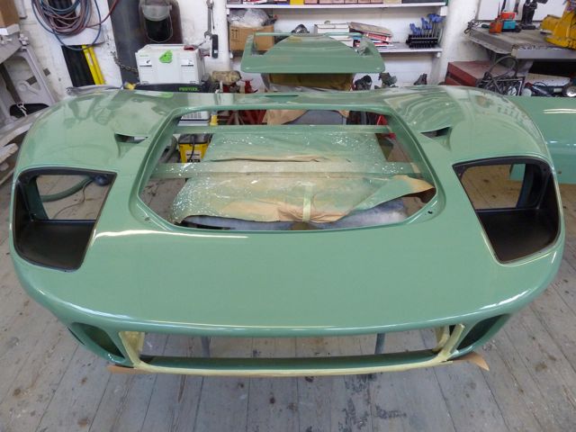

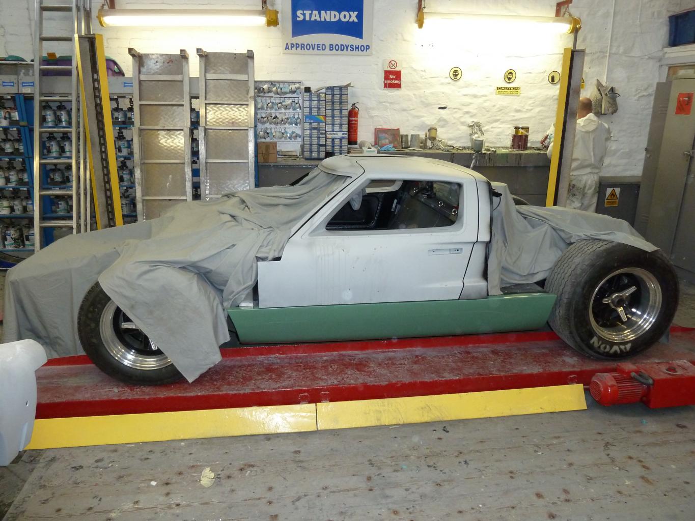

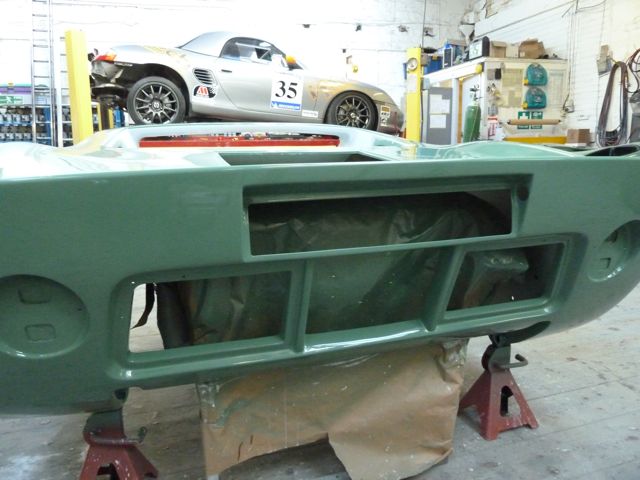

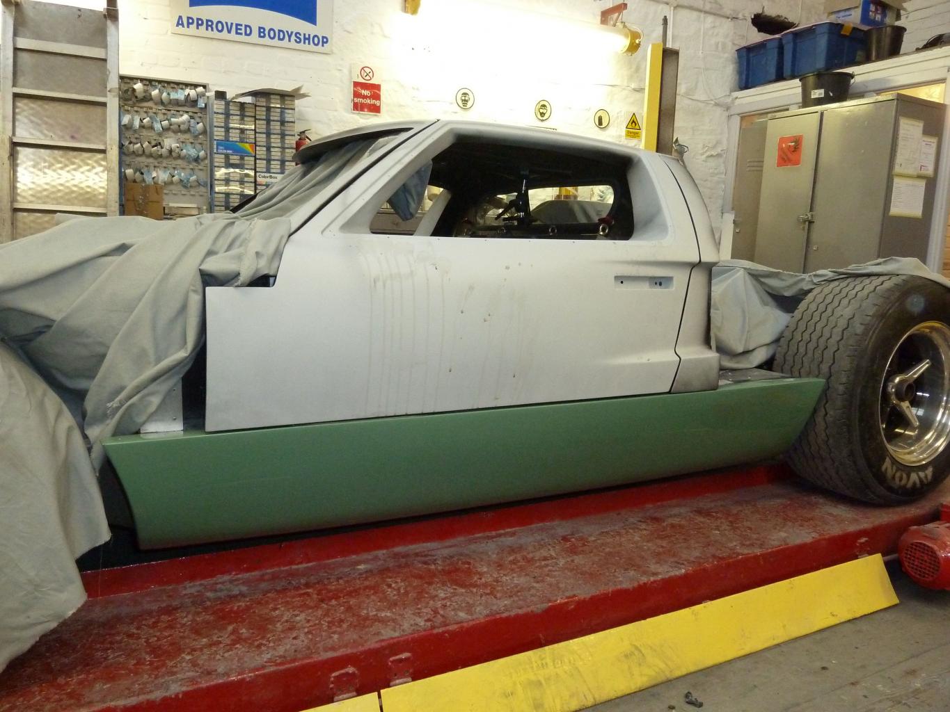

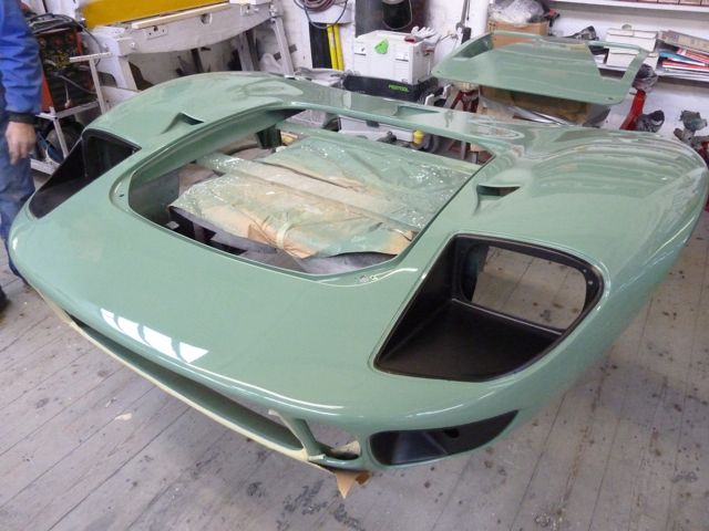

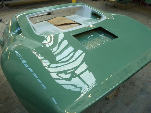

Nearly done. Should be home next week.
