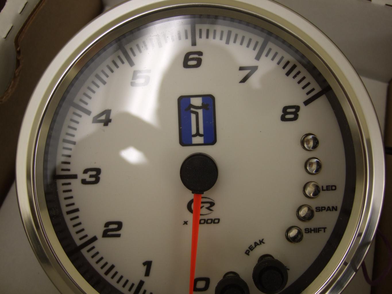

Mike,
Can you post a picture of the gauge face with the DeTomaso logo?
Or e-mail it to me at [email protected]?
Thanks,
Ron

Mike Trusty
Ron:
Here are some very poor pictures of the Tach.
