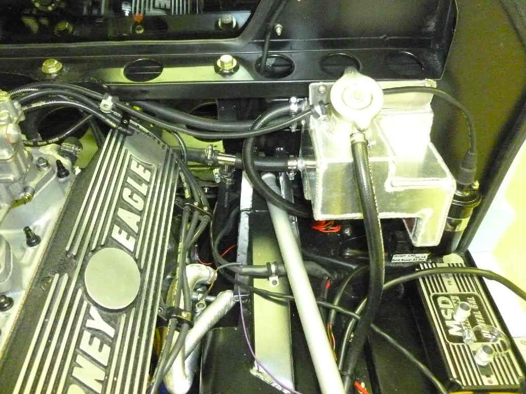

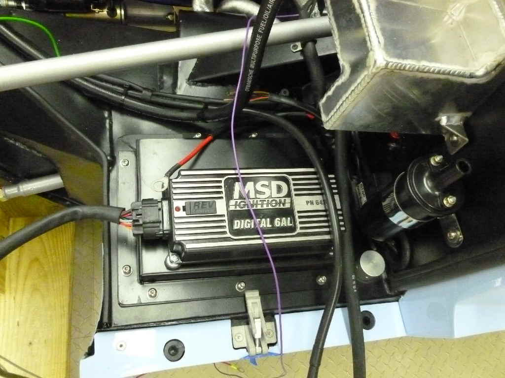

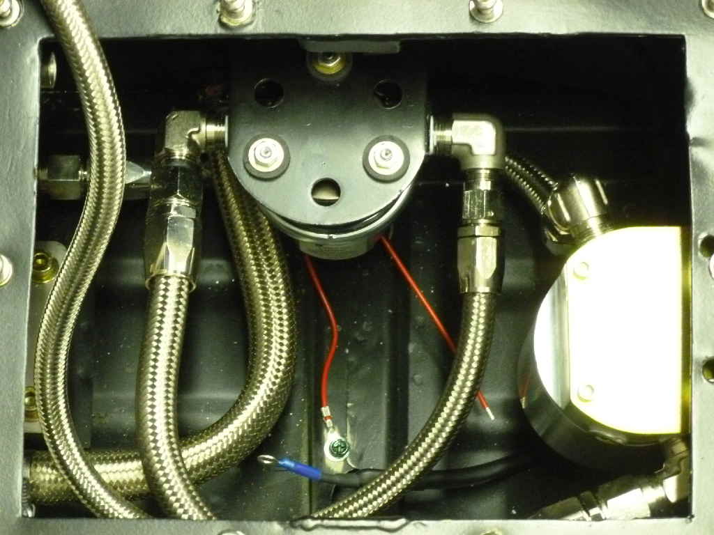

The basic install is not complex or hard. It is the "little things", the brackets, the hose routing, etc. that make a proper, quality install.
My car had been done by a shop that I assume had never seen a GT40 previously. They had no fuel filter on the system, a crappie clamp-on battery cable end and used cheap engine mounts that allowed the motor to rock excessively. It is the details that make the difference.
They also did not do any real chassis finishing (see the thread on sealing) and used a lot of crimp on wire ends with out soldering or shrink insulation which I consider a quickie way of doing electrical work.
I have a customer who did his own MK I install in about 30 days and it is one of the best and cleanest installs short of an Olthoff job. You can do it, you just need all the parts and time to do it right.

Additionally, how you wire the ignition will be up to you. I used an MSD Digital 6, mounted behind the passenger seat. Obviously, you don't have to do that. Don't forget to ground the motor to the chassis. If you use an electric fuel pump, there is wiring for two pumps already there. If not, you can certainly use a block-mounted mechanical pump. And, as Rick said, don't forget to use a good fuel filter with adequate flow.
There are lots of ways to plumb the oil system....from doing nothing (probably just fine for 90% of the cars) to a dry sump with remote coolers and filters. All of that depends on how you plan to use the car. I have a BIG motor, and occasionally drive hard. I've been absolutely fine without even using the supplied auxiliary cooler.
