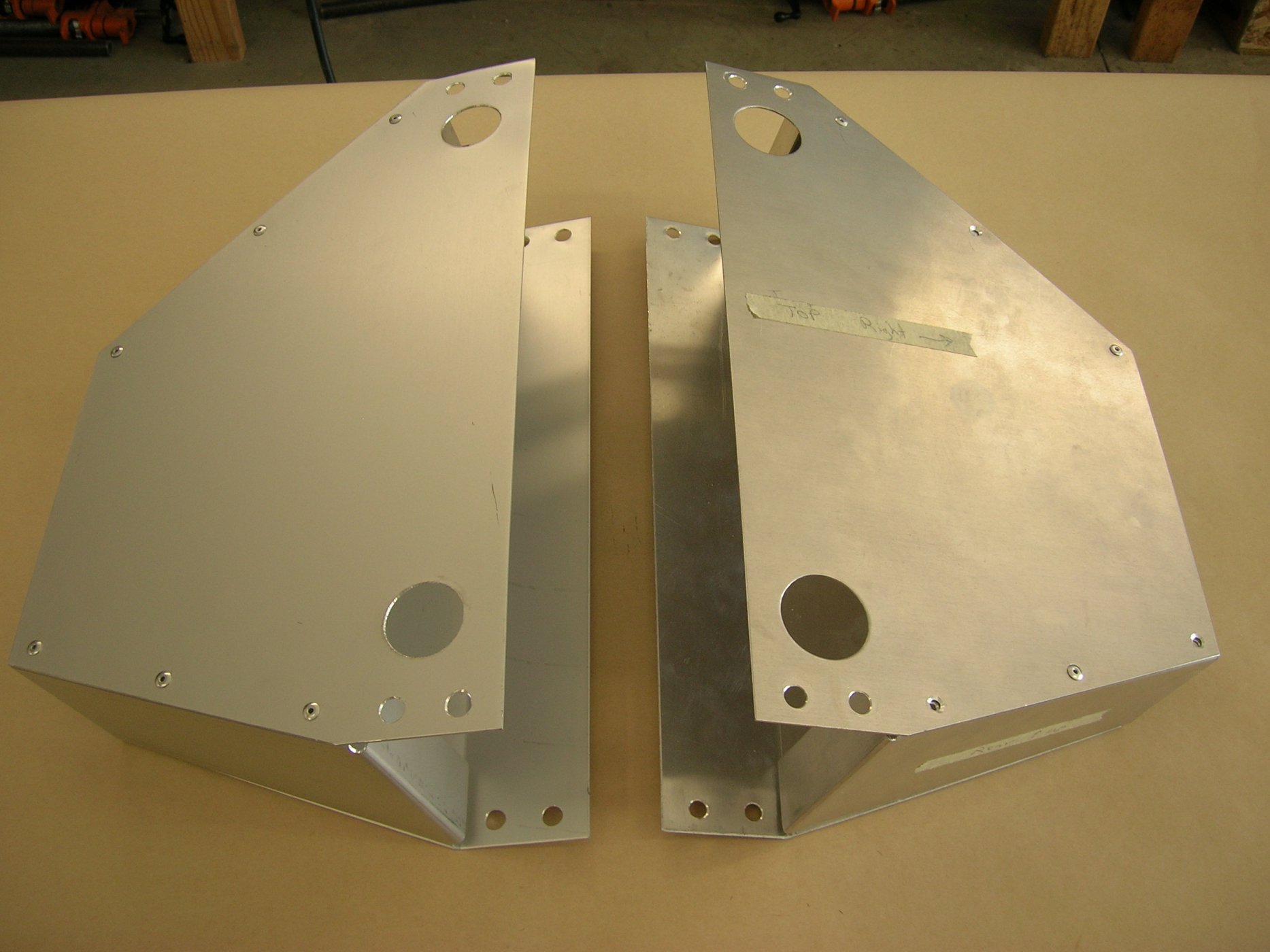

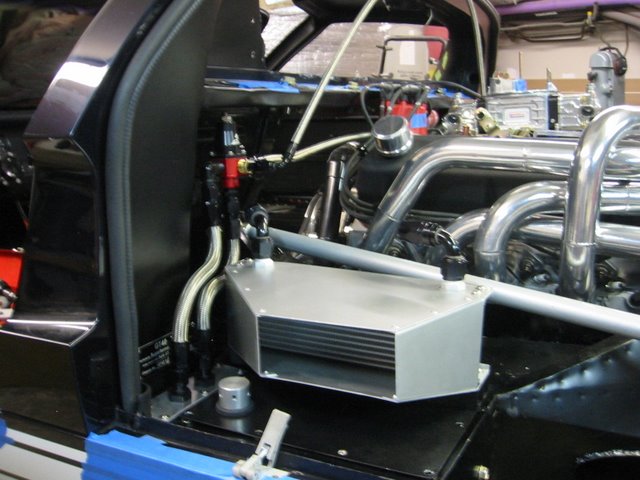

I think most people have figured this one out. I've done two engine installs. I helped Lynn Miner install his engine and I did my own. Lynn had installed his headers (collectors forward) and we had a tough time getting the engine in. The headers were always in the way. I left my headers off and it dropped right in. Because the oil filter was on the left had side of the engine I moved the oil cooler to that side of the car. Just mirrored all the sheet metal parts. I also used a Boss 302 oil cool engine adapter.
We have had several MK I owners do this. Much shorter oil lines which help the pressure. You can actually use the existing tin, just bend it 180 degrees.

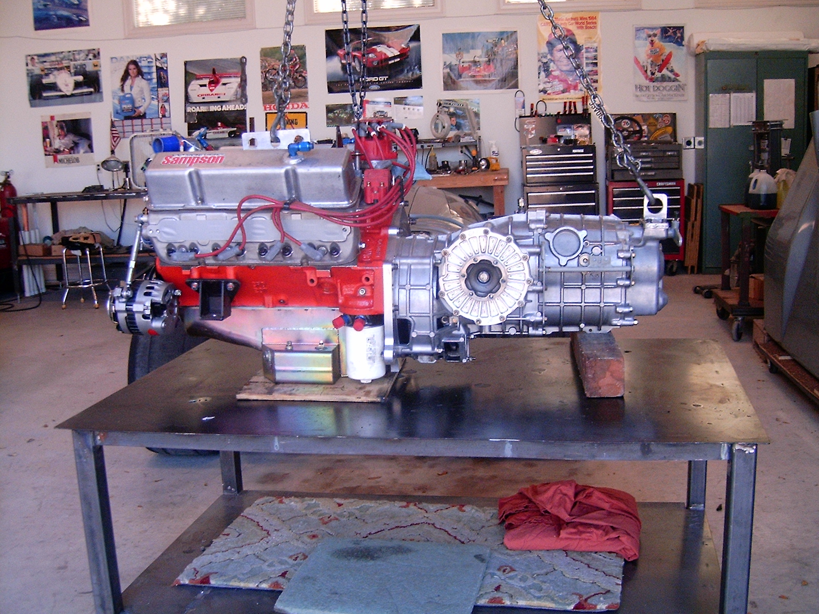

A couple of things. I have found that the power train is a lot easier to work on out of the car. I took mine out to change the alternator bracket to one I made myself. To make this really easy I installed a chain hoist in the garage and made a table so I could work on the powertrain as a unit. I have a nice carb plate to use as a lift point as well as a similar lift fixture for the gearbox. I can take out my powertrain in my SLC in a day 10am - 4 pm and a few beers alone. It makes it a fun hobby not an AH FUCK!!! crisis.

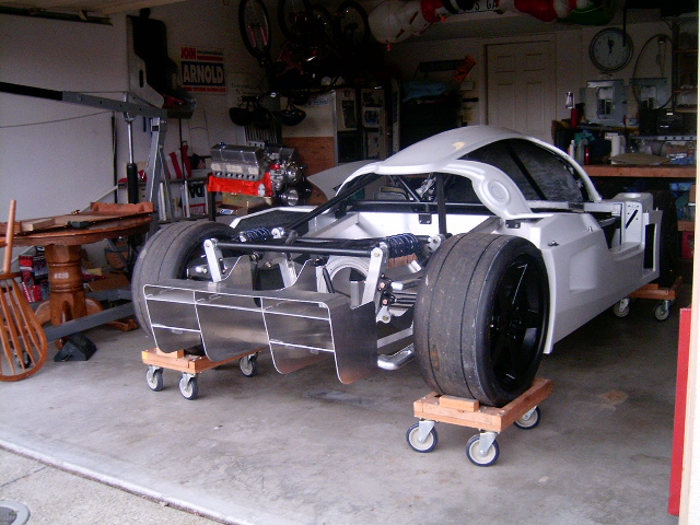

The second thing. Roll around's for the car. See pictures. If you do this stuff first you will use them forever. In good conscience, I have to say that I don't believe it is possible to install the powertrain once and never have to take it out again. It's just not gonna happen. Make the future as easy as you can. Plan the car so you can work on it alone without help. Build it so it can be disassembled. Every decision should keep this in mind. If you need a tool, buy it, You will be using it for the next 20 years. ANDdddd it will never be cheaper.

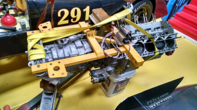

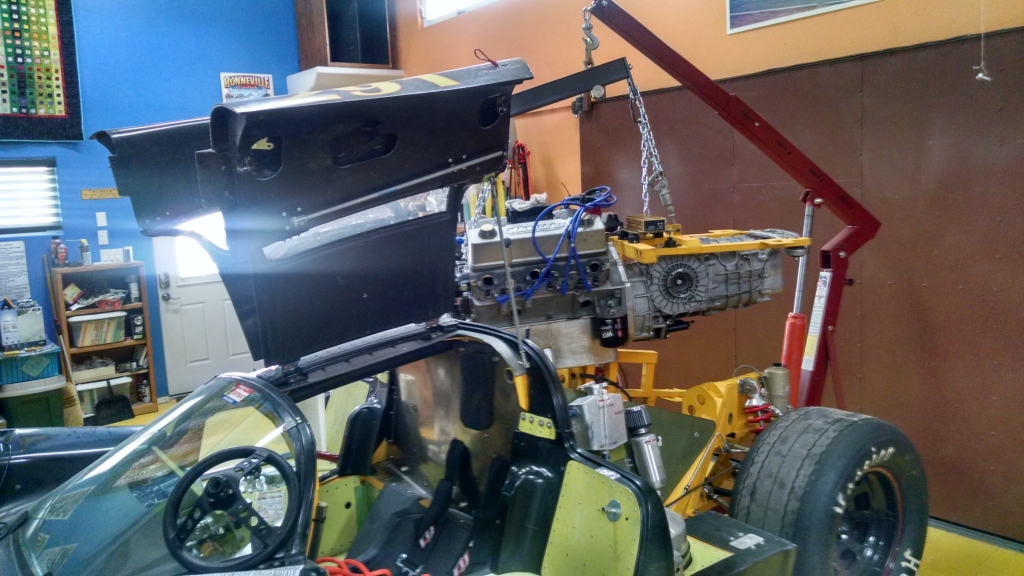

VERY sound advice, Howard. I did a similar thing on my black Mirage to make it as easy as possible to remove the engine and transaxle as one unit. I fabricated a simple cradle structure to allow it to be lifted by undoing a few bolts as well as coolant pipe & electrical connections and CV joint bolts. You can see the fabbed piece in this photo, it is the yellow cradle. This structure is a chassis member when it is bolted in place.
By looking at the position of the balance bar on the engine hoist you can get an idea of the weight of a complete Donovan 383 vs the Porsche G50.
