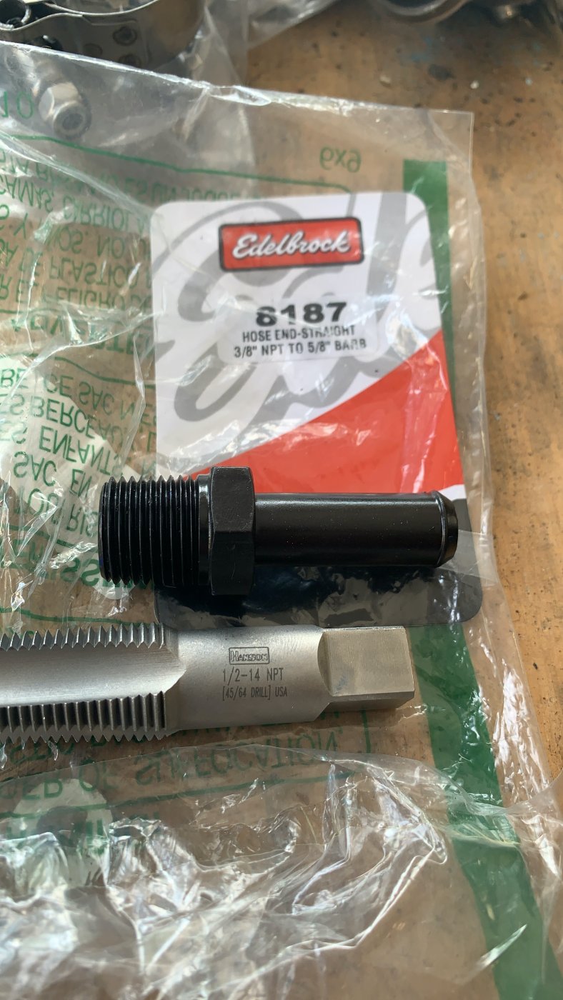

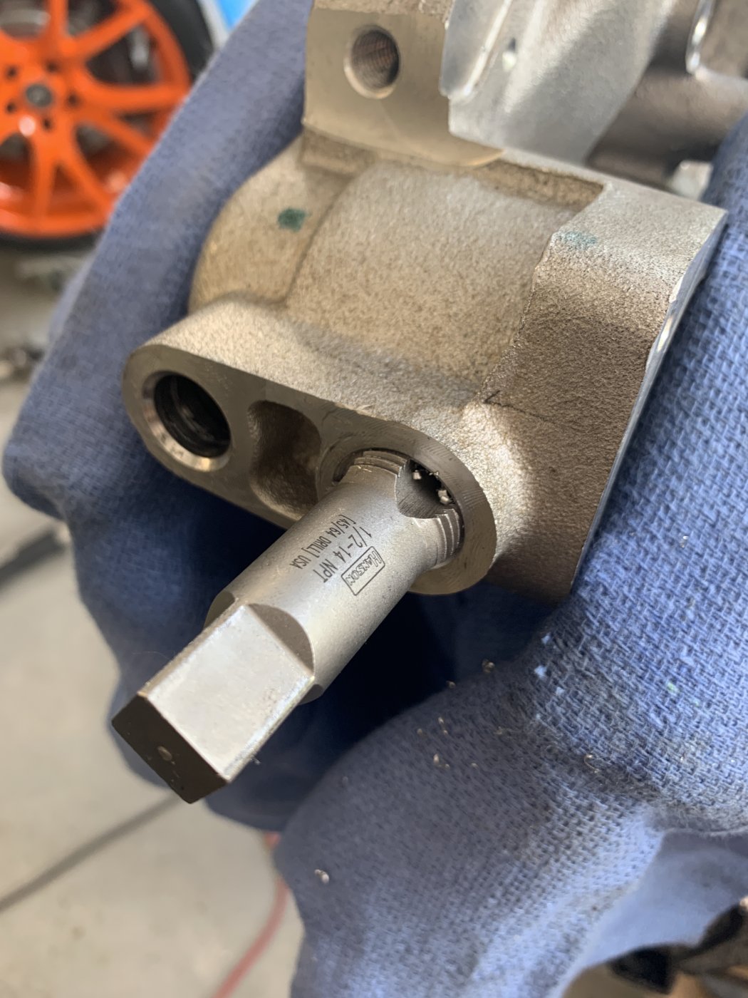

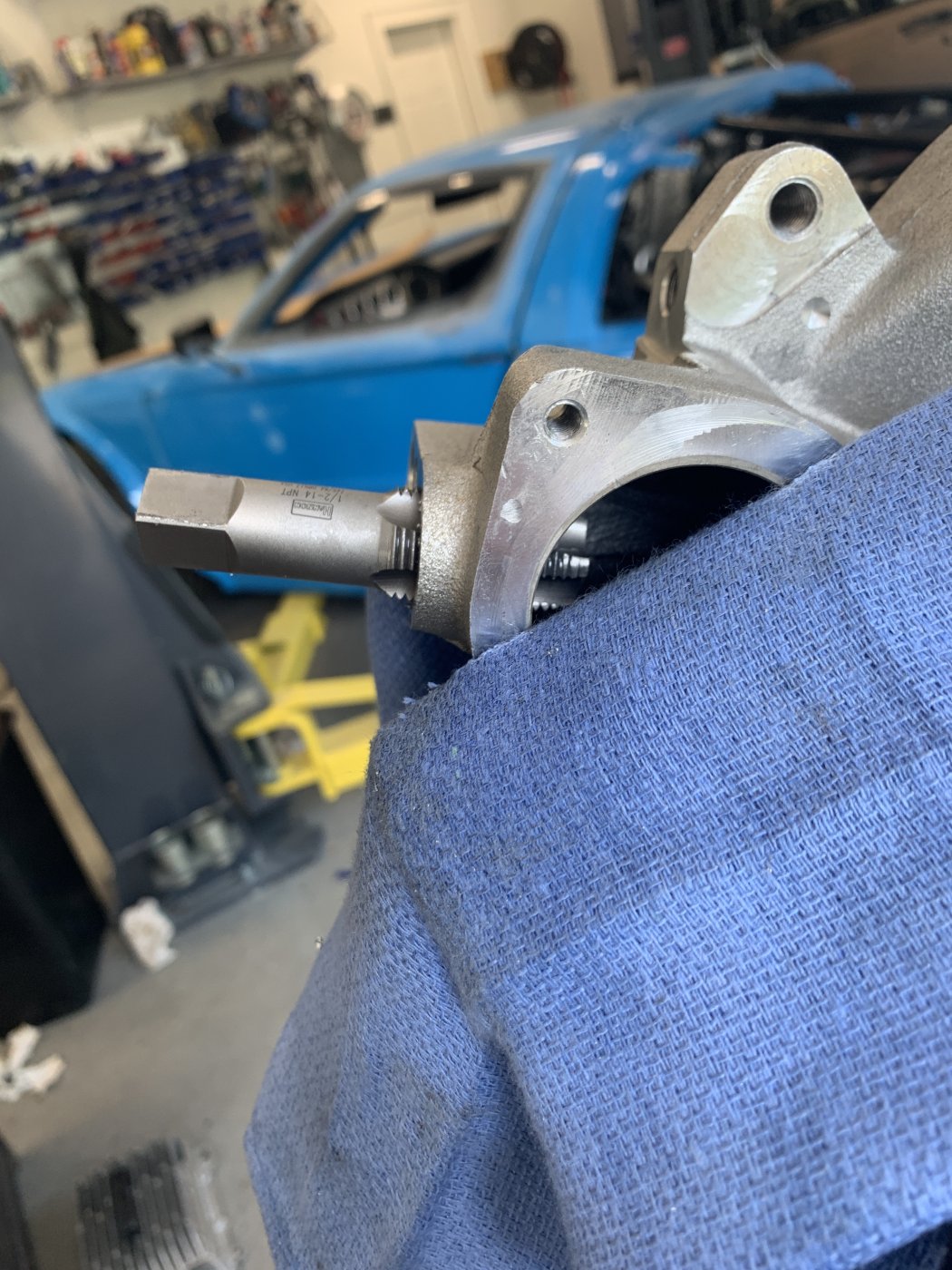

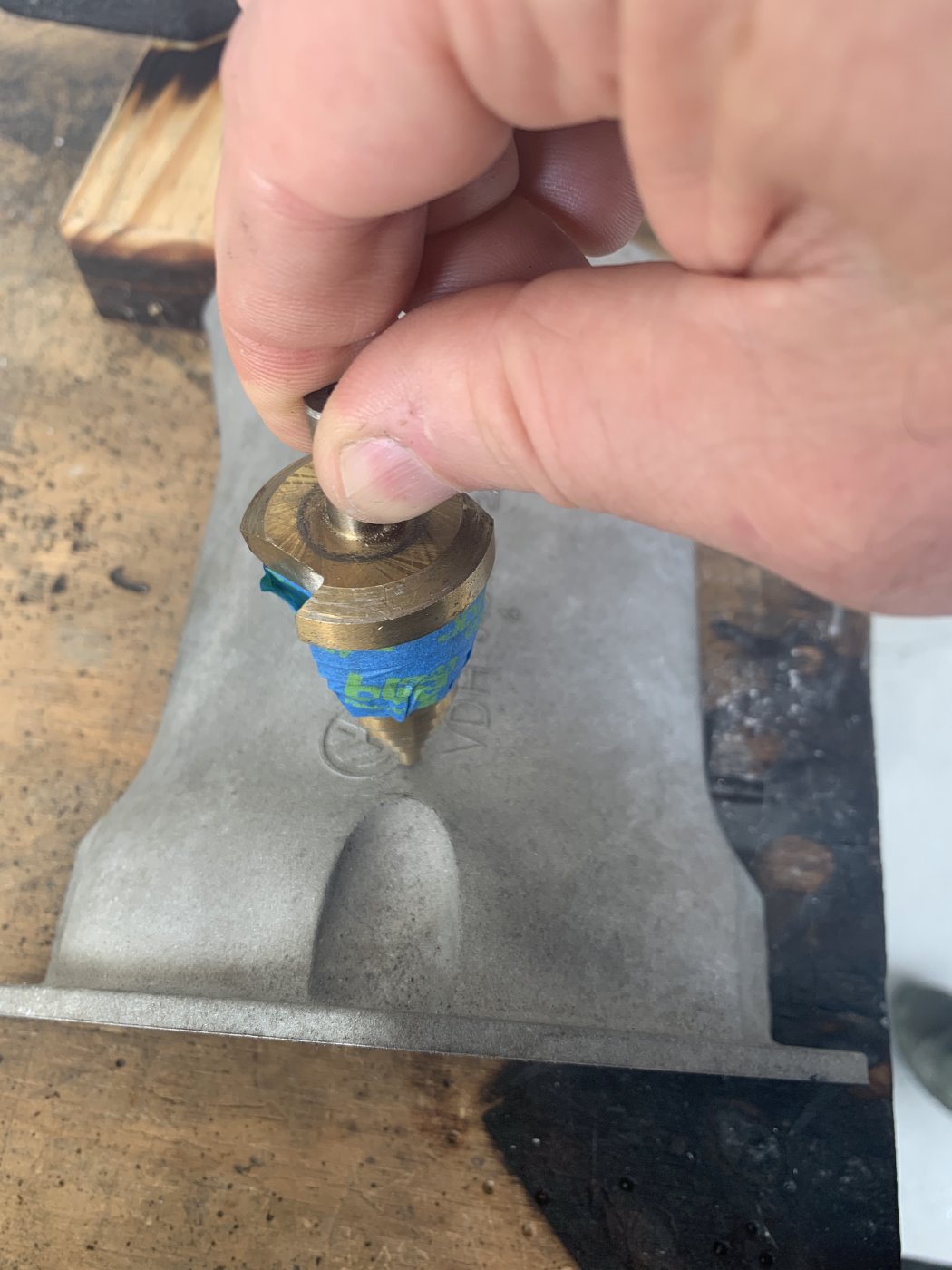

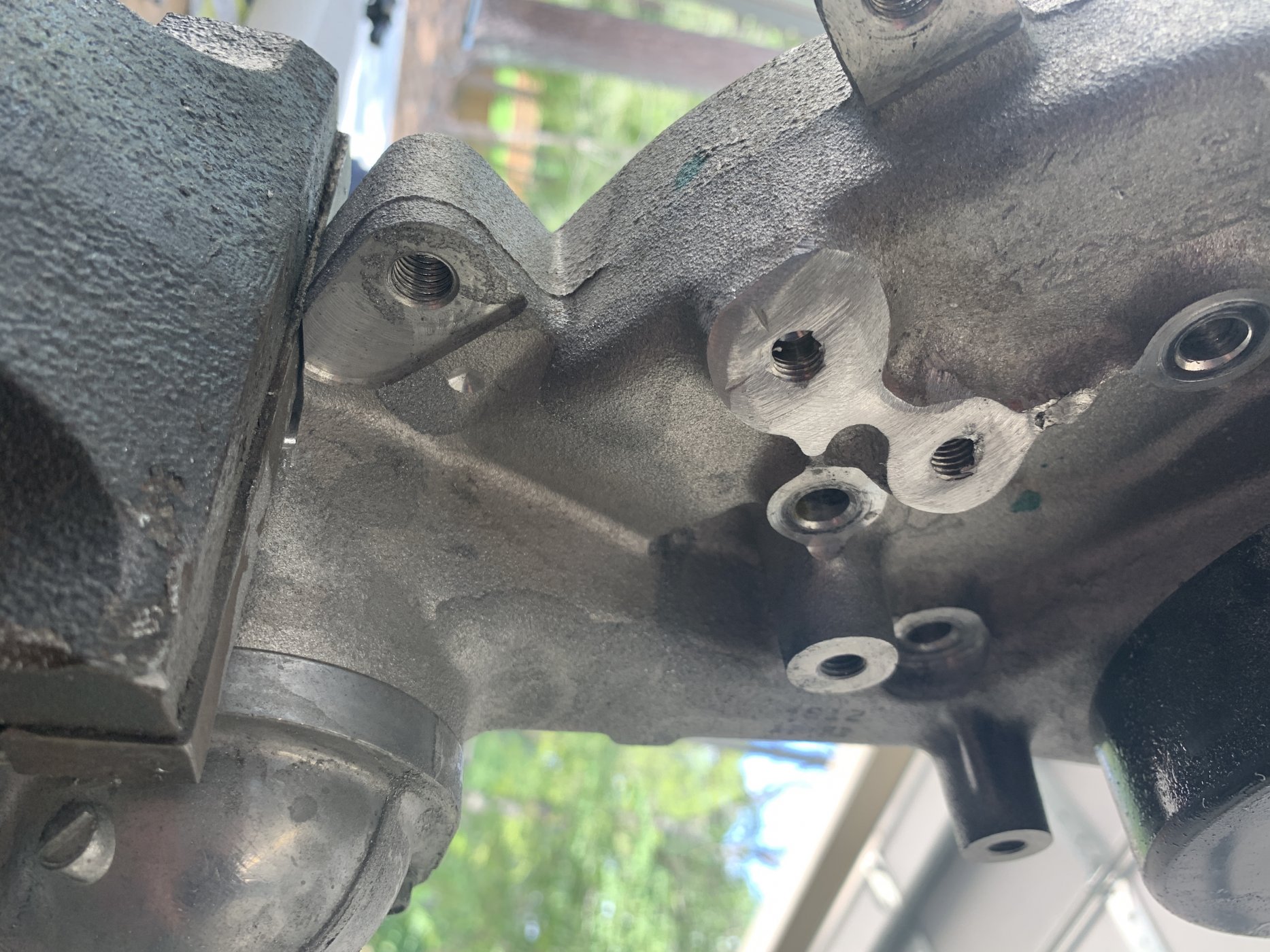

Tapping. Some folks do this for the looks. Others do it to have an NPT to -AN line for heater hose. Me: Just to stop a leak.
Summit Racing: You put a 1/2"-14NPT into a 3/8" bag. Shame on you.

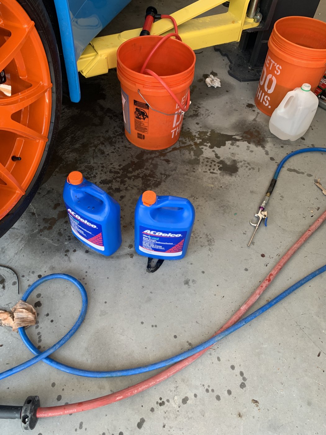

Dexcool. Lots of it. Probably holds 3.5 gallons. I think I have been through 8 gallons so far with different leaks/spills.
Tapping in until all threads of tap were inside the pump. This left under an 1/4" of thread showing outside the water pump.
For the 3/8" tap, I just went until threads cut all the way into the press in area. Any further and the smaller Dorman fitting I purchased to replace the wrong size sent by Summit (Edelbrock) would bottom out before sealing.

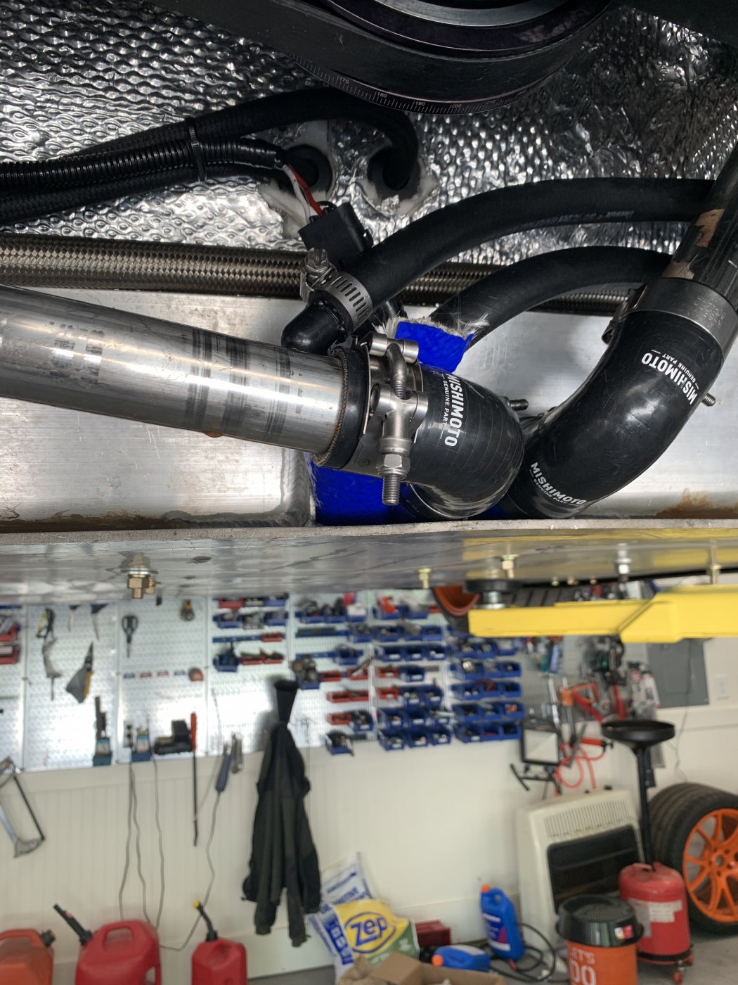

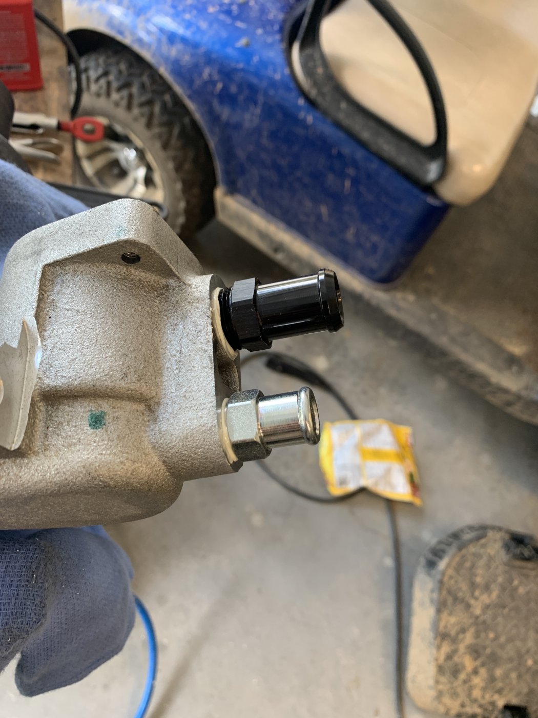

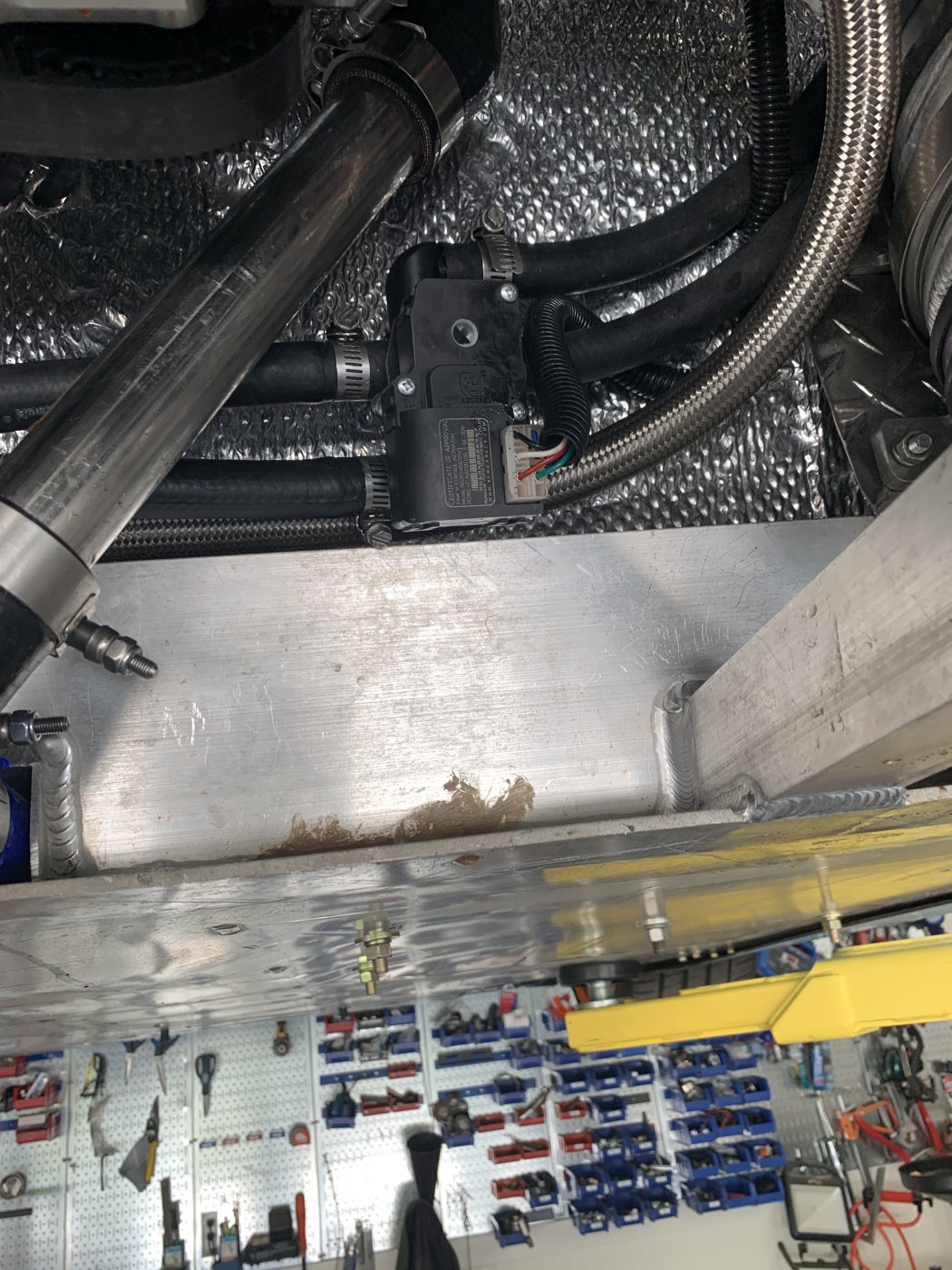

Under my gas tank is only the coolant pipes, heater hoses, and fuel sender wires. Fuel lines come out above this in the picture. It was still snug for the heater hoses so I padded them with the high temp slip on cover.
I had the Chevys of the 40's bypass valve mounted on a bracket. Now it is zip-tied up to the oil line with a stainless steel zip-tie.
Fittings in place with Loctite 567 thread sealant.
Fired it up and no obvious leaks yet. Gotta cycle it and burp it so it stays at 200 at idle.

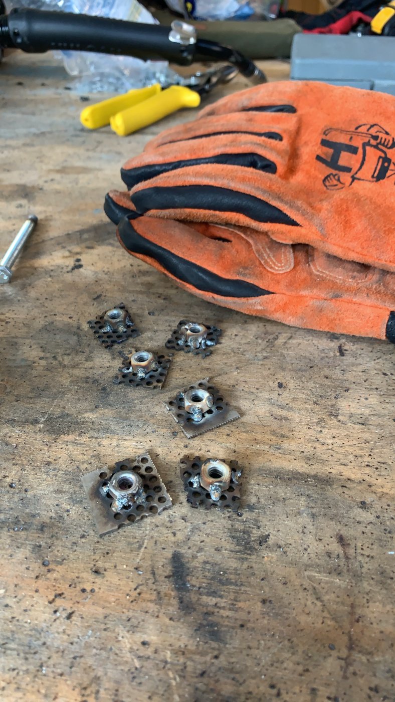

Also going to fab up mounts for mesh by welding nuts to perforated steel sheet and using West Marine epoxy/resin. Pics to follow.

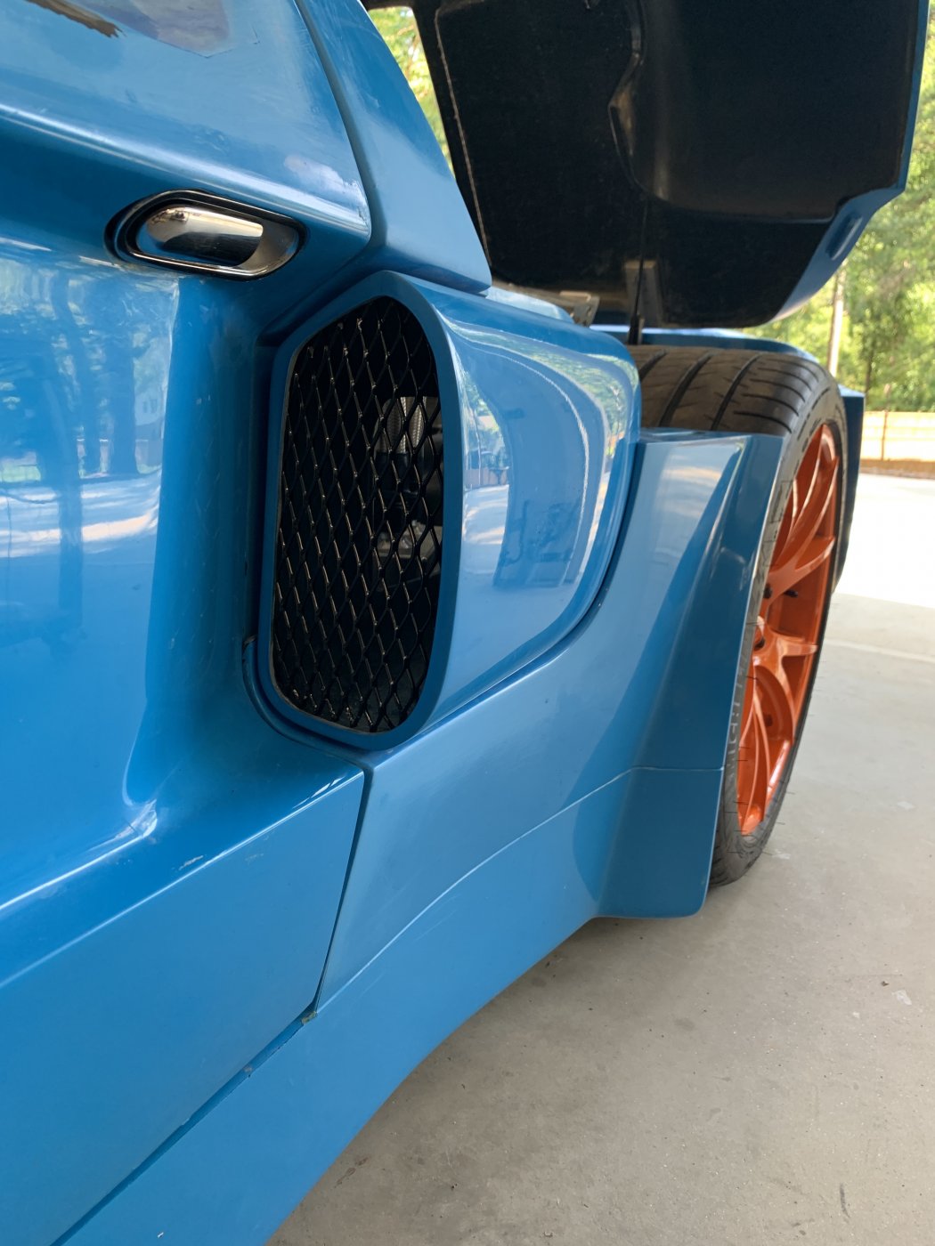

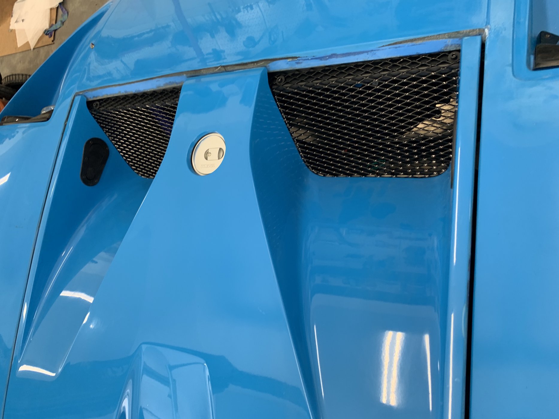

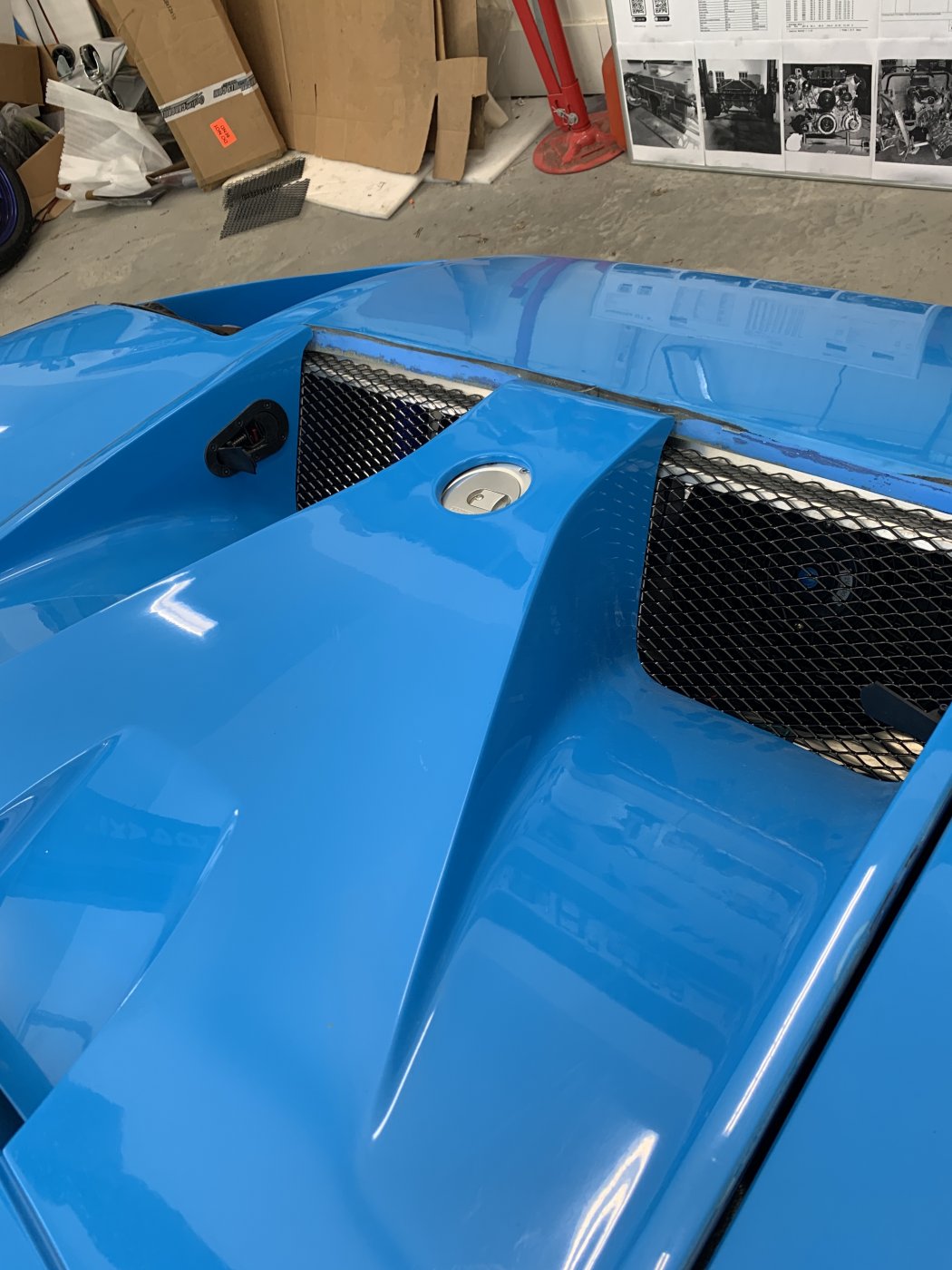

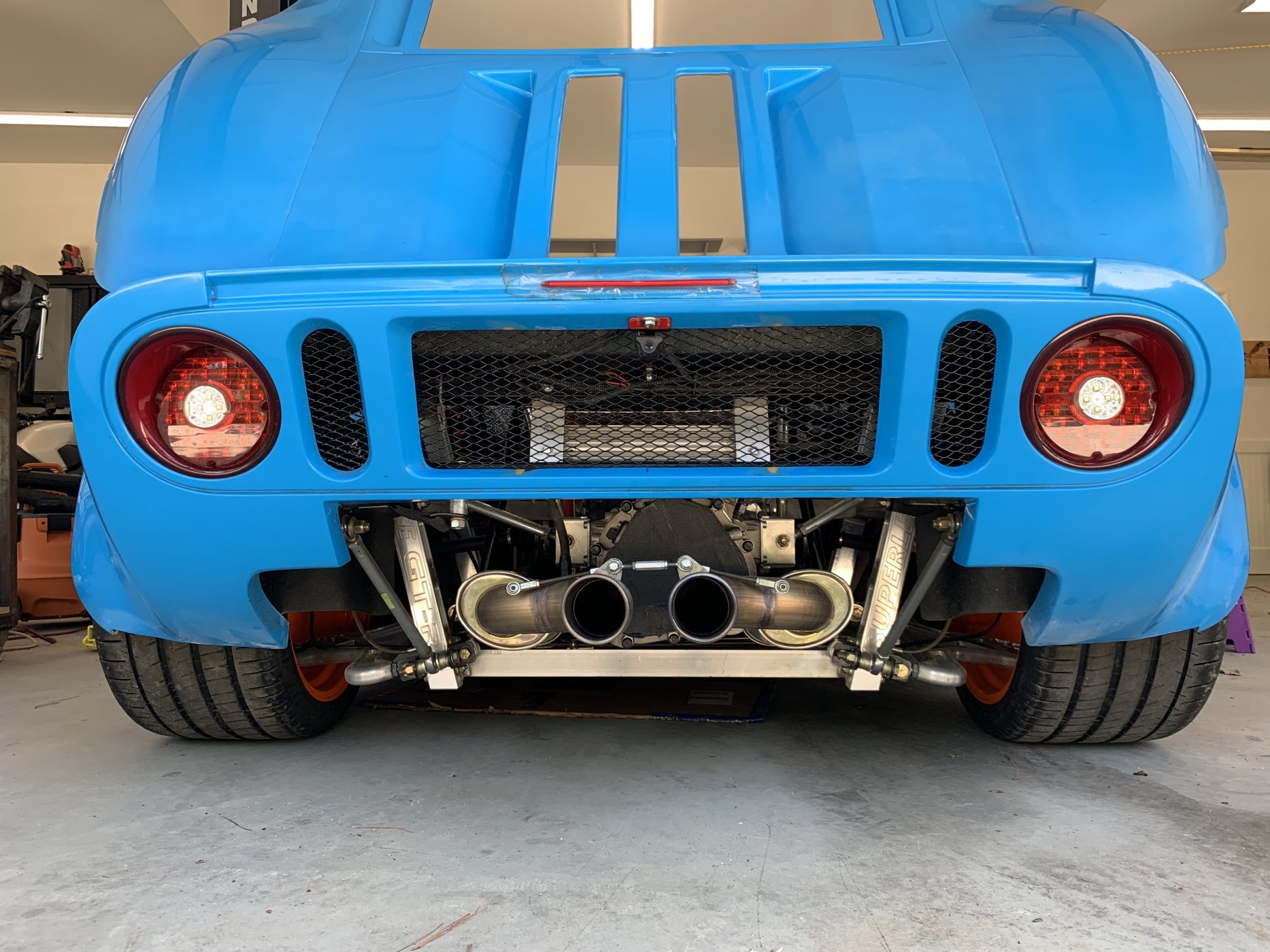

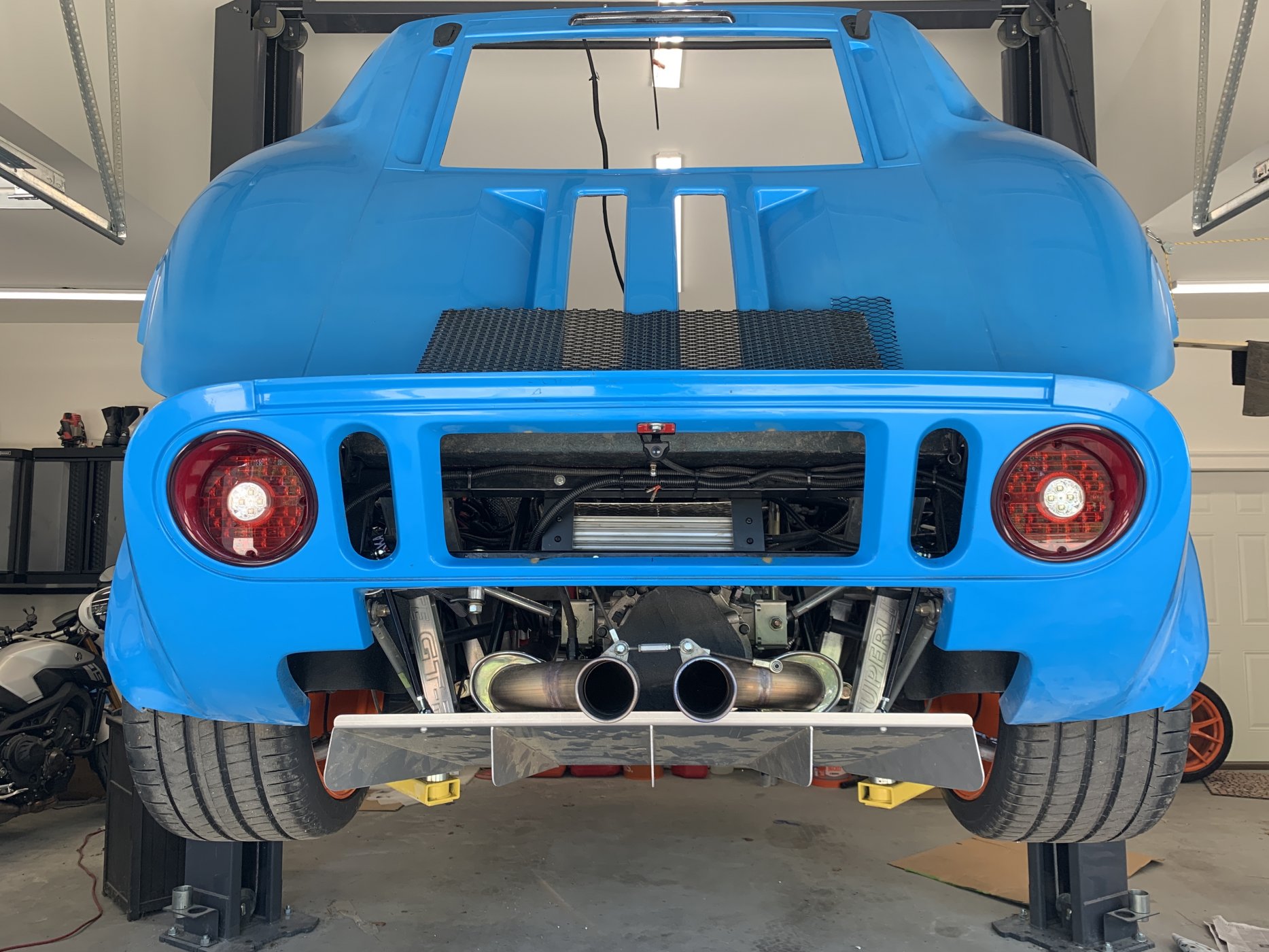

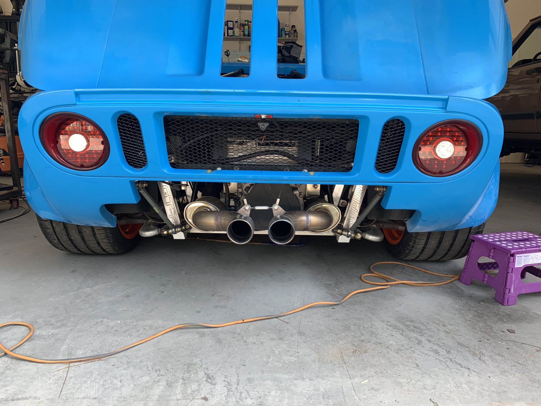

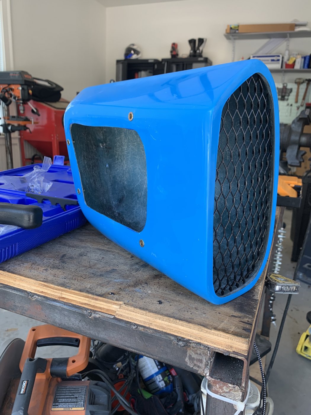

Started mesh. Much easier than I thought it would be. Make it too big, then trim. Used www.customcargrills.com Diamond XXL in black.
Just mocked in. Will get painted before I install mesh. Ordered more rivnuts for front mesh and painted silver aluminum flat black. Made up some bonded fasteners because these were not available locally. http://rotaloc.com/products/bonding_fasteners/
Mine are not as pretty, but lots of fun to do. And since they go under epoxy on interior panels to never be seen again....
Will need to sand an 1/8" off the removable boot so once painted it does not rub off on the mesh.
Used my last rivnuts for the sidepods. They sure get easier to install after a bag or two.
Help: What kind of paint should I use for the inside of side pods and on inside of roof?

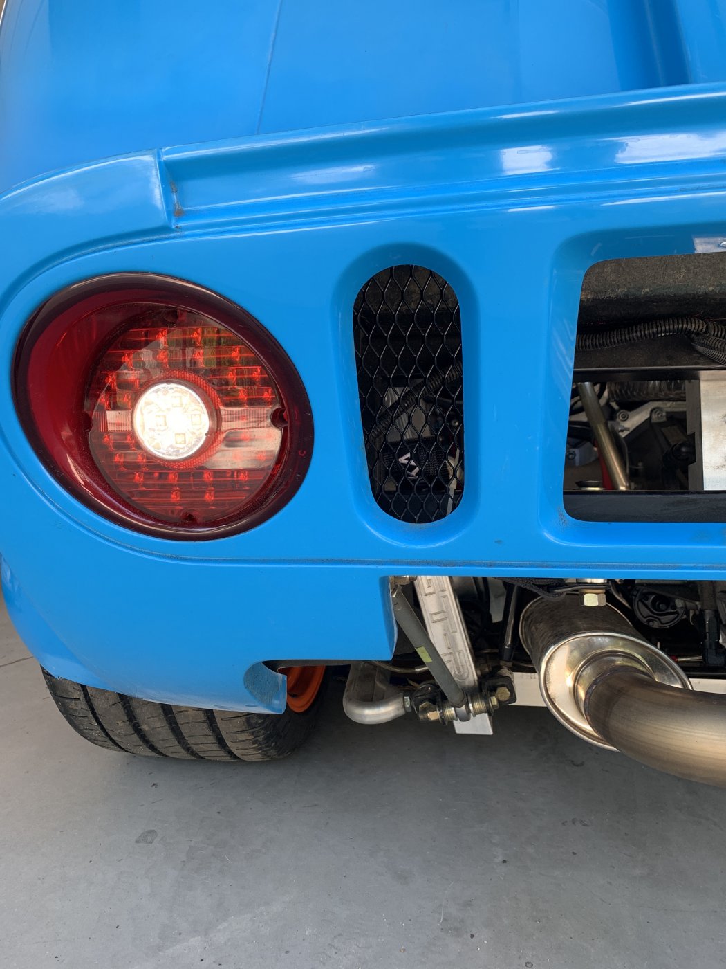

Gotta clean up the rear. H said to get a Suburban 3rd brake light and mount over the rear glass. On order. Oil cooler mounted no sprayed flat black. Camera install will be different as well. Bolt will be gone and maybe a custom fiberglass pod. Currently it gives good picture, but tiny screws hold the angle and will vibrate loose. Red is adhesive cover and could just epoxy to topside of piece it is bolted to.

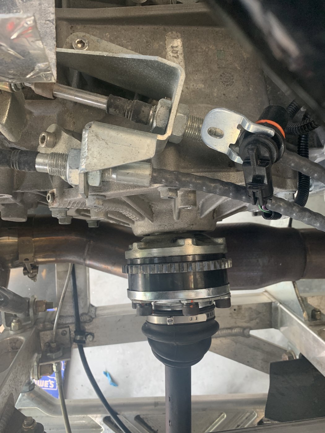

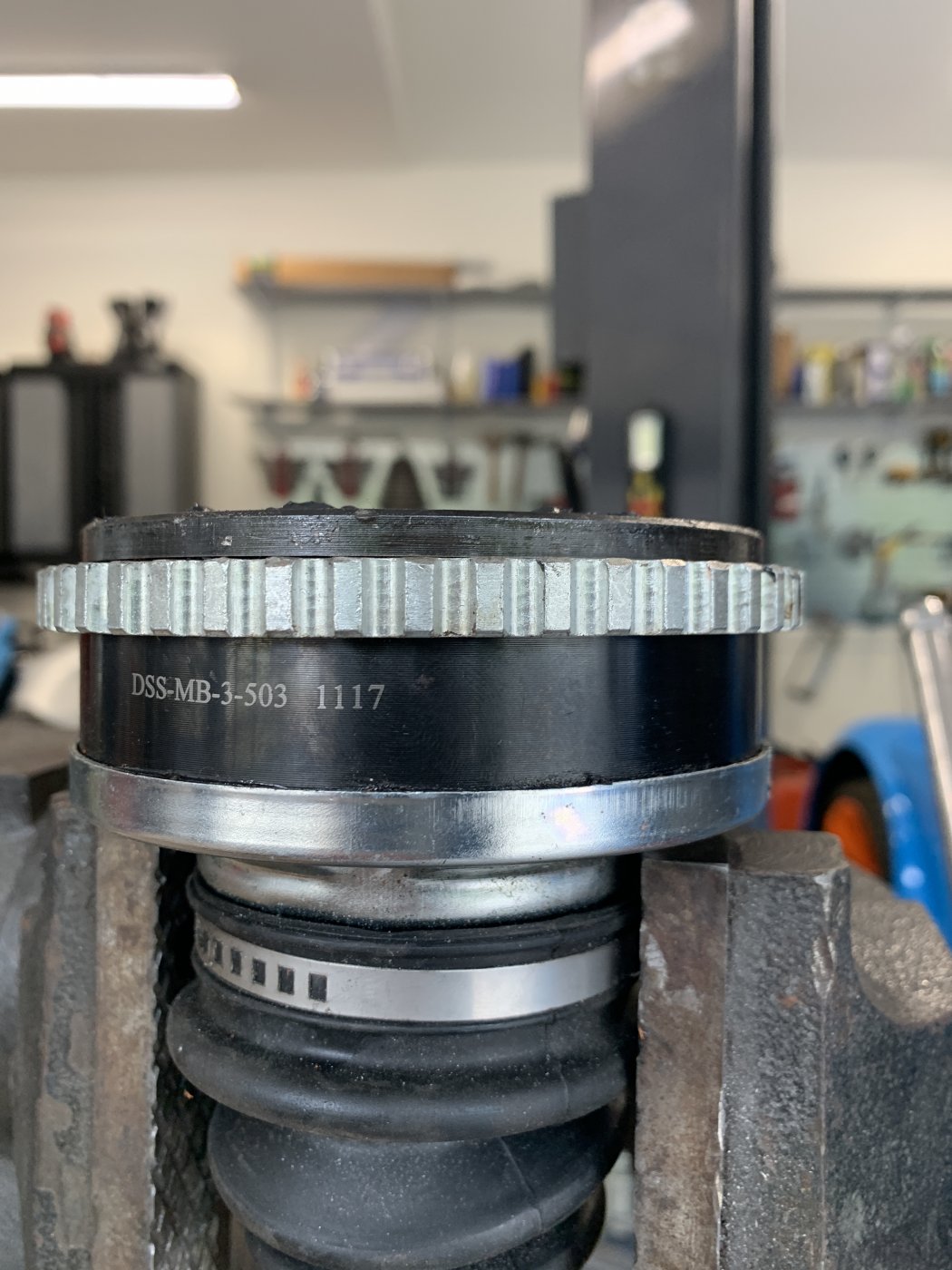

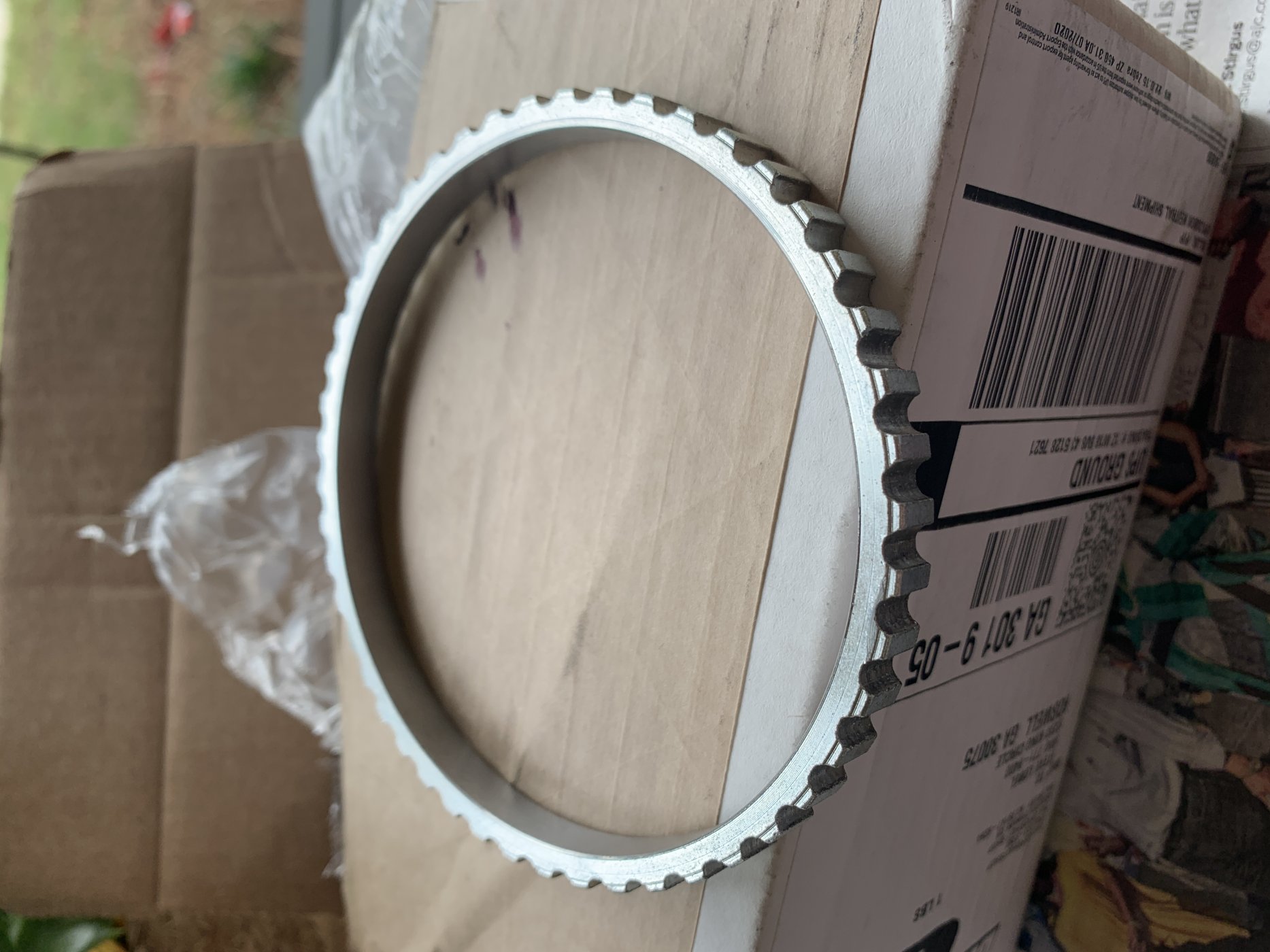

This is the ring from driveshaft shop. It looks like I remove the half shaft and gently clamp it into a vice vertically, with the dark steel part at the top.
Heat up the ring until a bluish hue, and drop it on. Then use aluminum drift if needed to ensure it is past the mating surface.
If I am wrong, let me know. Weekend project.
Steven Lobel
Baked on cookie sheet at 425 for 30 min. Needs to be hotter. I used MAP torch for two minutes and it dropped right on. Drifted it down with hammer and steel drift.

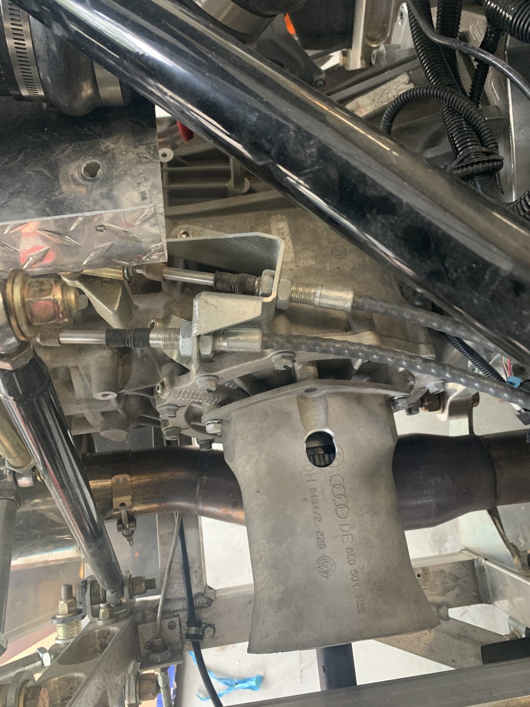

Marked and measured location for hole in heat shield.
Shaft remounted and torqued to 57 ft/lbs. The tone ring / reluctor can go anywhere from the edge of the CV to the grease cap. It's wherever you mount the bracket that determines where the ring goes or vice versa.
A little trial and error with nuts and bolts to get the heat shield mounted and the bracket installed. I used one washer under the angle bracket and over the sensor bracket to get it just under 1/4" from reluctor ring.
