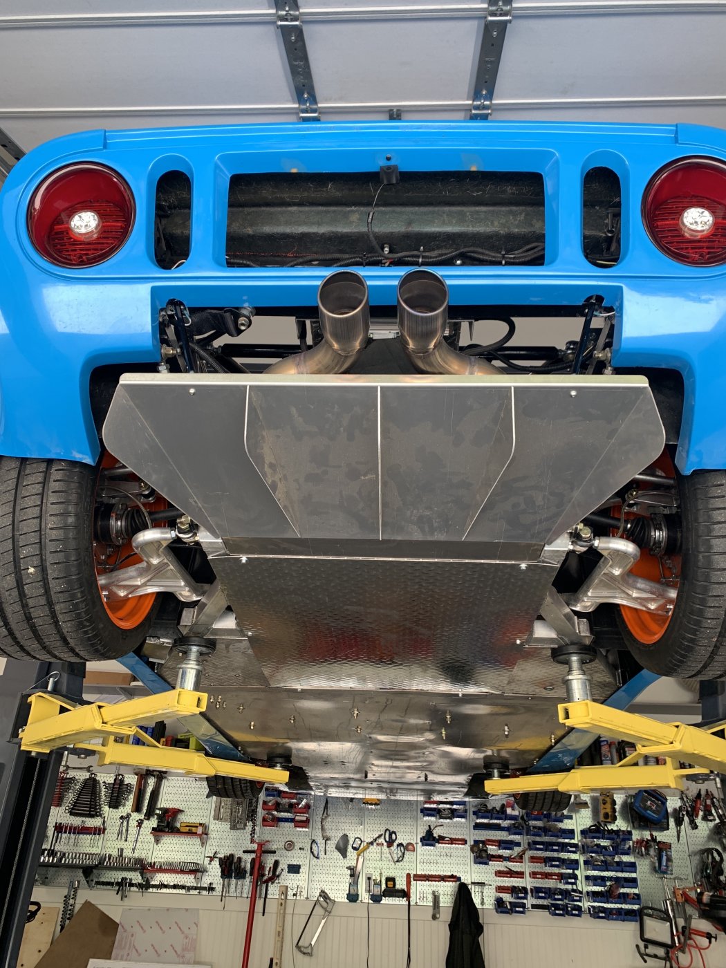

Made an engine floor close-out panel.

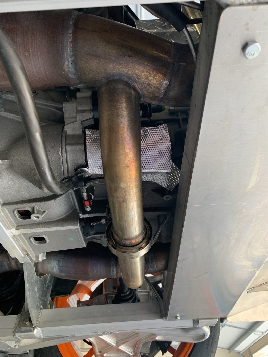

Put a heat shield over the starter. Hope to eliminate heat soak and locking up.

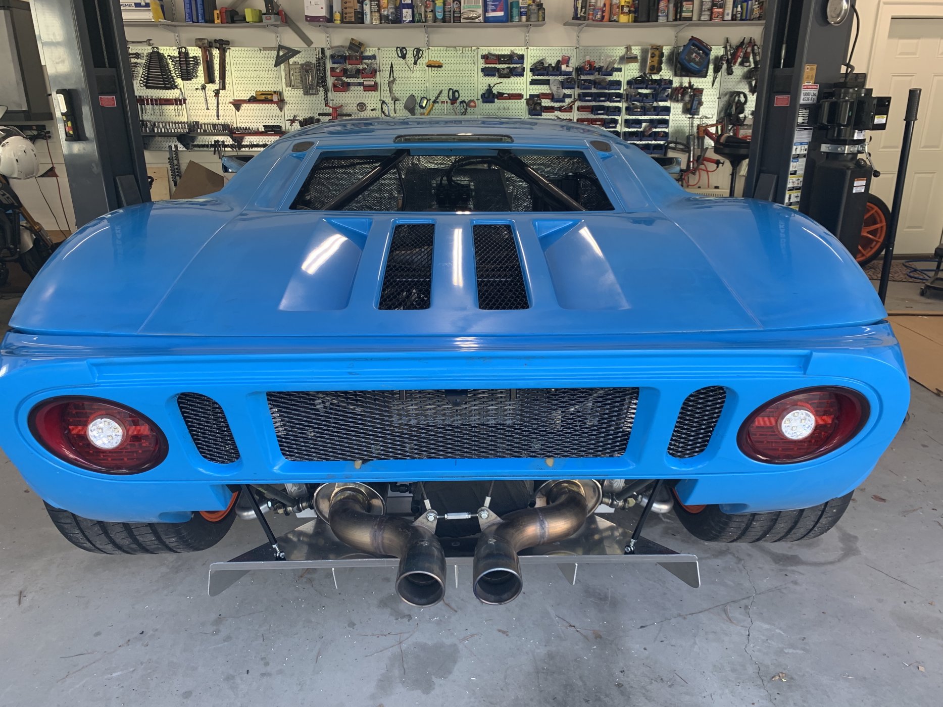

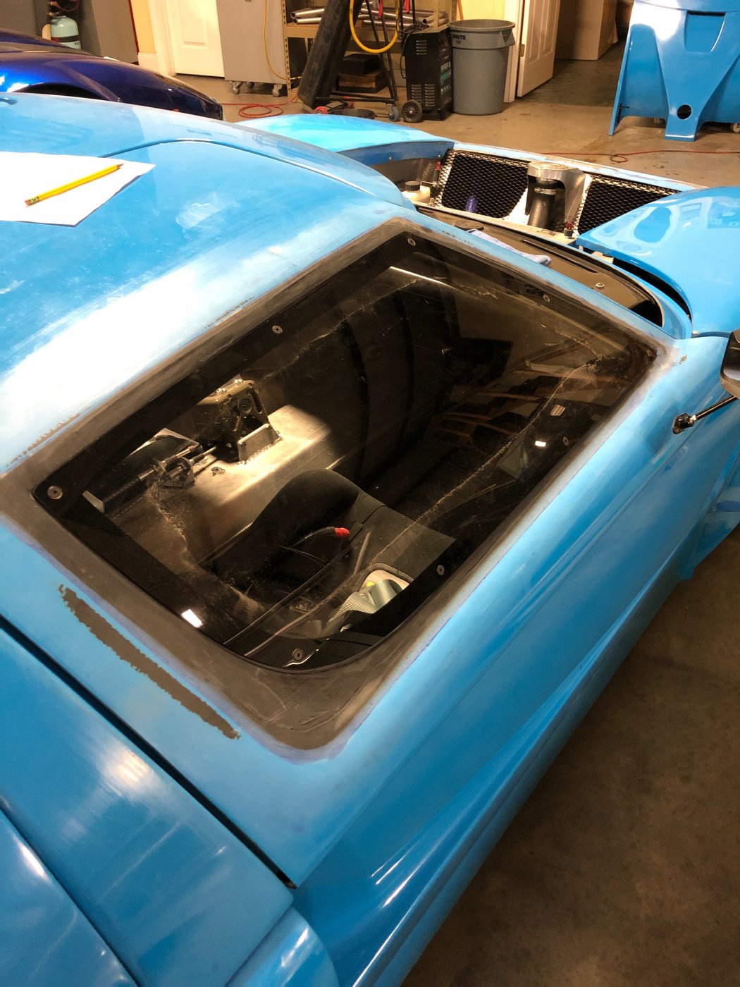

Took the rear panel and deck lid off today. Going to bond in some tabs for mesh. Cleaned up the wiring for the rear so the panels can be unplugged and removed easily. Epoxied in front signals. Need to paint the inside of the side pods this week and figure out how to secure mesh in there. Will likely mix some thick epoxy and glue it all up. Pics to follow. It feels like a big step back taking so much of the car apart, but it gets so much easier doing tit the 2nd, 3rd, 10th time. :D
Steven Lobel

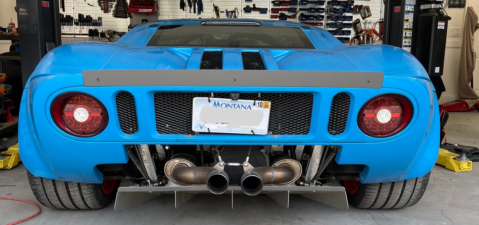

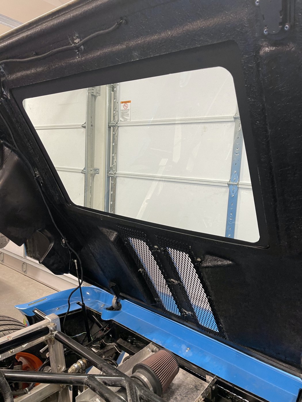

Got the mesh done on the rear as well as re-did wiring. I have the rear panel now easily removable with a pair of 4 wire trailer harnesses and 2 bullet connectors. Added the rear lid mesh. Will ask H to add the rear glass.

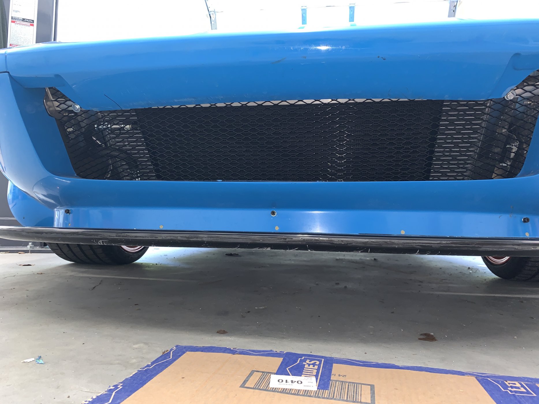

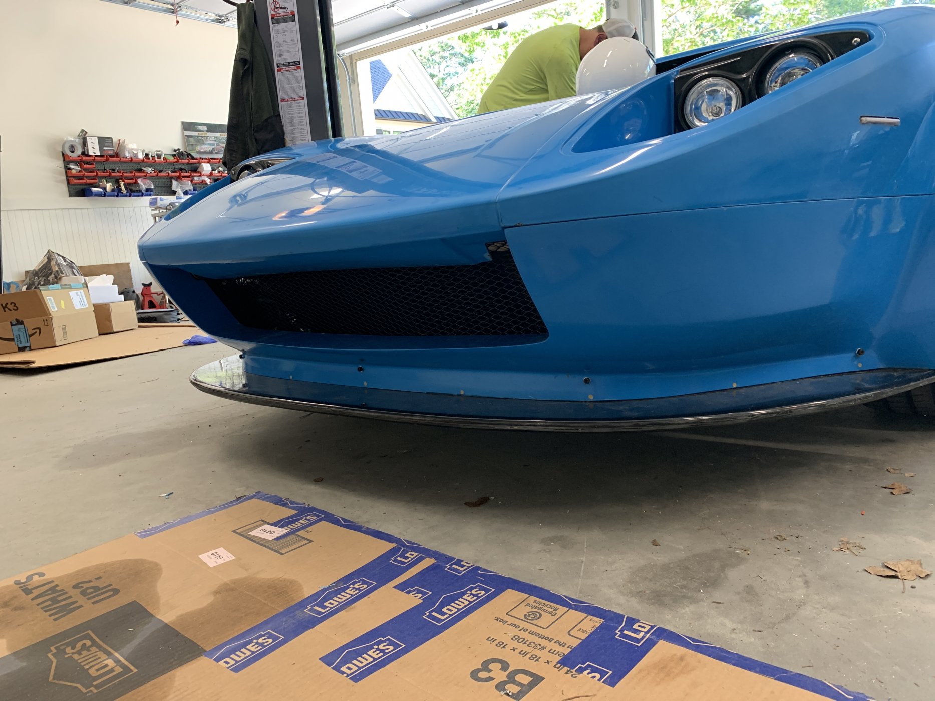

Front mesh easier than expected. Had flat surfaces for drilling and rivnuts.

Running smoothly. Mostly done except for body, paint, trim. Even able to modify passenger seat for my 6'3" buddy so he can sit in with a helmet and only scrunch down a little.

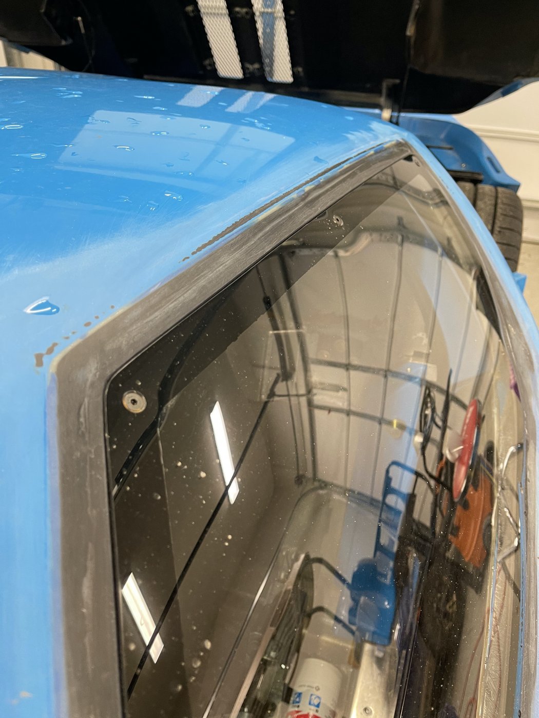

Getting final (hopefully) prep done before paint. Lucky to have H-Craft nearby to mount glass and do the special touches (fix my mistakes).

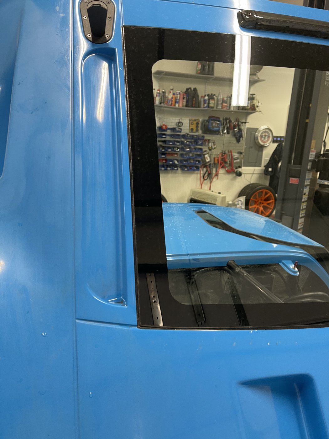

8 hex head screws to hold side windows in place. Removable easily.

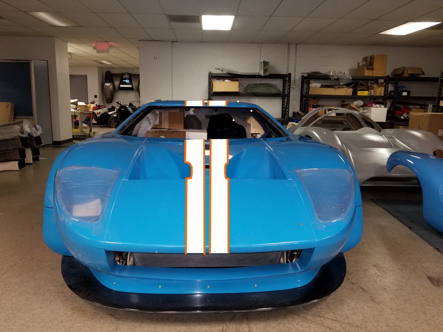

Car is for track use and C&O. Interior is seats and harnesses. No gadgets, no comforts other than phone holder mounted to roll bar for OBD2 feedback. Almost time for prep and paint. Or plastidip, or wrap?
Suggestions? Want it to look nice but not concours. It will be on track with hot tires. Want to keep a bright blue and tangerine and add the stripes. Single stripe, dual? White or tangerine?

Sorry Steve, I don’t have suggestions on the paint. But, what are your plans for the Lola T70 in the background, if you don’t mind me asking?

Car has been getting some little stuff done with H. New front tow hook in center of air dam.
Glass rear windshield and windshield install. AC charged. Side windows removable and installed. Working kill switch. Gurney flapped.

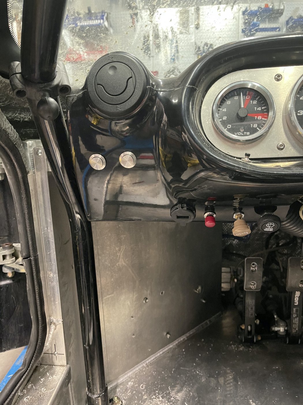

I hated the Speedway turn signal I had mounted to the roll bar. It was plastic junk, but it worked (except hazard switch- such a POS it worked occasionally). Went with Signal dynamics motorcycle switch and some Amazon momentary buttons. Much better and all works well.
Steve,
How about turning that into a gulf livery scheme but with your colors?
Would look pretty slick I think.
