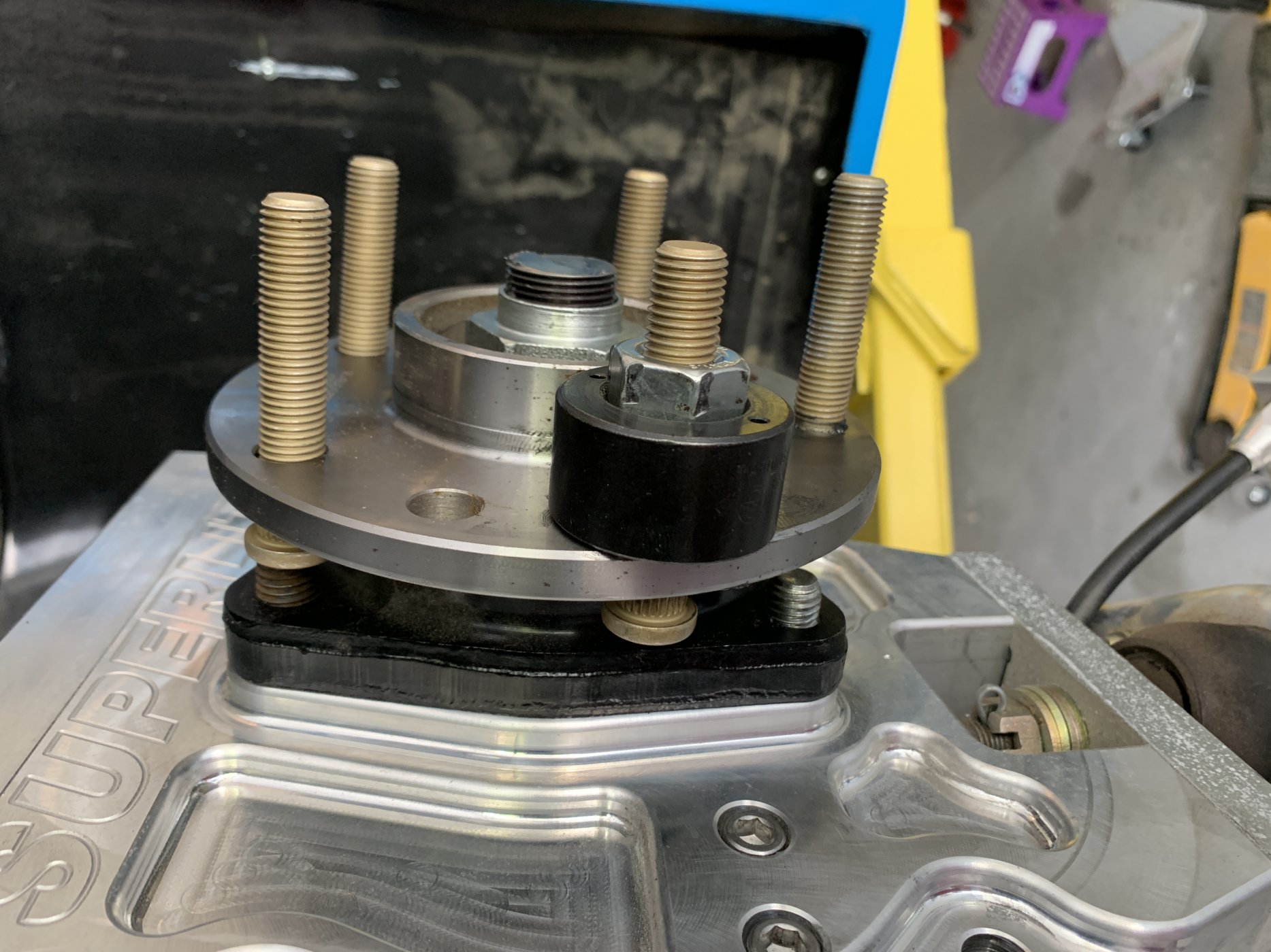

They come with new clamps but I like ss zip ties over the square hat tie that needs special tool.
Steven Lobel
A little grease on the stud, a little on the hub.
Great tool.
Joel K
wow, that is just too easy, wish I saw this before I went and got a small press. I used the same ARP studs but they seemed to need a lot of force to install them. Nice job Steve.

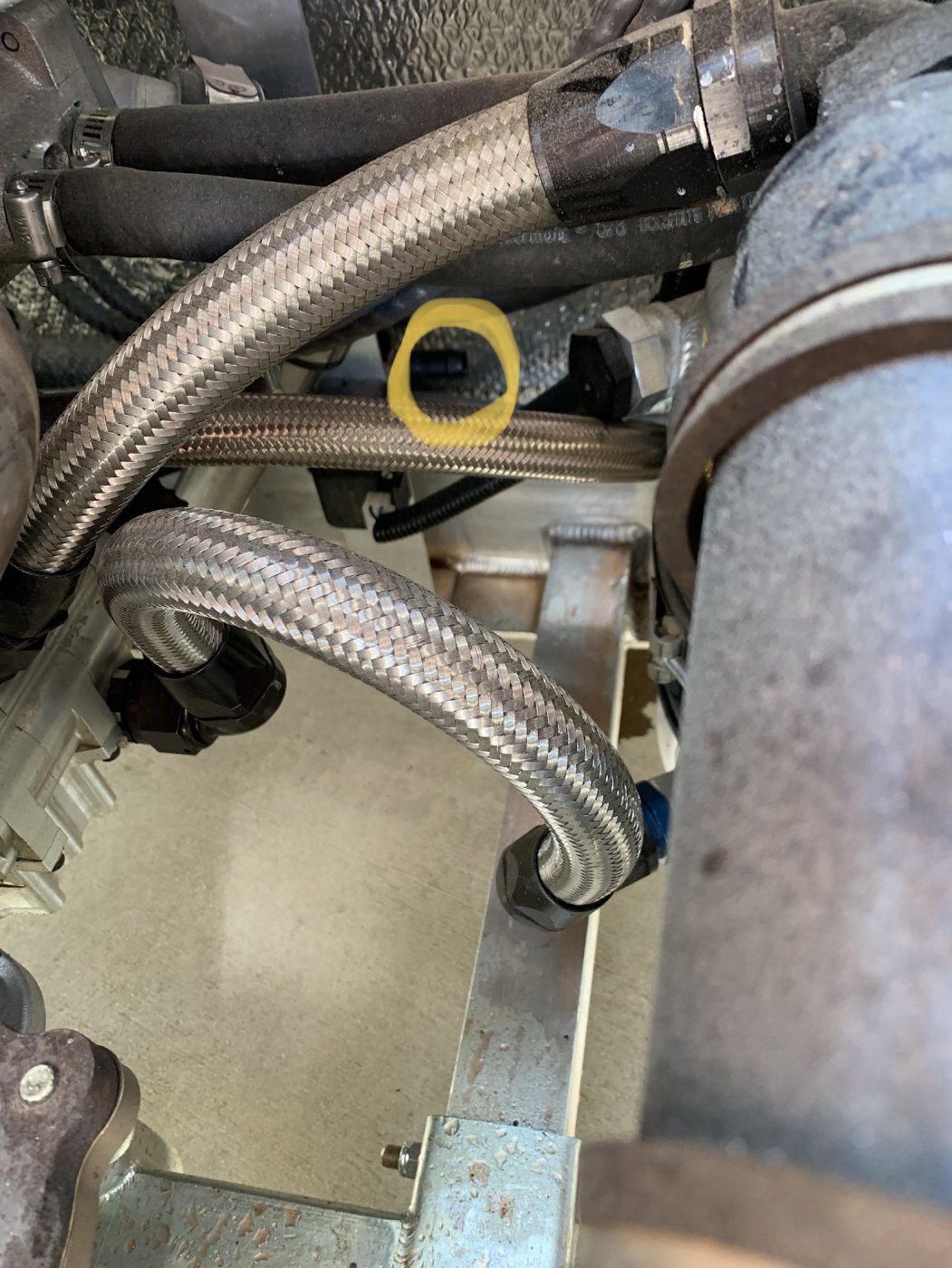

quick shake down run yesterday ended with smoke. Made it home. Coolant leak at radiator due to T-clamp 48-54mm replaced with 44-48mm. And I added hose clamps on the input side of my heater bypass valve. Oops.
