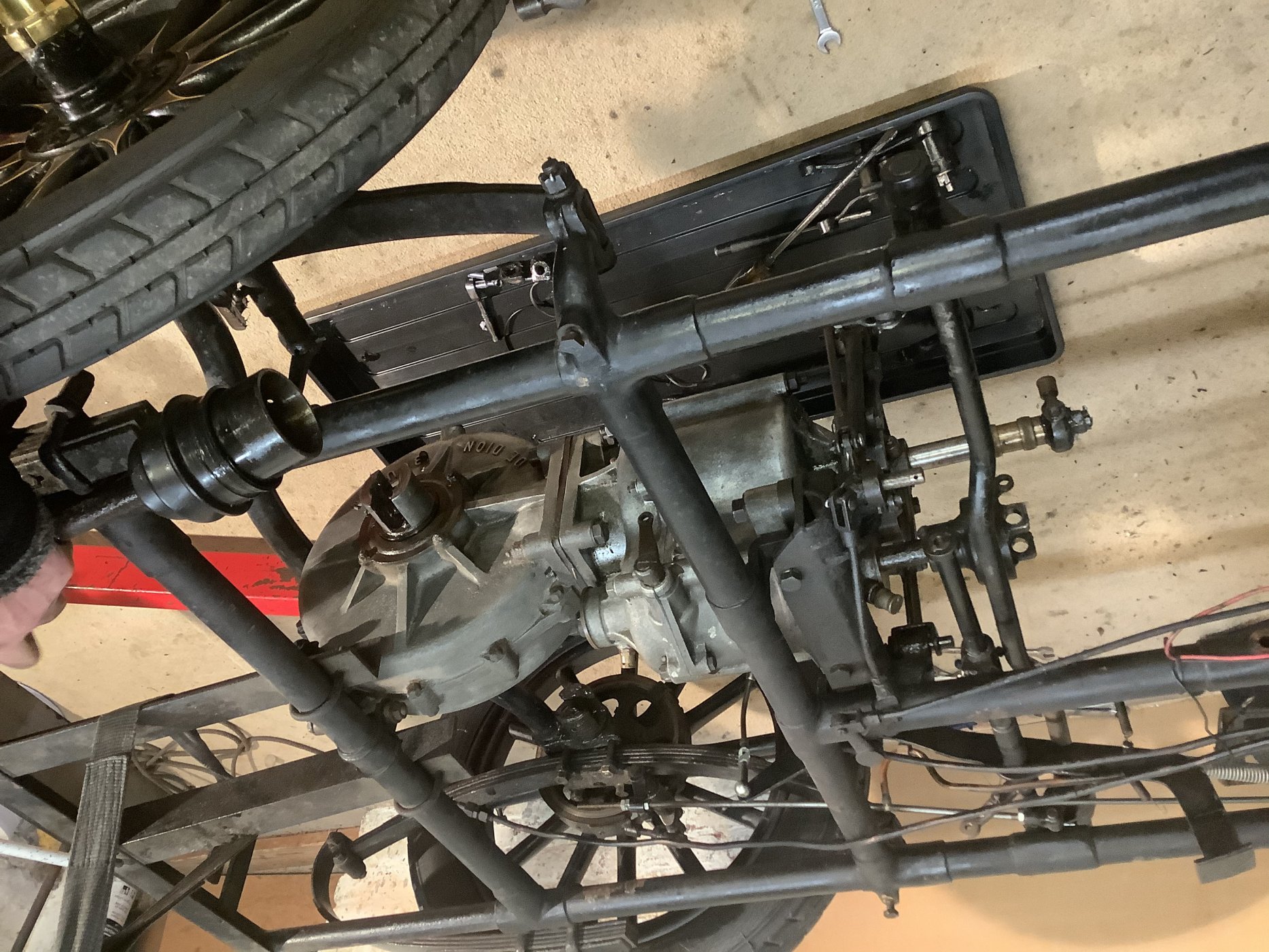

I took this transaxle out of a car today, we know it can withstand 6 horsepower, so could be considered by some builders. Dated 1903
