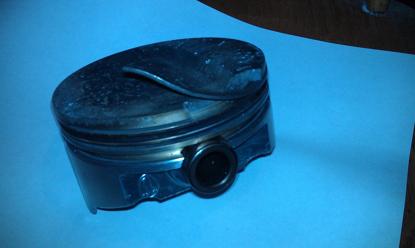

Re. Ceramic piston coatings. They also cause heat to migrate to the outside of the top of the piston, then down the sides to the top ring. It expands considerably which can be cata$trophic. Don't ask me how I know... Use only under adult supervision.
