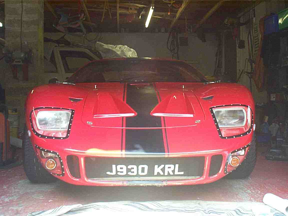

GT40 Australia built a bracket for me to mount my plate just as you described(at no extra charge! /ubbthreads/images/graemlins/laugh.gif) If you'd like a detailed photo, let me know.
