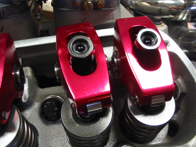

Wayne:
Might the problem be a faulty pushrod guide plate? One of the guideplates on my engine had an incorrect size opening. It was clearly the wrong plate and indeed had different markings than all the others. See the picture below.
I reported the problem to Lloyd and E mailed him pictures. He sent me a replacement along with installation directions within a week. Easy fix. No charge. Problem solved.
I did later, as a separate matter, upgrade to the new rocker arms, but that was not the cause of the problem noted in the picture.

I did check the guide plate. It measures the same as the others. I also checked the intake manifold bolt, to make sure it was not hitting the push rod. If things were in a bind, it would show excess rubbing on the push rod/guide plate. I like the idea of adjustable guide plates. Maybe these plates with different rockers would be the way to go.
The main thing here, is, I should not be having these problems. It is my understanding that the red pro comp rocker arms are notorious for being sloppy. With the problems these rockers cause, why keep using them? If something this obvious is let go, what else did they let go?
I sent Lloyd pictures of the rocker arm and of the guide plate, and of the pivot area. No reply at all!! the only reply I got was an offer to buy different rocker arms. Nothing about fixing the problem. Very disappointing. Sure gives me a lot of confidence in the engine.

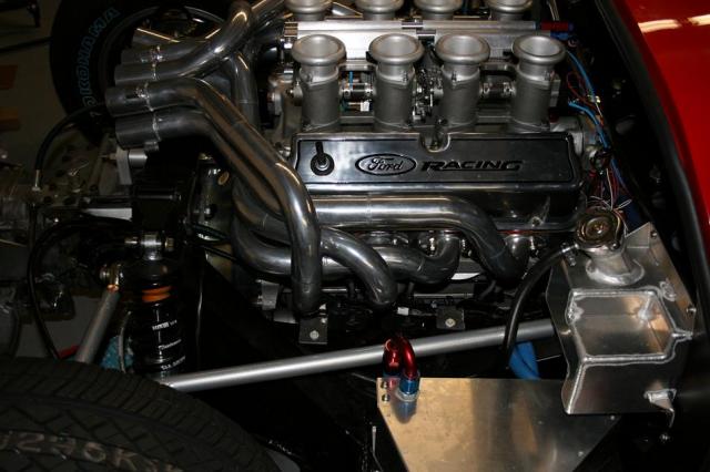

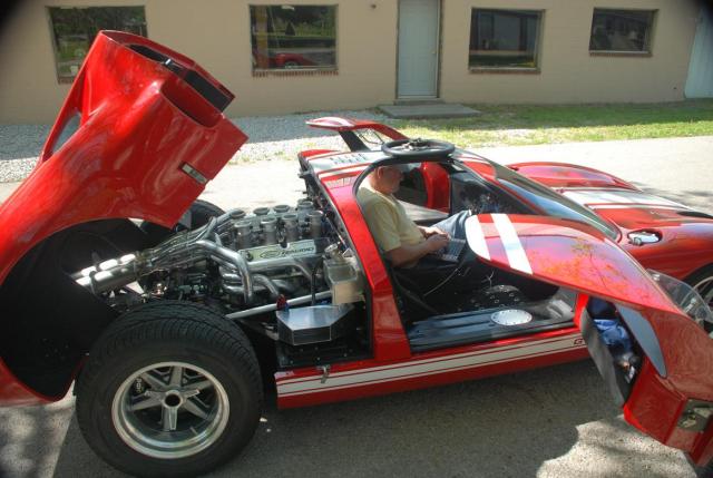

Fired my motor off yesterday for the first time, I had to convert to throttle body EFI from the 4 webers it started with. My motor came with Comp Cam rockers and when I had the intake off I checked what I could see under the valley pan and all looks OK as far as the roller lifters. As far as problems I have not had any yet other than a leak from a oil plug in the front of the motor which was easy to fix. No abnormal noises but I fired it off with open headers so its hard to tell. So far so good. As far as cheap parts I don't see any, all parts in my motor can be bought from Summit and all other quality performance parts dealers. The porting on the heads and intake had an incredible amount of time put into them. Here is picture of the motor now.

Jack: Glad to hear your experience has been positive with T and L. Thus far mine has as well, although the engine has not yet been run for more than a couple of hours.
Curious as to why you switched from the Webers to the EFI. Also curious as to how difficult a conversion it was.
Your engine compartment looks very good

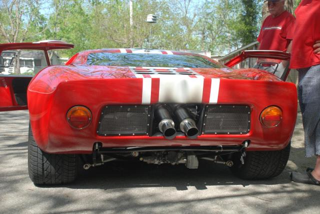

Chuck I replaced the webers as the rear deck lid would not shut with the added height and width of the spacers for the manifold, no other reason. Here are a few pictures my neighbor took yesterday after his first ride. I asked him to hold the computer and tell me what the EGO was doing when I stepped on it. He never could respond as he couldn't concentrate with the tires spinning. The motor dyno'ed 572HP@5700rpm with the webers so there are a few more pony's now I am sure.

Re: T&L engines Quality control???
Jack - The car looks tuff as hell...
Might be just a tad rich or there's some weird shadows on the back just above the tailpipes..

Randy it was running rich but the reason for the black on the back is when the rear deck lid is open the exhaust blow directly on that area. I need to limit the travel of the rear deck so that doesn't happen.

Jack: The car looks great. Keep us posted on any engine issues. I am guessing you had IDA's which caused the clearanc issue?
