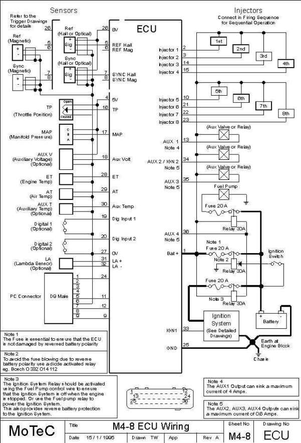

The tach out from the M48 ECU is usually provided by use of Auxilary Output 1 or 2 (pins 13 or 34) but is programmed within the ecu setup. Check your ecu config file first, or mail it to me and i'll look for you. Obviously, if you are using an MSD, it also provides a 'tach out' signal. /ubbthreads/images/graemlins/cool.gif

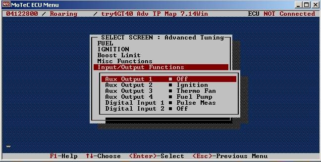

Hi John -
Sorry - I did'nt realise it was you - (helps if I read the post properly)
Anyway - had a look at the file you had previously sent to me and there are no outputs configured for use to drive a tacho. (see pic below) so I have to assume that you derive the tach signal from elsewhere?

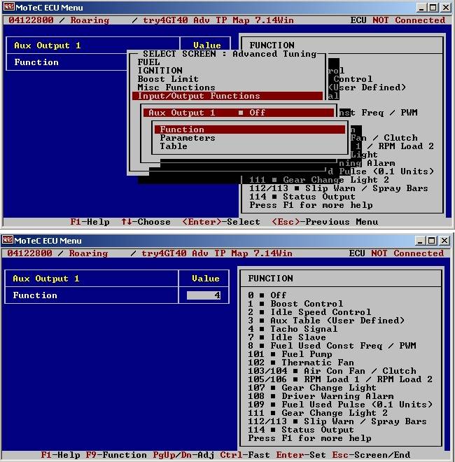

Dave - from first menu - select:
INPUT/OUTPUT FUNCTIONS
then
AUX OUTPUT 1
then
SET VALUE to '4'
This corresponds to 'Tacho Signal'
see screen shots below -
ps - this is the setting we use for M48Pro with 8-coil ignition / ignition expander as fitted to Roy Smarts Mk1 GTD. Hope it helps.

John, why don't you configue aux 1 to drive the tack and wire and set dip switches acording;ly?
