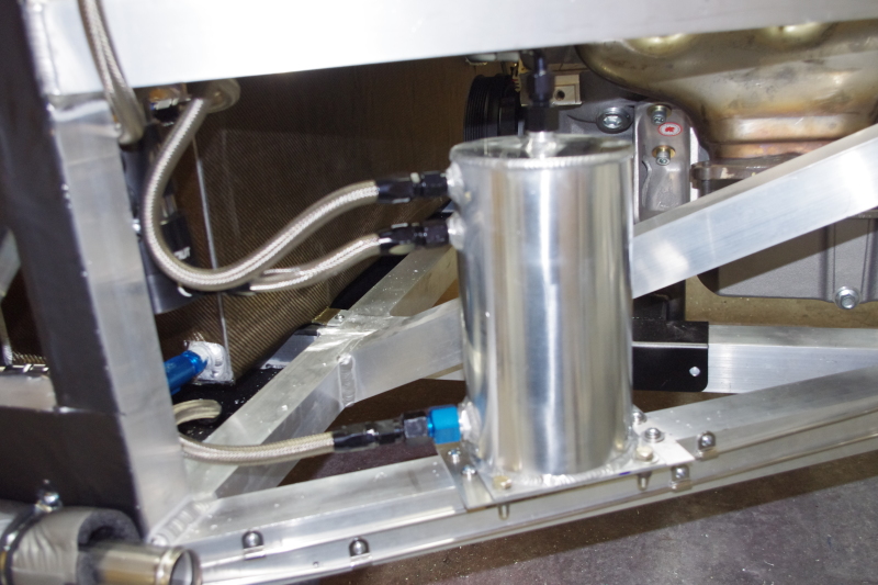

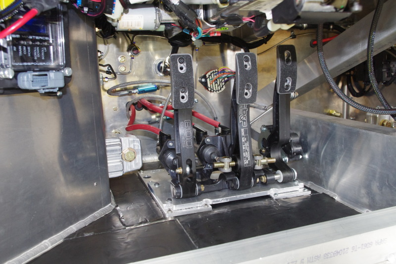

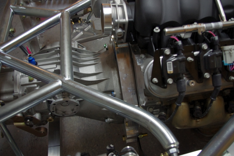

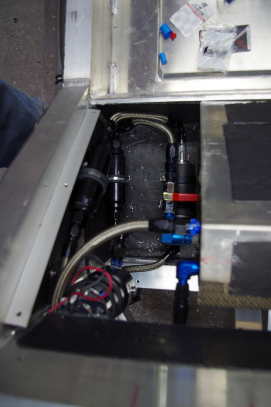

Here's a collection of pics showing progress and includes several forum contributions including a coolant tank provided by Dave, headers provided by Doc, and a tremendous amount of fabrication by Allan.
I have a ton more, so if there's something specific you'd like to see let me know.

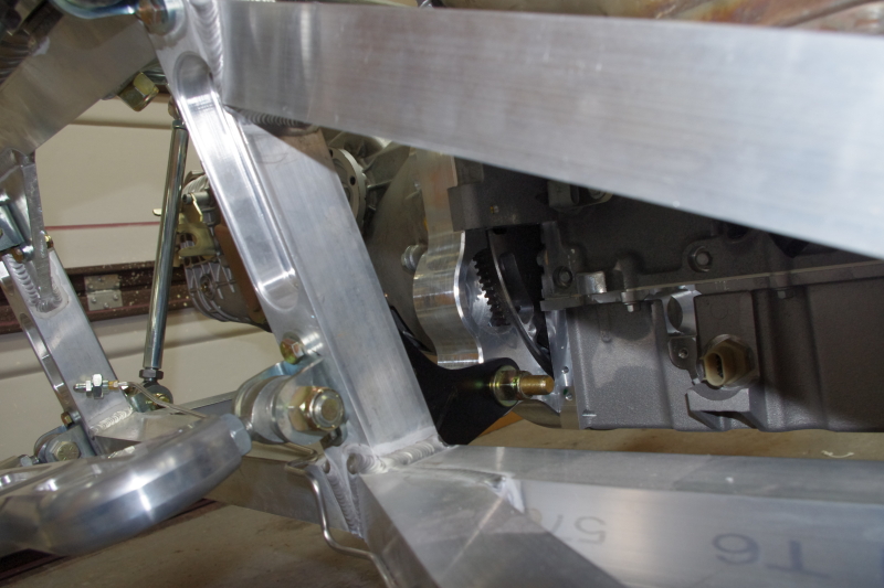

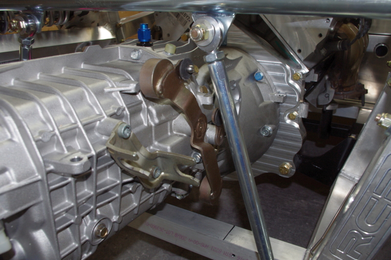

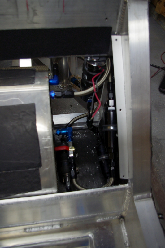

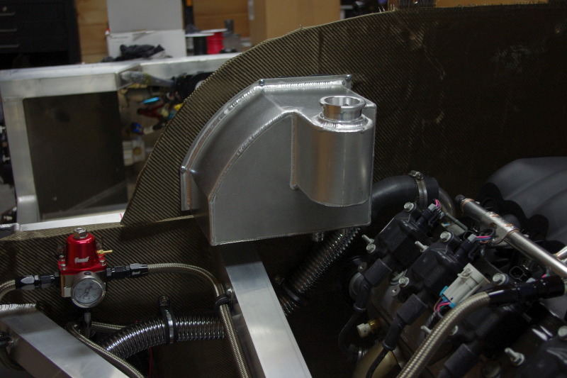

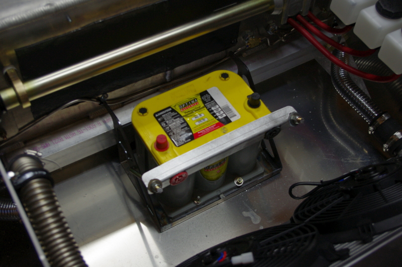

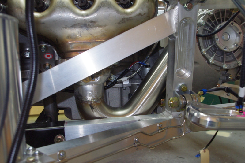

Looks great!

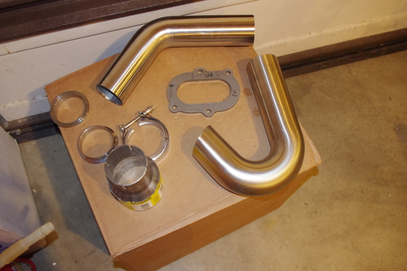

Do you have any close up PICs of the exhaust collector you fabricated coming off the LS7 header?
You take everything in the first picture, and then you squeeze and beat it until it looks like the second picture, which is just spot welded before its cleaned up, welded and sent off for ceramic coating. Allan did this for us.
Or, try verociousmotorsports.com concentric cone reducers. 304SS.
The 4" x 3" part number is B31W-G-400300-U butt welded, unpolished.
Best prices I have found too. Just squish the 4" end to the proper shape.
about $15 each.
Here's Alan's video on doing the fabrication for the exhaust [ame=http://www.youtube.com/watch?v=b3YuOw7axfY]SLC BUILD 39 EXHAUST - YouTube[/ame].
If you haven't watched his 150 or so videos on you tube; you should...
