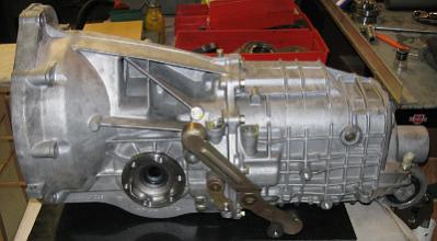

Having already lost a full year waiting for the Griffen to materialize, we jumped onto the Porsche wagon a month ago and have been waiting for Gbox to put together all the pieces we need. I was at the point of pulling my hair out when these pictures arrived. . . just in time.
Certainly some surprises here. Look at that flywheel.:shocked: Looks massive, but the center is hollow. Certainly a unique setup using the stock GM flexplate and starter. Admittedly, I'm a little uneasy about this but defer to the experience of the Gbox crew.

Hmmm... I didn't know any of this was available for the porsche box. Can you share the costs of this set-up.

Its only for the G96 box from the 996 with the 7 bolt mounting and the starter mounting on the engine block...not the four bolt transaxles with the starter pocket on the transaxle itself...
Fran, I'm still learning about Porsche boxes... I have the g96/50. Is this the series/model you're referring to.

Not many... install the drivetrain components as a unit...clutch , flywheel , trans etc , modify the water pump...drop the drivetrain into the chassis.
Thanks Fran. I see the window sections were left in rather than cut out. Was wondering if you fit the body but it seems as if not.
