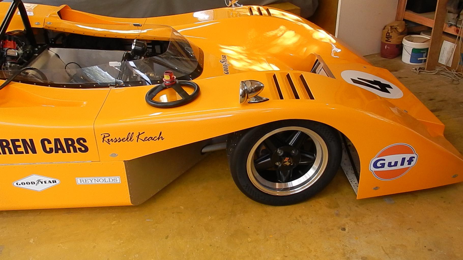

Question for the masses, front wheel arch vents, do I really need them or not, as i'd hate to cut a hole it the top of the guards if they're not all that necessary.
cheers John
I think the question do you need them for the look, the performance advantage is so minimal it wouldn't be noticed for the track time you do. Me ? I'm about the detail for authentic appearance so I would do it. That's my 2 cents worth.
Cheers Leon.
cheers John
Hi John,
I have no empirical data on whether they work or not because I haven't run without them, but I do know my front brakes get pretty hot when racing. I've made a few running changes to keep front brake temperature under control. I've got Wilwood 6 pots on 355 x 32 rotors front and back with equal bias and same master cylinders, cooling air picked up from 4 inch ducts on the chin spoiler (hard to see in the second photo) applied directly to the centre of the rotor. So basically anything I can do to evacuate hot air from that area I would do. Put them in I reckon.
Cheers, Andrew
andrewrobertson-albums-mclaren-m1b-replica-build-photos-picture1678-1511140032-2-compressed.jpg
John
For my penny`s worth, put them in. The detail just adds more to the car and any clearance of heat from the front is important. On a hot day with the radiator also throwing heat at you its good to allow it to escape.
