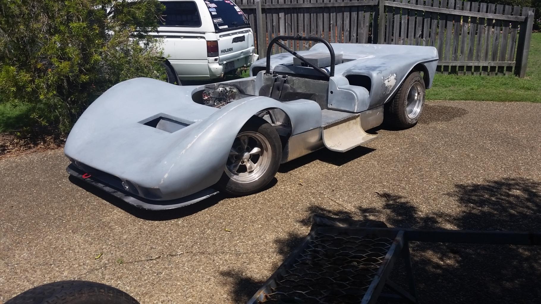

Major mile stone today, 6 months and 3 weeks after drawing the first chalk mark on the floor and she rolls out of the shed on wheels, ride height at present is 4" which is way to high, but even at that she's low and long.
one very happy chappy :pepper:

Looking bloody good John. Forgive my ignorance for this question but you mentioned ride height and that you'll be lowering the car from its current 4" to even lower but in the picture the "door" is laid open which begs me to question were doors required in this cars class when it raced similar to the outrageous requirement for luggage compartments on GT 40's etc that ran at Le Mans? I'd think given the height of the car a driver would simply jump over the sill to gain access to the seat.
Can't wait to see the finished car.
John
That`s great to see, there is something special to roll out a car that you have built yourself...even better when you get to drive it in earnest. John, my ride height is around 70mm which means a well designed trailer with long ramps.
Mike, I think the first basic rules were;
Two doors
Two seats
And the body must cover the wheels at all times. Even those rules were `loose`(Denny got disqualified once when he knocked off a front corner.
As for access, yes with long legs you just swing em over, sit down and enjoy the ride.
Yep your right Russ two seats, two doors , I think they were the only two rules in Can Am,
but apart from filling the void between the front and rear clip they have absolutely no real purpose.
cheers John
