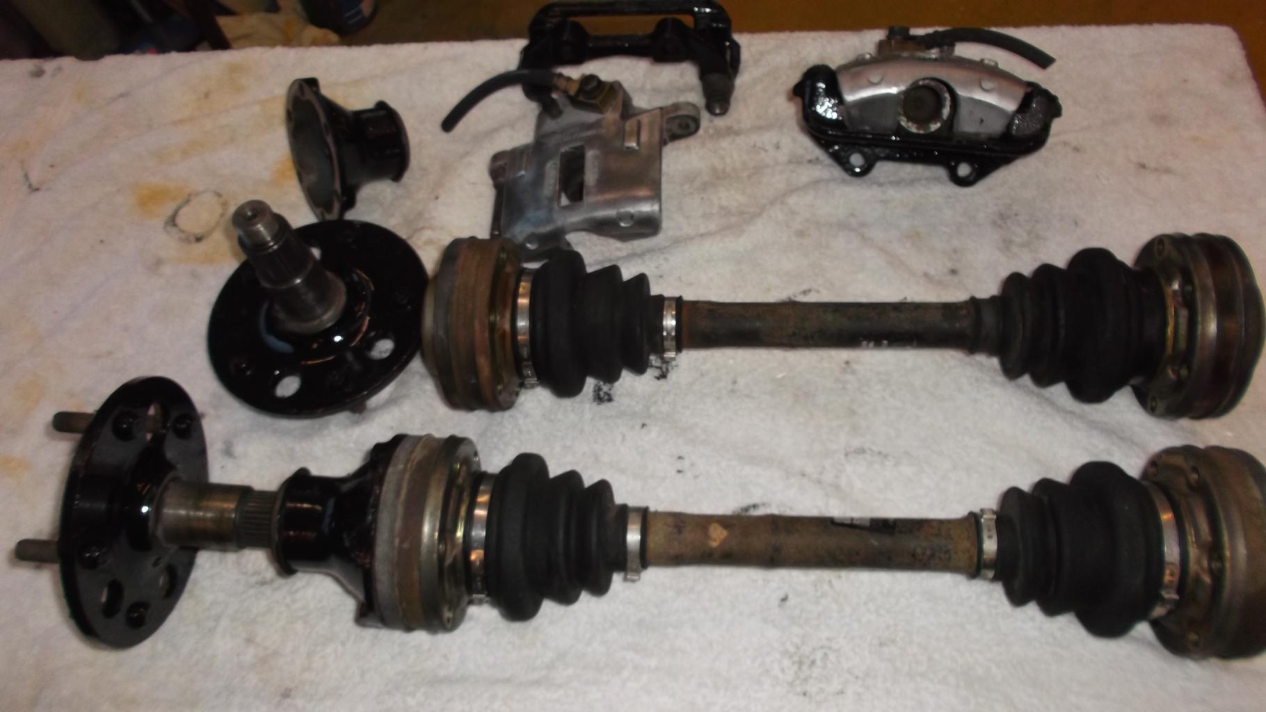

Have you looked at SS Commodor axels, bearings and drive hubs? given the shit that they get from all sorts of hoons with all sorts of HP, could they be a viable ready available components.
hi Russ, I wish is was that simple, but there just a tad to long by almost 120mm, so I have to bite the bullet and get some made, but all's good I have it under control and at a reasonable price too thank god.
cheers john

Russell, I'm using the Commodore hubs but as John says the axles are too long for our application due to the width and offset of our wheels. On a car with say 12"wide wheels you could have the uprights out more and the axles may well fit or if you ran 17" wheels with a big back space where the uprights could be more inside the wheel that may also help.
Cheers Leon
