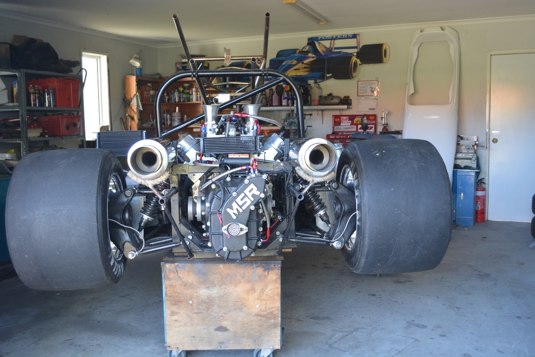

Managed to get the mufflers fitted today, cant wait to fire it up again and see what it sounds like now with the twin system.

Your 8 stack injection looks like Speedmaster, is that correct and if so are you happy with it? I am considering fitting one to my car, the price certainly seams reasonable.
PS found a project as per our last discussion, I got hold of a 1970 built formula ford in boxes even the gearbox is in boxes. Should keep me busy for a while.
Darrell DRB LS1 G50
Hi Darrell yep its a Speedmaster set, seems to be ok, at least the butterfly shafts are bearinged and sealed not like the OBX stuff. they do lack an idle air bleed so disregard the sentence that says they have one as they don't, or if they do i'm buggered if I can find it, but for a race engine they're not really relevant anyway..

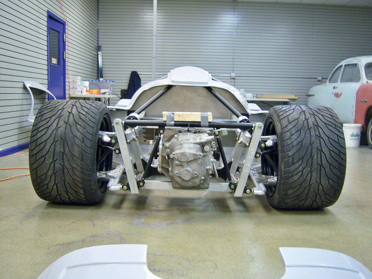

but a mate called by today as he was passing by so take the opportunity while I had it and wheeled the old girl out side and off the table at last and onto its wheels.
now there's good news and great news, so good news first, as you can see in the first pic the point of balance with 30 odd liters of fuel on board is the roll hoop, then while it was on the hook he weighed it for me, a tad over 650kg so who's a happy boy then.
so as she sits now its just rear axles to fit when I get them then paint and dyno and she's done and dusted. any way here's a few pics I took before she went back into the shed. hope you like them.
