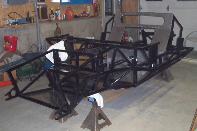

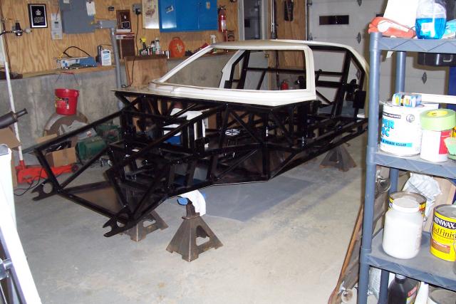

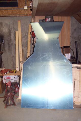

I've got some good progress to share with you all.After work on Thursday night and more time spent today,I now have the floor cut and riveted in place.I had a visit today from Scott Calabro,Tornado's rep' here in the states.He brought with him the head lights and the air unit that Tornado sources out here in the states. We got the car upright and ready for the rest of the panel work to be done. I'll be at it again tomorrow after watching the F1 race in the AM.
Anyway,here are some shots of the cut floor pan,floor in place and the GT upright and waiting for more personal love.

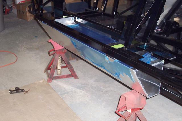

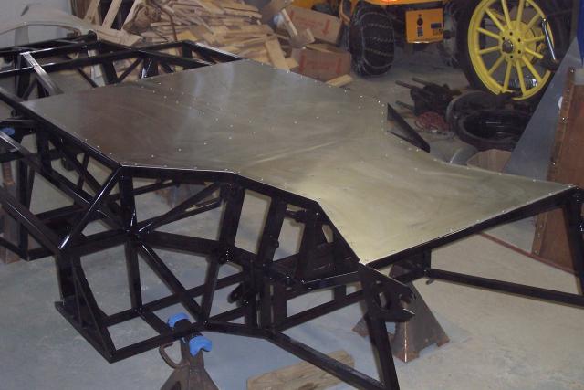

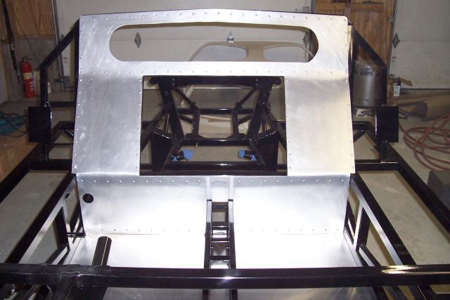

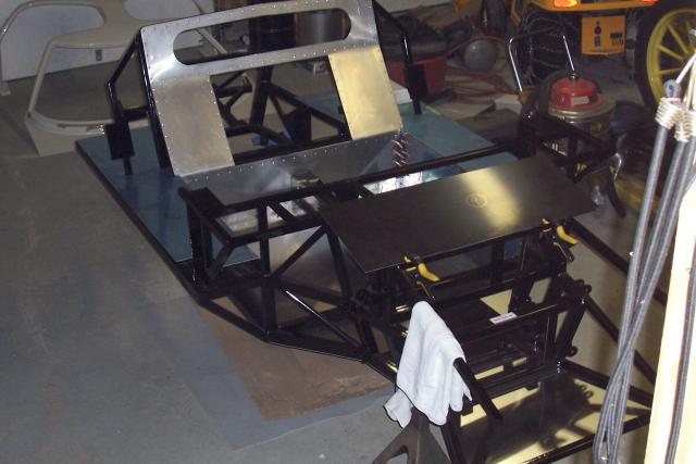

After setting some 225 rivets I have both the the floor and the rear bulkhead in place. Both side sill plates have been fit,as I wait for the rivenut tool to arrive from S. Calabro so I can mount the gas tanks before mounting the sills.

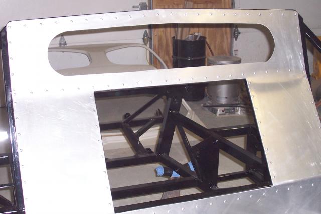

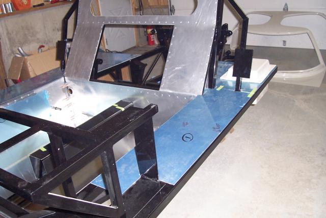

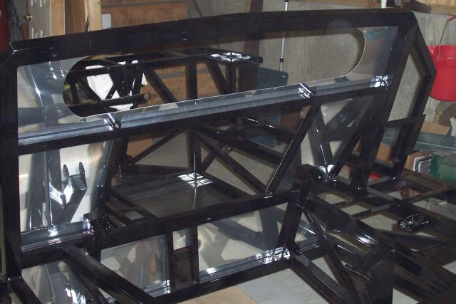

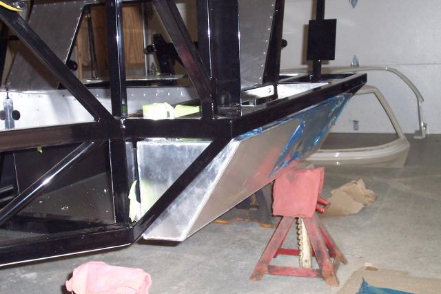

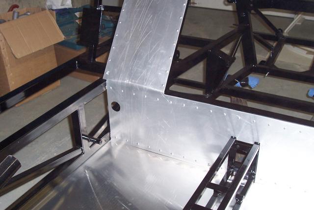

Thought I'd let you all know how my weekend went.It was a warm end to the week so I took the time to get the Daytona coupe for the first time this spring.We had a nice 50 mile drive on Friday evening.Saturday I had a meeting of the local H.O.G. "Harley Owners Group".Riding season is not that far away.Saturday afternoon and Sunday was spent working on the GT.I was able to get both cockpit side panels fit and riveted into place.So far on the floor,the bulkhead and the sides I've placed 312 rivets.Both left and right sill panels are fit and ready to rivet once I've hung the fuel tanks.I'm pleased with what I've been able to get done.
Here are some shots of where the GT stands, Bill.

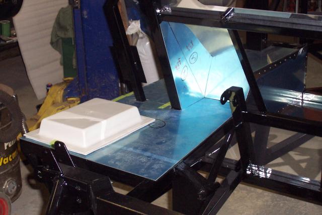

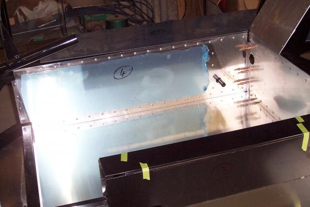

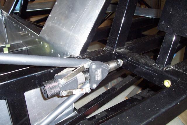

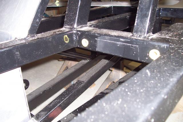

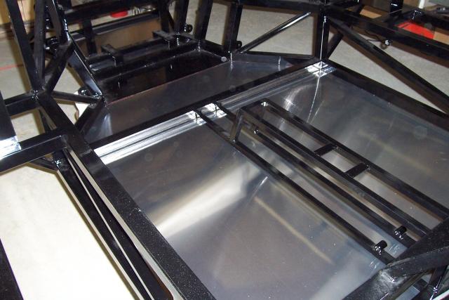

Scott Calabro lent me the tool to set the rivenuts that hold the fuel tanks in place.So I made it a point to get them mounted.Real easy job.I'll get the sender units fit,then the tanks will be ready for final mounting.More alu' work on tap for the weekend.

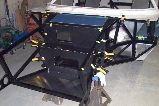

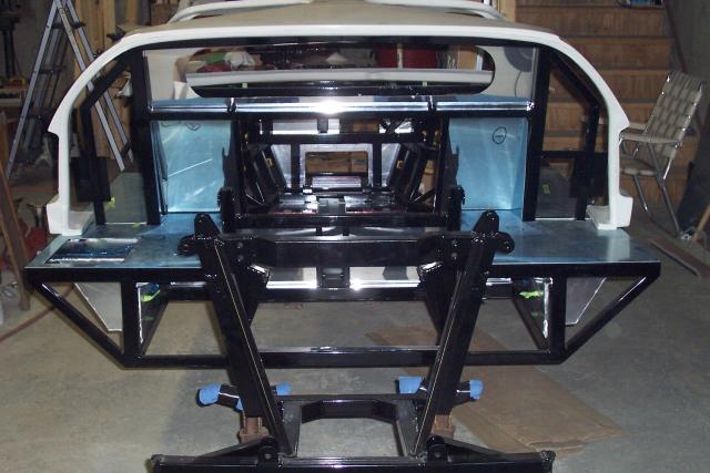

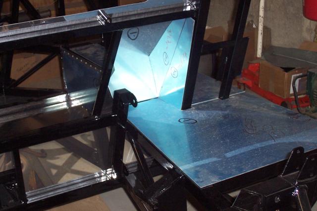

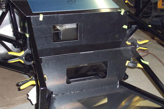

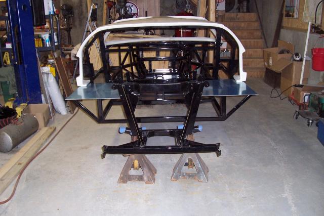

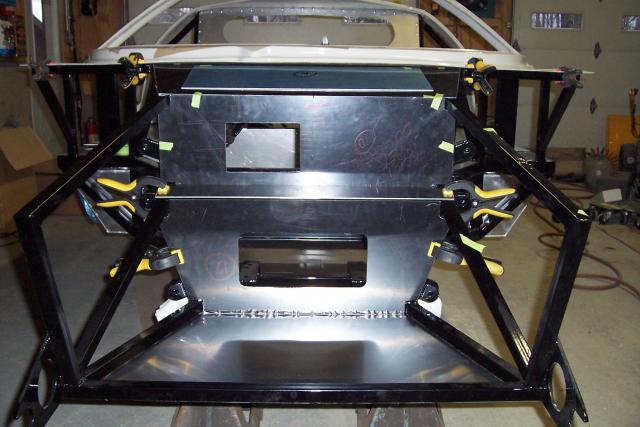

Here's a few shots of the weekends work.Except for the lower bulkhead panel all the front panels have been fit.I'll get that done and start on the front wheel wells this week.I hope to have all the alu' work finished by the end of next weekend,we'll see how that works out.

Dimi Terleckyj
Hi Bill
Looking good, but one quick question.
Once you rivet the sill panels into place how can you get to the bolts that hold the fuel tanks in if you should need to remove the tanks for some reason ??????.
Tanks do need to be removed and flushed from time to time especially if using in tank fuel pumps.
I know from experience the amount of junk in my fuel tanks that has entered from petrol station pumps is amazing.
Dimi
Hey Dimi,
I will be drilling access holes into the sills to have access to the tank bolts.I agree that the tanks should be able to be removed for maintence or repair if needed.
Thanks, Bill
Hey Dimi,
Thanks, Bill
Hi Bill
Are the access holes documented in the build manual or is this something your adding yourself? I am still on the early stages of panelling my Tornado but the fuel tank area is something I've started to think about and want to make sure I have good access if needed.
Trev
By the way, your build is looking very good. Have you built a kit car before? It seems so many people on here seem to motor through these builds yet 1 week into mine I've only managed to get the floor in :)
You guys are either quick or I am very slow. That said I am sure as I get more used to the panelling etc I'll start to pick up a bit more speed.
Hi Trev,
This is my third build. The first was a build based on a Datsun 280Z,the second was a Factory Five Racing Daytona coupe which I still have,picture earlier on this thread and now the Tornado. The idea of holes to gain access to the fuel tank mounting bolts I got from Scott Calabro,Tornado's rep' here in the states. Seems like a good idea.
Don't worry about your speed,work at a pace you can enjoy and be sure to do all you want to do the first time.Redoing cost alot in time and money.
