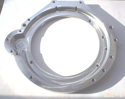

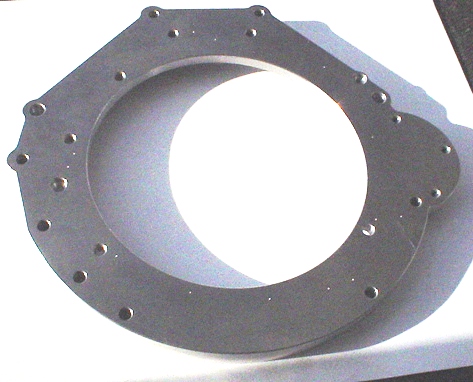

"Some" progress --Ford mod. 01E /AO2
Nice looking adapter. Do you have the flywheel worked out yet? Would you share dimensions and other particulars once completed?

Hey guys I wanted to give you guys a quick update on my custom LS1-01E adapter. A prototype was made to confirm the dimensions, now I just need to make the real thing. It is going to be 0.824" thick (~21mm), but the good part is that it will use a stock LS1 starter location. It is also going to use the stock audi clutch setup and a stock LS1 flexplate. The reason is to cut down on the number of custom components while still maintaining the stock starter location. A custom steel or aluminum flywheel is going to be made. But I'm just excited about the thinness of this adapter as nobody said it could be done. Considering most adapters are .5" thick I figured .8" isn't bad considering everyone was saying it would be 1.5" thick. When I get the real adapter plate done I will post pics for everyone to see. It is going to be fun.
Adam
