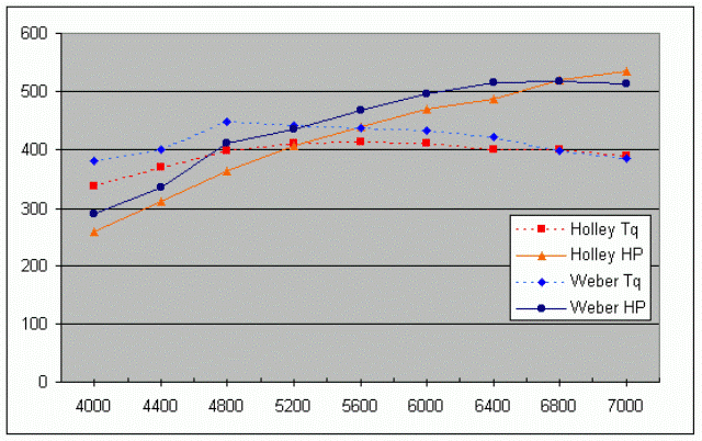

A couple of bits of info that might be of interest. I can't remember the source as I have had them a long time and the brain cells aren't what they were.
Holley v Webers
Tested back to back 331cu
Weber outdid Holley through midrange but overtaken by Holley at top
Results Holley left column:
Engine specs:
Stroke 3.25 5.400 rod length, Crower ultra light crank 11.0 CR
Head: Victor JR 301.5/200.5 @.600,Victor Junior manifold
Buddy Rawls flat tappet cam:.592/.544,262/264 @.50
Holley or Weber carbs.
H H W W
RPM Tq Hp Tq Hp
4000 338 257 382 291
4400 371 311 400 335
4800 398 364 449 411
5200 411 407 441 436
5600 413 440 438 467
6000 412 470 434 496
6400 400 488 422 515
6800 401 519 399 517
7000 390 534 386 514

Considering you need a specific type of cam grind to get the best performance out of a set of Webers is there any point in comparing Holley to Weber using the same cam. Either the Holley induction or Webers are going to be compromised somewhere.
Apart from that, the peak HP figure for the Holley is wrong anyway, if the torque is correct at 390, the HP should be 519, very close to the Weber figure. Then again, looking at the supposed spec of the motor, should we believe ANY of the figures.
Mike.
I believe that is the old data that "289" published here a few years back. Some questions were asked of him but answers were never forthcoming. He liked Webbers and I think the outcome was predeterimed.

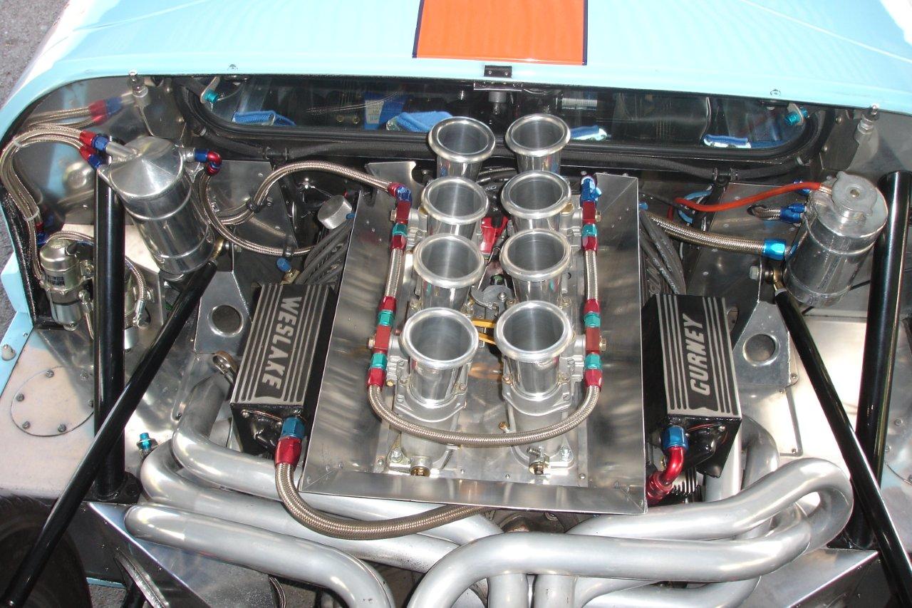

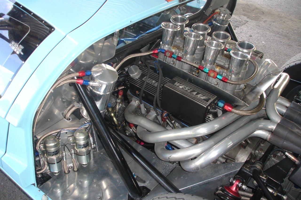

Weber looks and sound, modern performance. Best of both worlds?
Glenn
