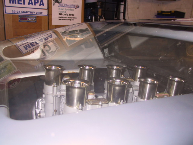

Sorry, I didn't have a picture with the rear clip and window on.

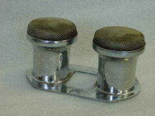

(Hersh, this pic is one of the stacks I purchased and referenced in another thread yesterday)

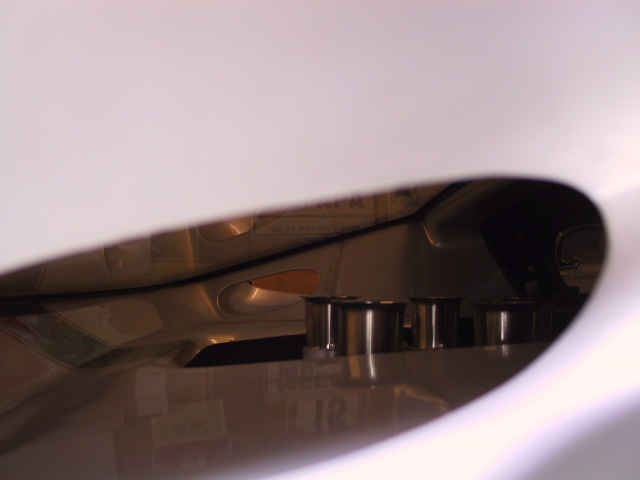

Yuji Son,
As Neal mentioned, 2" is probably best. I also have a GTD and with 2", I can actually see behind me!!

Hersh is right, IDAs are considerably taller than IDFs. The problems are that you cannot adequately use IDAs on a standard height GTD engine set up ( I met Fred from Belgium today in the UK, he has a smashed glass rear window to prove it! ) IDFs have some rather nasty characturistics on a GT40, if run on a more than stock engine, and will have considerable "stand off" (blow back of neat liquid fuel) from the tops of the carbs which can cause fires in the carbs, I have seen lots of IDF sets burning nicely. I did a lot of experimentation with IDFs to try to improve performance and reduce fuel stand off, one of which was reasonably successful. This entailed making extended venturi tubes to reach the same height level as the inlet trumpets, using improved radiused edged trumpets to get a smoother air flow into the carbs. Using mesh covers over the trumpets may look OK and in theory stop any ingress of debris, but the result is a very poor air flow, increased richness which if dialled out by the jets just kills high rev performance. The real answer is to lower the engine and use IDAs, which is what you will find on all UK track use cars running Webers. If you are just a road cruiser with a stock cam and compression, no revs over 5K, then it may work, but not for me ! Frank

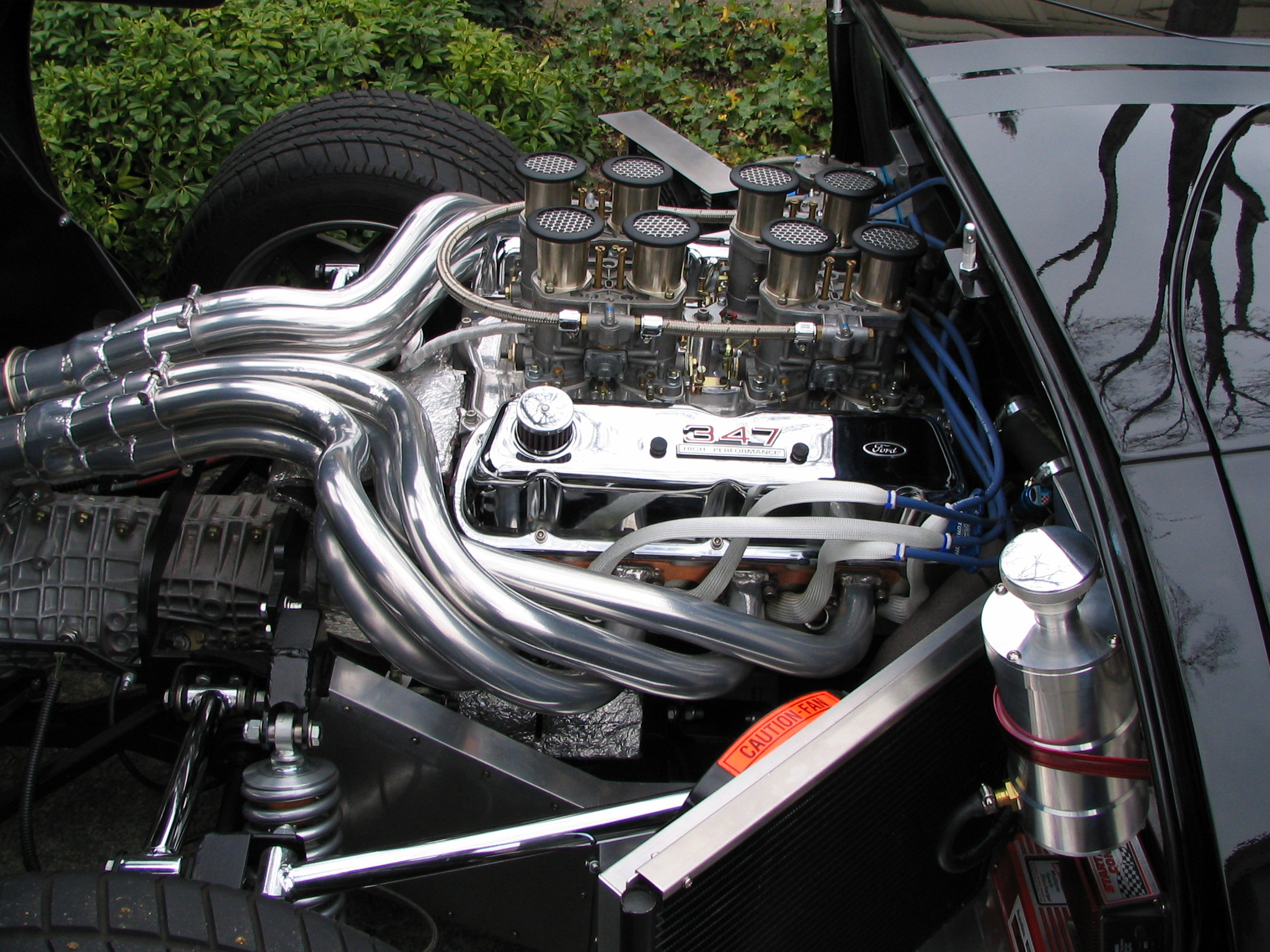

I am running IDF's w/2" stack on my 347, they work just fine. I also am using K & N air filters so there is no fuel standoff problem. I like 'em, they work great and sound right.
Fred, I have just installed Weber IDAs into Martin Weigolds car , the top of rear most trumpet is 95mm (4inches) below the glass rear deck window, photos if you want them, (You showed me that the rear trumpet on your car touched the glass and had broken it! )Frank
Fred, this is done useing the new rear chassis section developed for our new GT40 replica. The chassis is designed so that older chassis can be updated by the simple expediant of cutting off the rear chaasis at the end of the sill sections and replacing with the new piece, just four weld points and its done, although new lowered engine mounts are also needed. Frank
