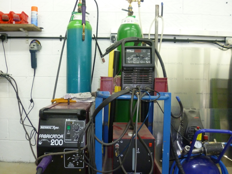

I have a unit from (200amp DC):
Inverter TIG MIG ARC Welder Welding Machines Tokentools sales service Australia wide
Which probably aren't available under the same brand in the USA. I point this out as I would expect these to be labelled as 'Cheap Chinese crap'.
However mines roughly 4 years old, done everything on my car and not missed a beat, if it breaks I'll bin it and buy another and still be in front compared to a name brand item.
This one looks closest to my unit.

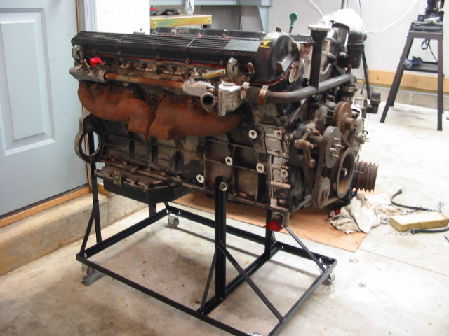

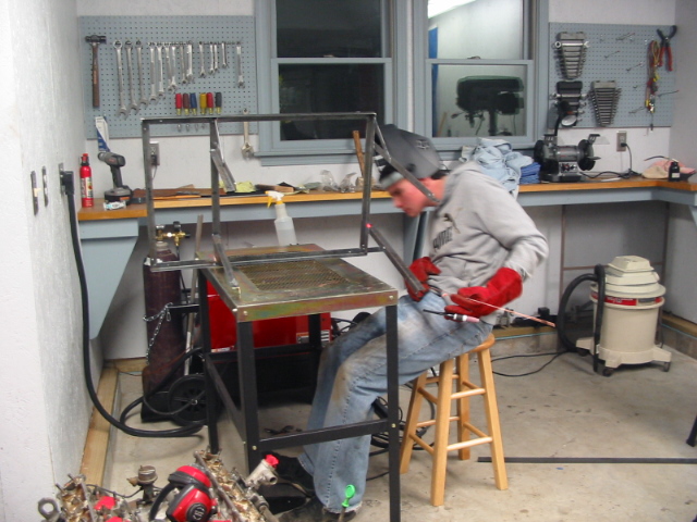

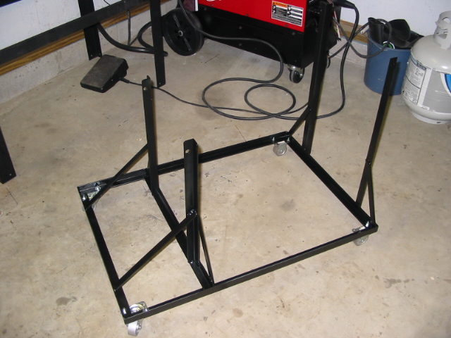

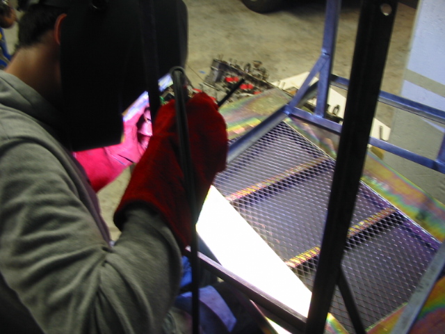

Our first welding project. Ryan gets credit for all the welds. TIG with 1/8" steel proved pretty straight forward.

Jim Rosenthal
You're building a Shaguar, aren't you....lucky devil. You're going to need four three-barrel IDF Webers, or some reasonable facsimile...this is going to be interesting.
