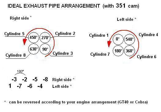

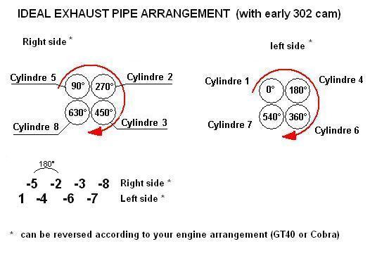

It is a common agreement that exhaust pipes must be grouped by 180°. However, in order to have the best "pulse-extractor effect " as mentioned by JCoop, it is necessary to have a circular pipe arrangement according to the order. It means that for a SBF engine with a 302 camshaft the ideal merge collector arrangement should be modified as follow: (I refer to the nice data from Sandy)
Left________ Right
5 - 2 ......... 6 - 4 Top
| x | ..........| x |
8 - 3 ..........7 - 1 Bottom
You note that with this new arrangement the circular order is clockwise at the left side and anti clockwise at the right side.
With a 351 camshaft the ideal merge collector arrangement will be as follow:
Left________ Right
| x | ..........| x |
This data is the same like the 302. However, in this case both circular orders will be in opposite to the 302.
To conclude, we note first that the Sandy's merge collectors have not a circular order for a 302 cam. In second, I agree with Russ, whatever the camshaft that you use (302 or 351), it doesn't affect power nor Weber tuning, except if your circular arrangement is like Sandy. In this case, we note that it could be correct at one side (left) and incorrect at the second (right) when you use a 351 camshaft. That means you will have a different pulse-extractor effect at one side that will affect power... and Weber tuning :o
Hope to be clear despite my language problem ;)

Sandy, when you try to empty quickly a bottle of water, you give a circular movement at the bottle that will create a mini wirlpool inside to accelerate the empty operation. Exhaust pipe circular arrangement follows this basic principle. Whatever your induction system (carbs or injection) this design is in relation with your camshaft characteristics and your induction tuning. However, don't worry, there is not a large difference between all different arrangements. My purpose was only to indicate the best theorical way ;)
As a small sketch is better than thousand words (mainly for me :o )
please have a look below

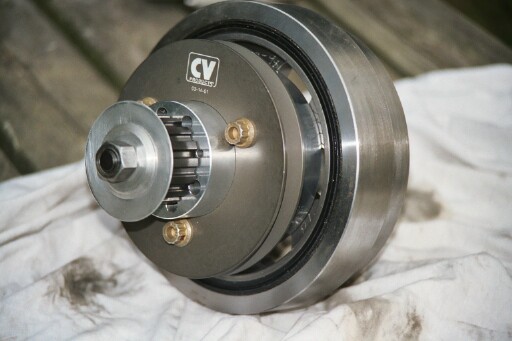

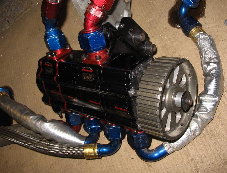

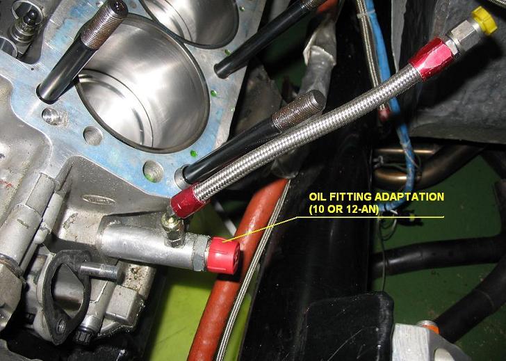

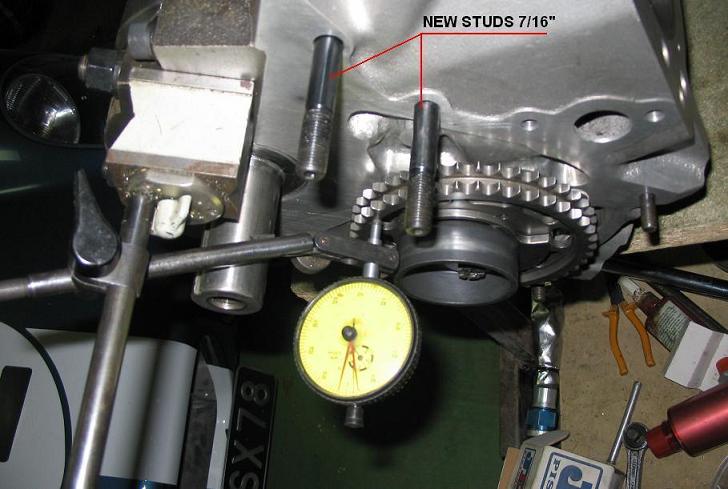

Hi Doug,
Back to the dry sump design. I agree with the majority of previous answers, dry sump is only interesting for the track with racing tires that will allow strong lateral accelerations. Forget it for a street use even if from time to time you go to the track, it is not a cheap deal :o . Anyway, my purpose today will be to indicate what you will need to do if you decide to install it.
a) block modification.
I suppose you have a standard 302 wet sump (if fortunately you have a dry sump SVO block, go the the next step). Modification 1 will be to remove the internal oil pump and to provide a plug in the oil filter hole that is in communication with the pump discharge duct (inlet side). Then you have to provide an oil fitting connector (10 or 12-AN) at the main oil galery (see picture) for oil pressure input (from external pump).
Modification 2 will be to replace both 3/8" screw at the right side of the timing cover by 7/16" studs (see picture). These studs will be in charge to fix the external oil pump support on the block.
b) Timing cover modification
You have to drill both holes for the 7/16" studs (just enlarge existing holes). Then you have to bring it to the workshop to machine the pump support area (to be sure that the oil pump support will be straight). If you have an oil dip stick remove it and put a plug in the hole.

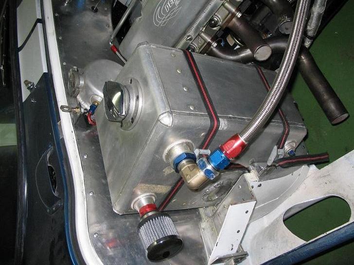

c) Oil tank
Select an oil tank that could be installed as close as possible from your oil pump. Preference is that bottom level is above the oil pump suction point to facilitate oil input with a large hose (16-AN is perfect)
d) dry sump
Select a dry sump with at least 2 suction points (front and side).
e) External oil pump
Select an oil pump according to your dealer local recommendation. The stage number as well the stage size should be in relation with your engine.
Best manufacturers are Barnes, Peterson, Weaver, Gambler, Aviad...
f) Oil pump support
You have to made a strong support to fixe the pump on the block
g) Pulleys
In order to drive the external oil pump, you have to provide:
- To remove the existing pulley on the crankshaft
- To fix a new pulley support on the damper (see picture) This support shall be sized in order to have a good alignement with the oil pump pulley as well with the water pump pulley.
- To install a new set of pulley(s) to drive water pump (and alternator if any) on this support
- To install a new Gilmer pulley to drive the oil pump (usually 16 tooth)
- To install a Gilmer pulley on the oil pump shaft (usually 32 tooth to have an initial ratio of 0.5)
- To provide a tooth belt sized accordingly (usual length between 22.5 to 27")
