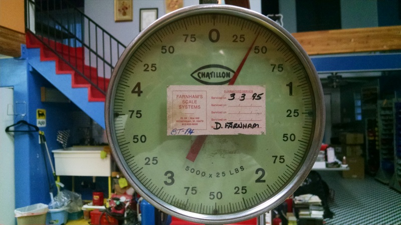

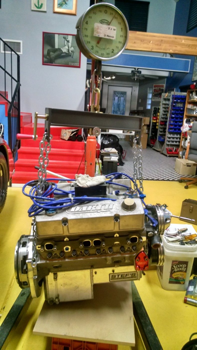

A large displacement SBC will save you considerable weight over a BBC. My black Mirge has a 383 ci Donovan aluminum block (SBC copy) and I find that it is is quite satisfactory. This engine weighs 400 lbs complete.
