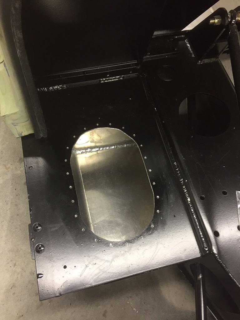

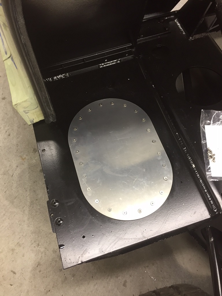

Mitch Krause
I recall seeing a bunch of pictures at different times of uses for the compartment immediately behind the driver in the "sponsom" (if the is the correct word). And some discussions on what was done with that space. I had made some notes, and found a cover and cut a hole and having some time before hockey the other night tapped 24 holes and installed the cover. (See pictures). Then the wife asked "what have you been working on?". Good thing I had some other progress to answer with, since if this had been the only thing, I think my reply might have been "I cut a hole and then took a slightly bigger piece of the same material and drilled and tapped 24 holes and patched the hole".
I don't yet have a particular plan. So what have you found most useful to utilize this space for and why?

Mitch Krause
Oh, one other addition to that. I got the cover from Mayhem MetalWorks. Cost was $50. I did have a little trouble sourcing it, as that size of cover seems to be hard to find, in particular in the blank. A few places on the web had it on their site, two of them I actually ordered it from (who both had the same part number on it), and they were both out of stock. Did find a couple of other places where the cover was $85 or more for just the blank. Was happy with what I found, so thought to mention where I found it.
