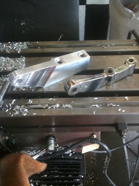

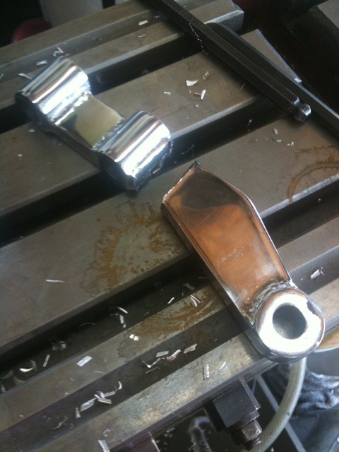

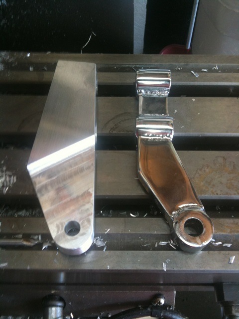

Tim Kay
Andy,
Where are these arms made?

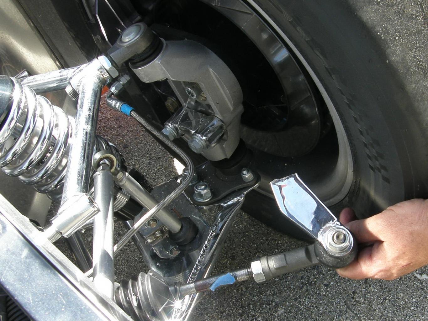

The hat was ordered undrilled and I machined it to match the Tornado aluminum hub. The offset was calculated with that hub as well which gave me maybe 1\2" clearance from the caliper to the inside face surface of the wheel (if I were to do it over I may have used that space up thereby narrowing my front wheel base width).
The only other machining required was a caliper bracket that was pretty simple to make. I have the scaled drawing if you like.

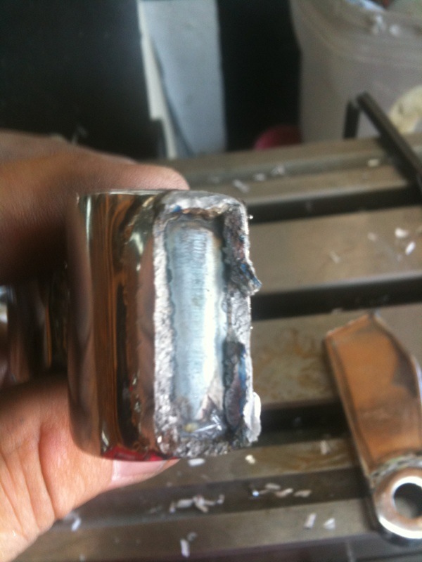

It looks like they have been chrome plated???
Not a good idea
Andy,
You could very well be right, I'll give you that.
The heat that takes place in the chrome process may have compromised the welds in this steering arm. But it doesn't excuse, under further examination, what was already a very poor quality weld and, IMHO, a very poor design to begin with. Had someone shown this picture and told me that it could occur "in earnest" (as Darren says) I would have opted for something more like what I now have (see below).
Chrome parts are not unusual, I may be wrong but don't you sell chrome a-arms? My Tornado has had chrome a-arms since the original owner built it (I am kinda drifting here, a-arms are a topic for another day). What I'm trying to say is if welding is correctly applied then the chrome process should have little if any affect on their integrity. Conversely the opposite would be true.
I've mentioned in other threads here that I drive offroad cars. Many of my parts on those cars are welded chrome items that hold up under way more abuse than my Tornado steering arm ever will, so I'm confident when I say chrome on a well made part does not compromise it's quality.

If you are going to chrome suspension items you must be very very careful.
You must be sure that when the item is polished that welds are not ground down or over polished producing undercuts. Most platers automatically over work the welds in an attempt to smooth the items out.
When the items are tanked the must be throughly rinsed and cleaned afterwards.
And most importantly after plating they must be normalised to prevent embrittlement. Many people do not even know about this problem.
Any items we provide plated meet all of the above criteria.
Andy
