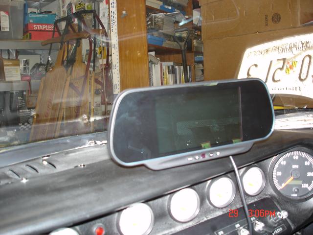

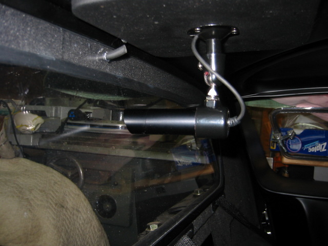

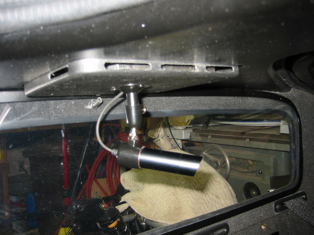

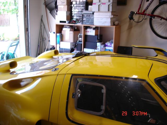

I’m checking to see if this is legal but I’m hoping not to have a real rear view mirror. I'm going to use the same camera I’ll use to take videos of open track events to be my rear view mirror. The camera is a .1 lux 580 line Sony from datatoys.com. The small dash mounted monitor has a button to flip the image so it will work correctly in either direction. Might be strange but the forward camera view will be much better without a mirror in the way. The monitor also has a wireless license plate camera so between the two I should have it covered. This was just a test fitting, the drain should be hooked back up soon along with many other improvements. I hope to post a how to on the whole project.

Richard,
I like your idea for the race camera. I plan to use one of the tag cameras purchased a year or two ago to start with until my wife loosens up the purse strings. With our daughter getting married this fall, that is highly unlikely.
One thing you might want to consider is, if you have the plexi rear hatch cover, I think your visibility out the back from inside the cabin will suffer no matter how good the quality of a camera. I am planning on either getting a glass cover, or putting the camera on top of the spider. I have adapted the tag camera to a "third brake light". It is a temporary thing for now, and if the real camera will fit, it will all be glassed in and painted.
I will be interested to see if you think the rear camera is satisfactory. I use one, but only for a general idea of what is behind me, mostly in parking lot situations( it has a wider view than my inside mirror). I have a hard time judging distance with a camera, much like with a wide angle mirror. An inside mirror is still hard to beat.

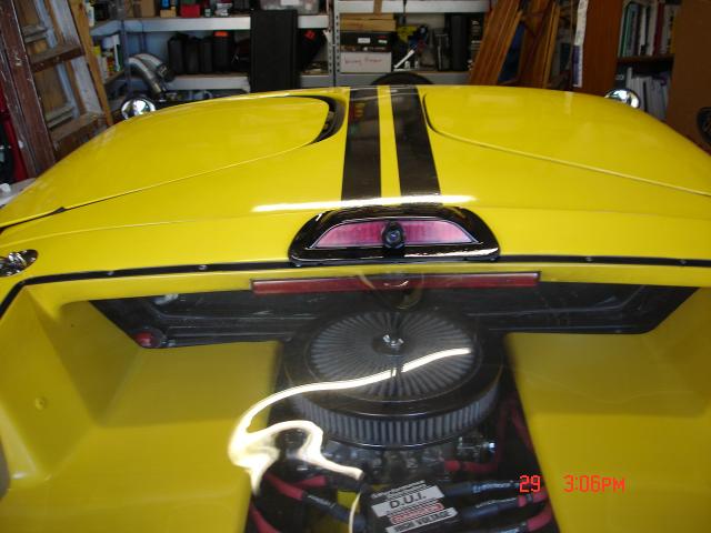

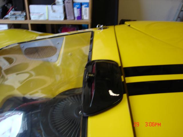

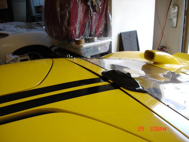

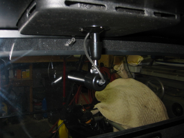

Guys,
I've come up with what I consider one of the more elegant solutions - that is to mount the camera on the rear hatch in a used third break light housing - see pictures. The camera and the mirror costs about $120 and the 3rd break light housing cost me about $15 dollars on ebay!
John

Nice solution, however, the depth perception problem remains (see David Morton's post). I had considered mounting a wide angle camera in the tail section, and a mirror type display on the dash. A neighbor has a similar system in his van which I drove and found that there really is a depth perception problem in this scenerio.
So, it appears that I will stay with the high mount mirrors as standard on the SLC.
Will know more after the car is delivered. I'm sure that on the road this is not to much of a problem. Backing would be the challange but to be sure, there will be a crowd around the car whenever it is parked somewhere. This allows for a "spotter" to be easily selected!
