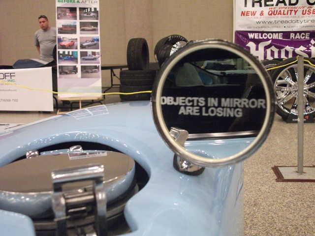

I'm using chromed bullet style wing mirrors but still deciding where to mount them.
Common sense says where you can see best, but going by pictures 50% mount on the front canopy and the rest on the doors.
On my original GTD 40 I had them on the doors.
Usually your view rearwards from the drivers seat is through the drivers side window and view rearwards from the passenger side mirror is through the windscreen.
Comments welcomed
I was talking to Frank about this a few weeks back. He was saying that for racing etc it was best to mount on the wings as then you don't have to take your eyes off the road ahead when you go to look in the mirror. This was regarding racing
I think though you may lose some road visibility on the wings - I could be wrong though.
KEITH, this is an old chestnut, discussed many times and can be quite emotive with some people. Depends whether your priority is function or aesthetics ! MY very strongly held personel is that you need to be able to use the mirror whilst keeping a forward view in your peripheral vision, which means that you need to view the mirrors through the front screen, rather than blindly turning your head to look into door mounted mirrors. Mount them just forward of the filler cap holes for safest visibilty , in my opinion.
100% agree :thumbsup::thumbsup::thumbsup:
I've had them in both positions and front clip mount is best.
Yep, mine sit just in front of the filler caps, I agree with Frank with having to turn your head if they are mounted on the doors.
I also think they look better on the front clip.

On my Ultima I have just got two new carbon mirrors, Not Ultima's method but the supplier builds race cars and the mirrors are mounted to get best vision. One is mounted 130mm more forward than the other. Not cosmetically as good but efficient.
On the Ultima thats how I did them and yes the vision is good.
Could be the on the wings then !
Here's what I mean about the offset mirrors, this is a mock up prior to fixing.
OK it's not a GT40 " use your imagination ".
One mirror viewed through side glass and one through the screen, works well
