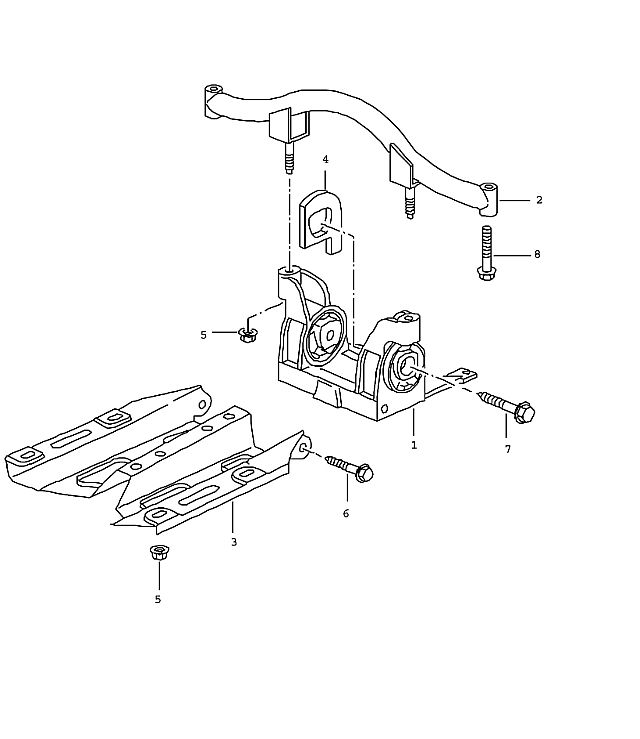

Yos -- I have the same transaxle. How is the tail-end section supported in the rear. Is there some sort of rear trans mount/bracket on the lower rear horizontal beam or... a picture or part number/brand etc. would be great.
Thx, Mike
Thx, Mike
Hey Mike! There's nothing there right now. I'm planning to build an aluminum plate to secure it to the beam. I'll post pics and can send you a diagram if you like. Should be pretty straight forward...
Mike is right about the transaxle Matt. It's a Porsche G96.50. At least thats what it's supposed to be...
I'm in a similar place. I have a G96/96 from a 2004 Porsche GT3. What I will likely do is get a salvage transmission mount and fab a bracket to attach that to the upper brace. Since I have a full Porsche drivetrain, I may even get rid of the motor mount plate between engine and transmission and just use the stock front motor and transmission mounts. That's how the drivetrain sits in a Porsche.
But that's not what this thread is about. Regarding just the transmission, the part number for the current and most up to date transmission mount for a G96 is 997 375 033 03. In looking at the parts DB, anything from a 996 tiptronic (not manual), 996 GT2/Turbo/GT3, 997.1 base model tiptronic (not manual), 997.1 GT3 and likely more 997's should work, as they all reference this part number as the current replacement part. $250 new, but I'm sure you can get them fairly easily from LAPD or DC Auto. Note that base Carrera with manual are a different part number.
Hope this helps.
Tim
Here's a picture of what I'm talking about. It would obviously be upside down.
