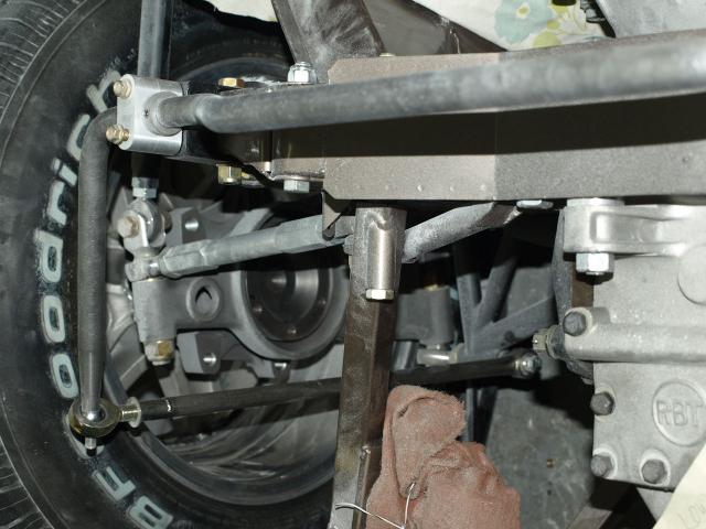

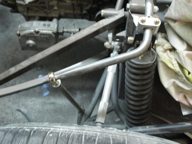

Yesterday we fitted the sway bar and sway bar upright links that I got from Jay Cushman. The links fit onto monoballs which slide over a bolt on the lower rear control arm, and a Heim joint threads into the upper end of the link and onto the sway bar. Nice fit; we just need a few odds and ends like circlips etc to have it all together. I am using some fabricated brackets we made to hold this all in until stamped ones arrive from JC. Photos pending (yes I keep saying that but I really will do it)

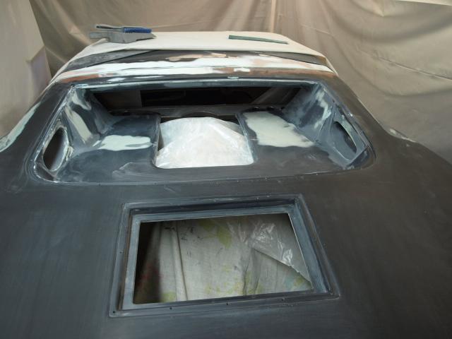

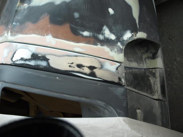

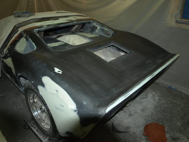

Some photos of 1149 in progress. The bodywork on the rear clip is virtually complete. We also have the rear sway bar installed on temporary mounts. The brake calipers are finally in, after several headaches with the fit (or non-fit) of the brake hats. We have the (nearly) complete pedal box assembly and next week will begin working out where all the brake lines go, as well as the clutch hydraulic lines.
The fact that there are so many colors on the bodywork obscures just how good the fit is; the fiberglass specialists have done a very good job of getting everything to fit consistently and properly.

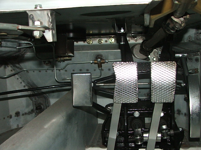

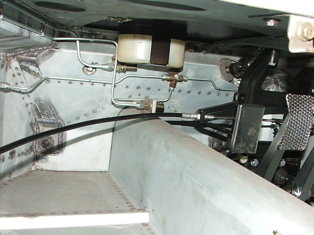

Hi Jim, Go with the hard line if you can, would be a shame to use the other stuff, 3/16 for brakes and 1/4 for clutch, some photos if it helps

Got it. John, your brake lines look terrific. I wish I had those. Maybe later, but right now I'd just like to get some of this stuff working. Did you make all those hard lines up yourself? They look very well done indeed.
I've always used hard pipe for everything including fuel for my race cars and it's actually quite satisfying to run it. I could not contemplate using a flexible pipe for brake and/or clutch - just doesn't fit in to my sphere of experience!
Even running hard lines is not exempt from problems. Some rules won't allow the use of copper in brake lines but I've always used it no problem - but some experts will say that steel is safer. It might be but it's also very prone to corrosion. From memory I always used Kunifer cupro-nickel in 90-20 mix as it is easy to anneal and forgiving to fit...
