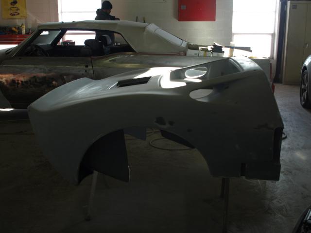

I have reached the progress point where parts of my car are distributed among various places- sort of a GT40 diaspora, if you will. Most of the bits are in Annapolis, some at the body shop, some at the main shop, some at the metalworking shop. Fortunately all these places are within a few blocks of one another, which makes it a bit easier.

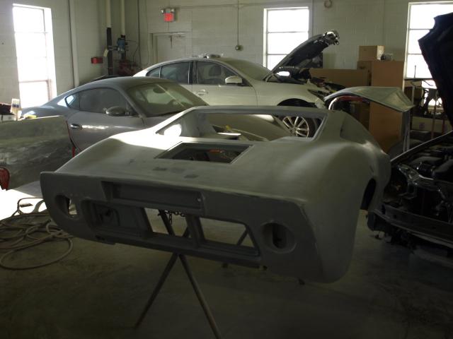

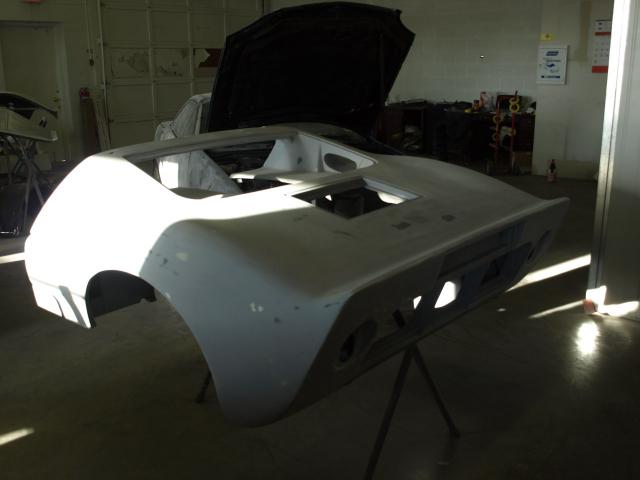

Some photos: the rear body section after surfacing and priming. It's going to get another coat of primer and some small pinholes filled, and then it will be ready to paint.

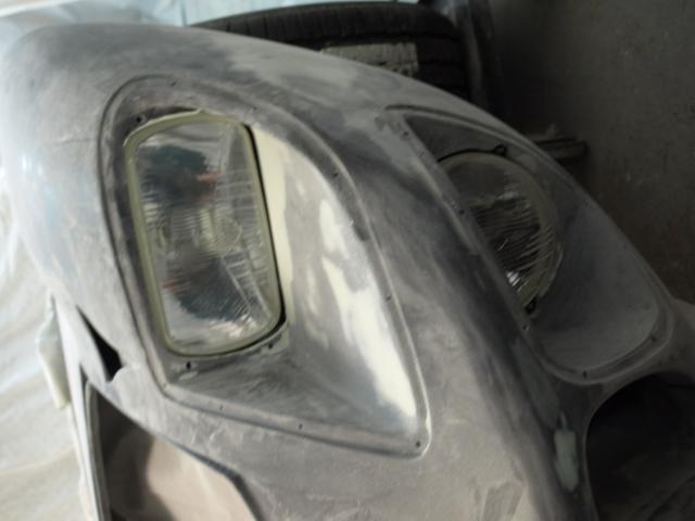

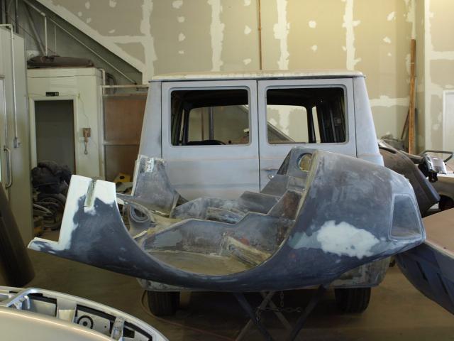

The photos of the front body section show the Marchal lights mounted, and also the rear partition in place to be glassed in. We have also made up an aluminum cover which will need to be dished to accommodate the back of the headlamp bulb assembly.
Another milestone reached; the GT40 is now covered by insurance. Shop only, but a start.

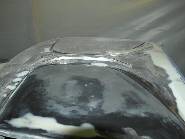

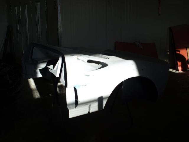

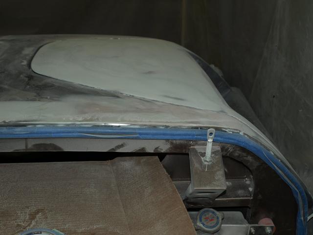

Trying again to get the right photos...this is a little better; shows the rear body section in the paint shop.

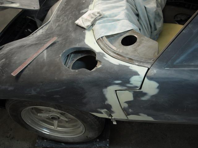

More photos from today...you can see the rear lamp partition, and also on the left side, the lamps themselves in place. We are going to light them up temporarily to make sure they can be aimed more or less in the right direction.

Minor progress at major expense; after the lights were mounted, we figured out that using self-tapping screws to hold them in would not work out in the long run- they would work loose and the lights wouldn't stay aimed. So they bored holes where the self-tapping screws were, and glassed captive nuts in; this way, the lamp mounts are actually bolted in. A lot of effort, but they will stay where they are supposed to. That work will be complete Monday, then the partitions go in, then the front clip goes to the painters (seems I've said THAT a few times)

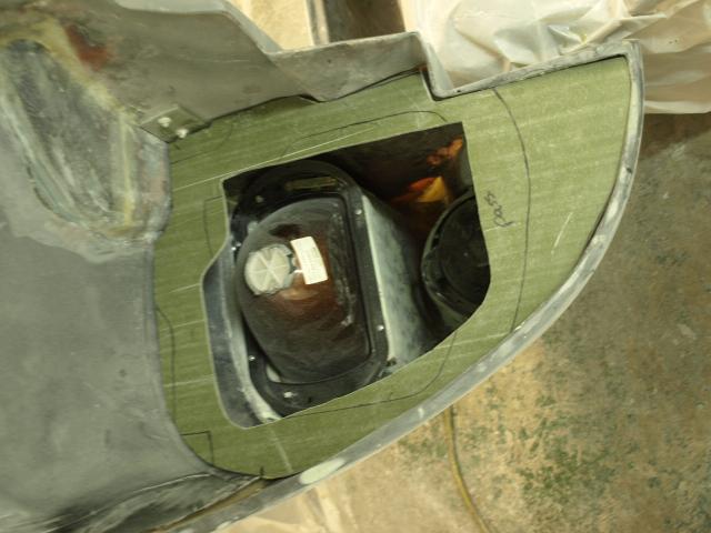

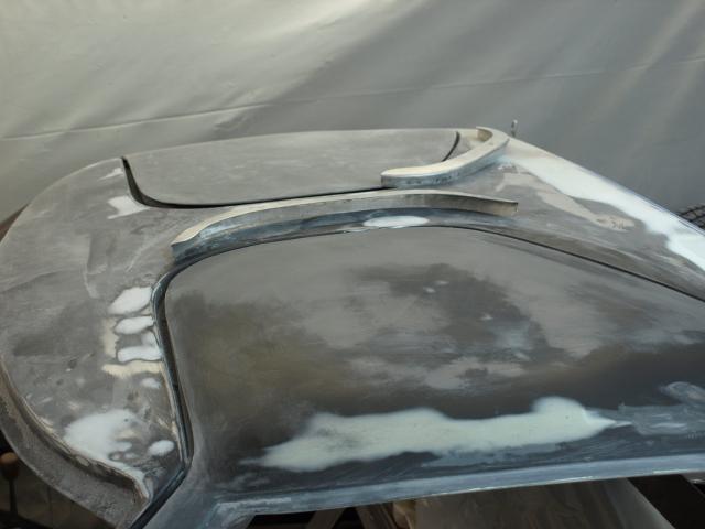

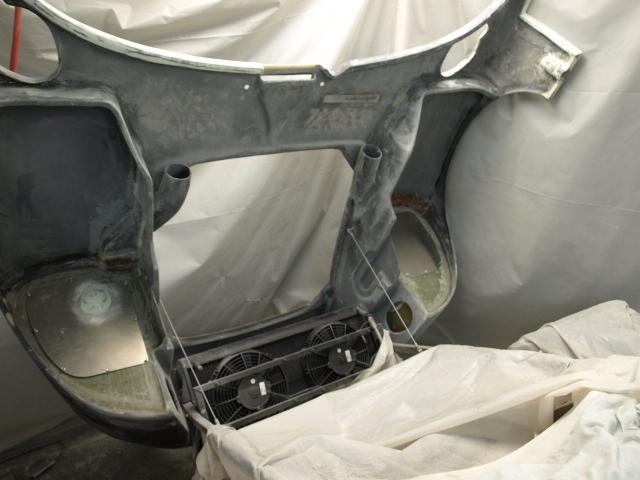

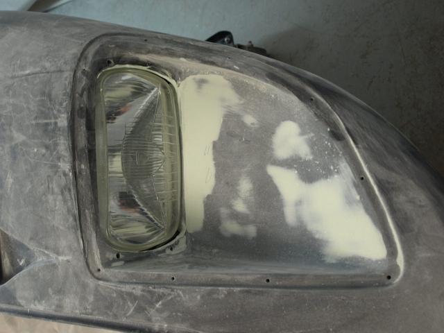

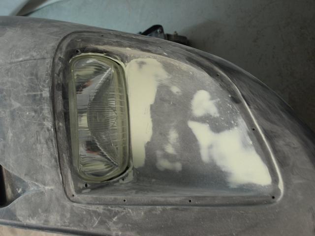

Some photos showing recent work; the partitions closing off the backs of the headlamp areas are in, and the metal plates as well. Also we are starting to look at the eyebrows and what to do about them, as well as the door shut lines and the wavy tops of the doors. The front clip will go to the paint shop this week.

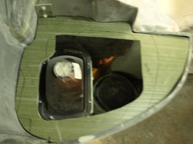

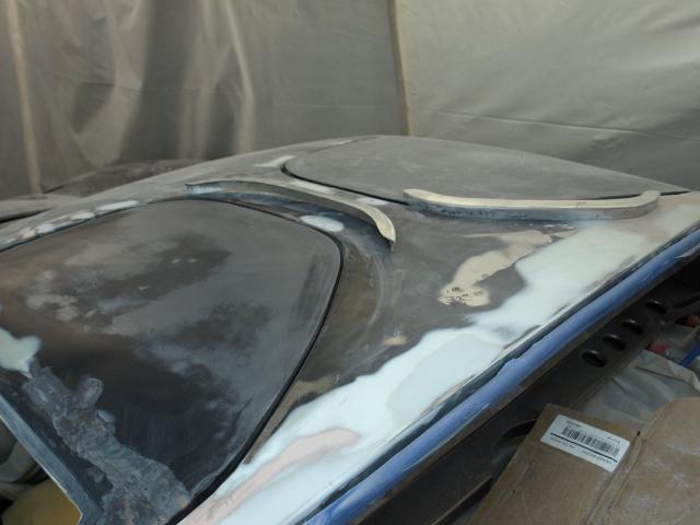

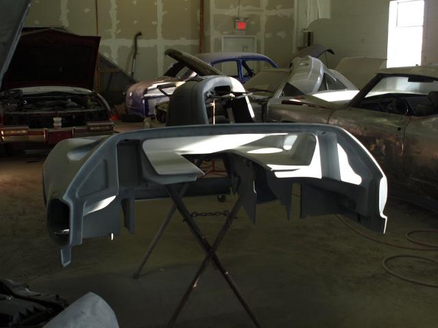

Some recent photos of the bodywork...the front clip is upside down, waiting for surfacer and prep work. You can see the final fit of the driver's side door, which is now flush with the roof. This required days of reworking the door to get it to fit around the seal properly and close snugly, but not too snugly.
Currently we are working on the passenger's side door. When that is completed, the bodywork will be done. Yesterday I ordered a kit of Clecos and a lot of aluminum rivets, so that we can begin patterning and installing the aluminum sheet metal sections in the front and back of the bodywork. I am still trying to figure out what they are supposed to look like; I have some photos from Jay Cushman that are helping a lot. We have the rear aluminum pan from him as well.
