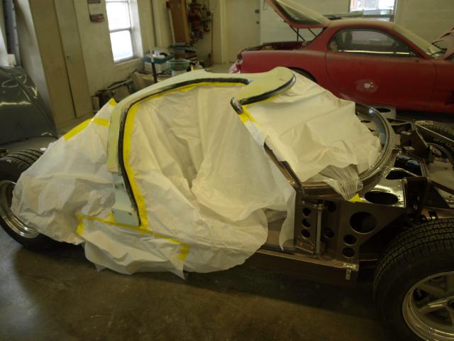

Went by the shop today and the passenger's side door is back on the car, nice and snug, getting the fit to the outside of the windshield frame corrected by building up the outside of the door a bit. Almost done on that one...

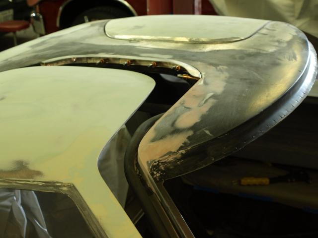

The one significant item left to do on the bodywork before paint is to fit the eyebrows. These are little handformed aluminum pieces that are intended to hold down the tip of the top part of each door when air flow etc want to pull them up. (I have a feeling that these were a work-in-progress design add-on when the tops of the doors were found to be lifting up at racing speeds, something my GT40 is unlikely to see very often. But they are part of the design and ought to be there, so they are the next and last thing.)
They don't fit well at all. The curvature lines up with the part of the door opening nearest the front of the car, but from there back it's all wrong. They are made of fairly soft aluminum, so what I think we are going to do (now that we have Clecos etc) is set the front end of each one in place with a Cleco and then work them slowly back, bending the aluminum to fit as we go towards the back of the car. That ought to work and result in a decent fit without a lot of stress in the parts when they are in place. After that, unless I miss my guess, we really will be done with the fitting work, and then we can get all the dust out of the body and chassis and set about getting the car painted and ready to actually put together.

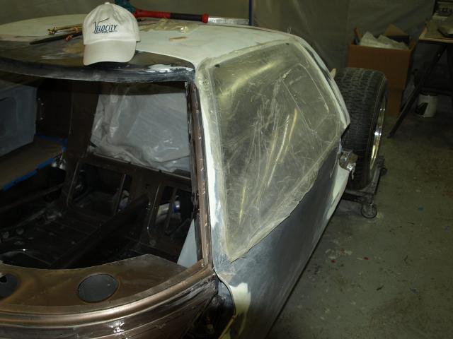

These photos are somewhat remarkable for what they DON'T show, as what they do...the plastic tent around the GT40 is mostly gone, as all the sanding of the bodywork and glass work is done. One eyebrow is riveted on, the other held on with Clecos as there wasn't time to rivet it today. The fit of the doors to the chassis is excellent, the hinges are solid and square (after much work strengthening the hinge points where the bushings are), and we've figured out how we are going to secure the windows to the bodywork once it's painted.
Next stop, body shop. Altogether a satisfying day.

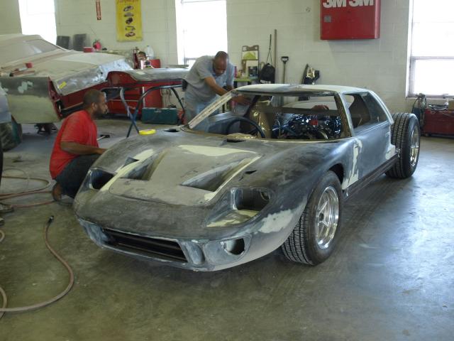

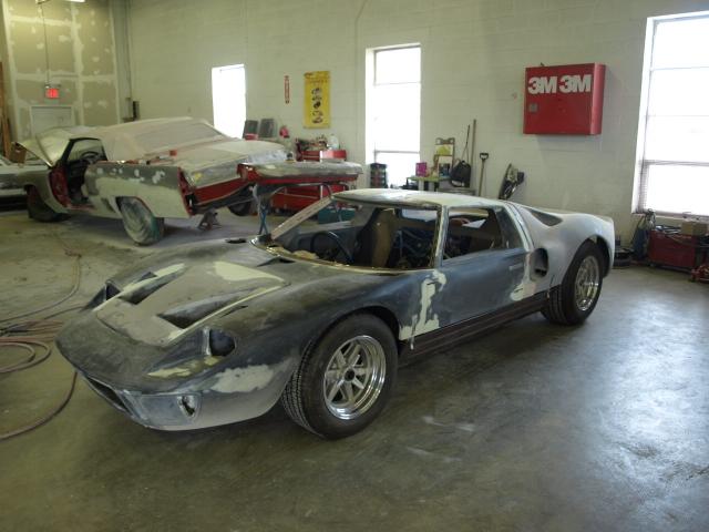

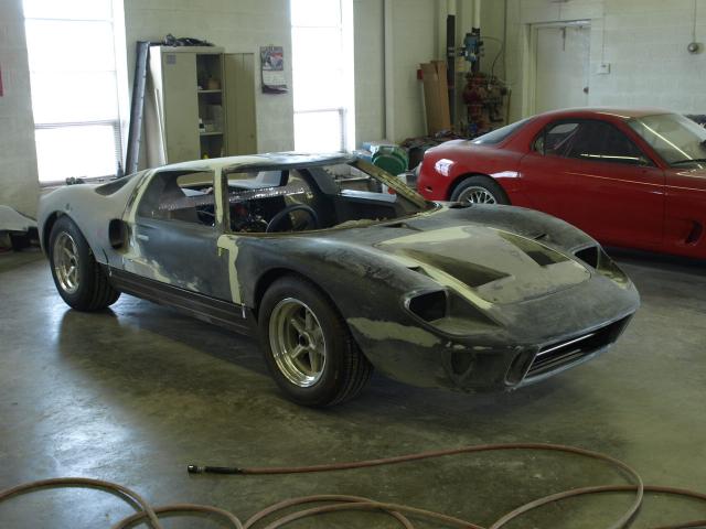

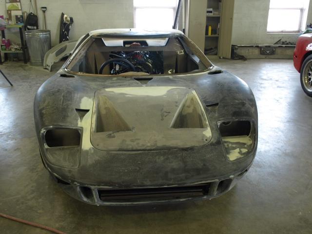

Photos of 1149 in the body shop. We refitted all the panels except for the rockers, which will go on early next week. Panel fit seems acceptable, although there are some areas where things are a bit tight and will have to be relieved somewhat. The rocker panels look okay; no mods needed to the rockers.

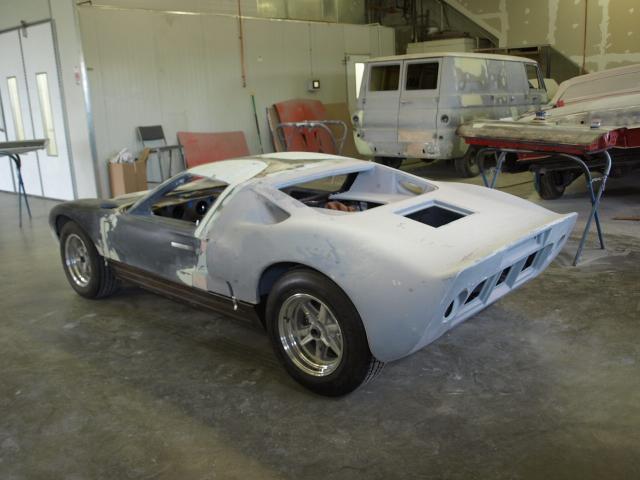

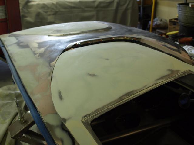

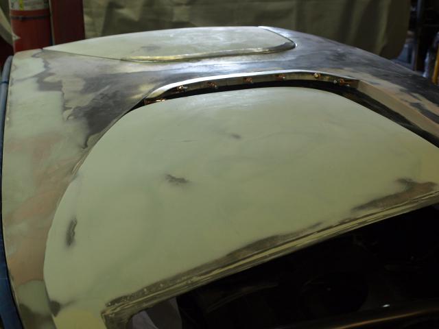

Progress report....front clip, doors and rocker panels sprayed in gray primer, and look quite good indeed. Next the rear clip, and then some remedial work on the steel roof, which isn't as smooth and free of waves as it ought to be. So I'm going to part with a few more bucks and get that taken care of as well. Meanwhile I am rounding up more bits and pieces, some courtesy of Forum members who have been very helpful and also generous with photos of things they've put on their GT40s. I might have some photos later this week, if all goes well.

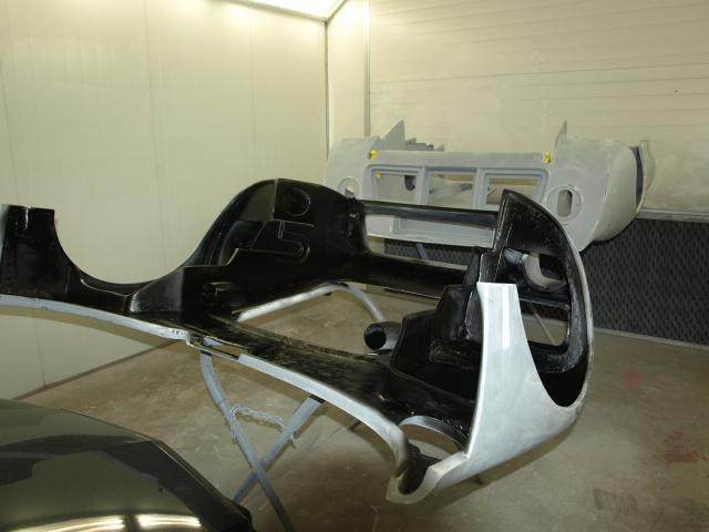

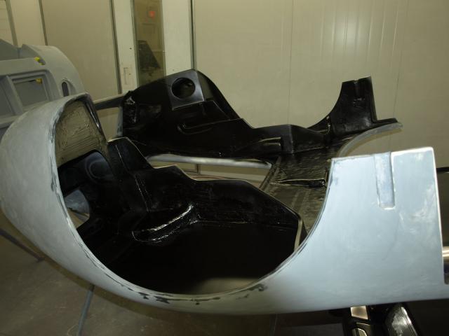

1149 in paint shop. Most of the priming is done, and they have started to spray the interior panels dull black, to match the dashboard etc. Also the insides of all the fiberglass body parts such as rockers, front and rear clips, etc. The fairing work on the monocoque turned out well; next step is to prime it and then it will be ready for body color.

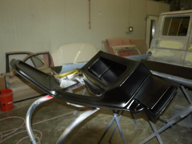

Jim Rosenthal

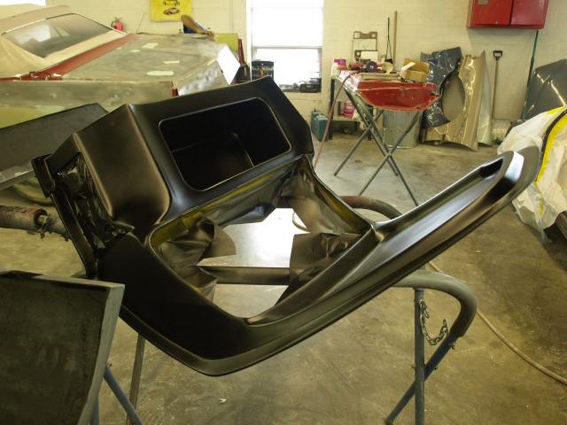

More photos from today: the insides of the doors are painted, and some bodywork inside surfaces as well. The chassis/rood section is ready for primer and taped off. Still to paint; the inside of the rear clip, which is the most complex part of the bodywork, and has the most sections which are difficult to shoot- all sorts of twists and turns and places the gun can't get inside.
