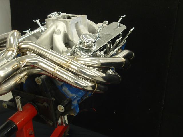

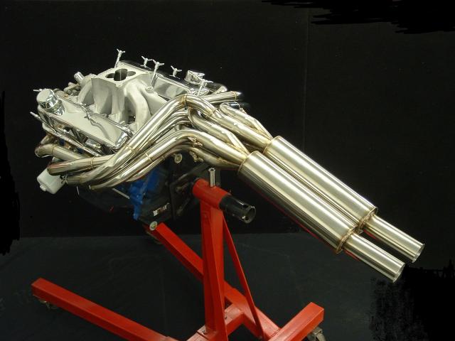

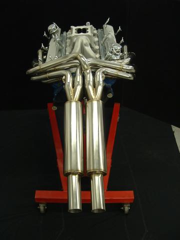

New exhaust system shipped today from Stainless Headers in Minnesota; they sent a couple of email photos, one of which I've attached here. With a bit of luck, I will have this system on the car within a week or two, and I will post photos then of the complete works, assuming it all fits without too much fiddling. These look very nice, I have to say.
Stainless Headers Inc have agreed to keep the old system as a pattern in the event that anyone else decides they want a similar system built for their car. Total cost to me was a bit under $1900 including shipping. I'll post photos showing how they fit on the car as soon as I've tried them out.

Beautiful Jim!
Stainless Headers has a really good reputation and will fabricate some quite complex
systems. Love their plumbing "kit" for set-up.

Too bloody right. ANyway, despite UPS' best efforts to frustrate everything, the exhaust system DID arrive and we unpacked it and fitted it yesterday. It's fantastic. The quality of the workmanship is peerless. We don't have it snugged up to the engine yet- there is a separate parcel containing Allen-head bolts which hasn't come. (because of clearance we have to use them to secure the header flanges to the heads.) But the overall fit and finish of the system is just beautiful.
Without the headers bolted up snugly we can't tell final positioning. Based on the photos from Stainless Headers we think the exhaust pipes will end up right in the middle of the rectangular opening in the rear bodywork. The angle over the ZF transaxle is just right.
Stainless Headers? I can't commend these guys highly enough. I wish they made a lot of other stuff for a GT40- they don't, but for the two things they've done so far- water pipes for Howard's car, and a bundle-of-snakes for mine- they've done quite well indeed. The old system that they used as a pattern is still out there, if anyone decides they need a setup like the one SH made for me.

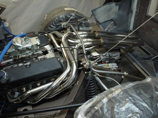

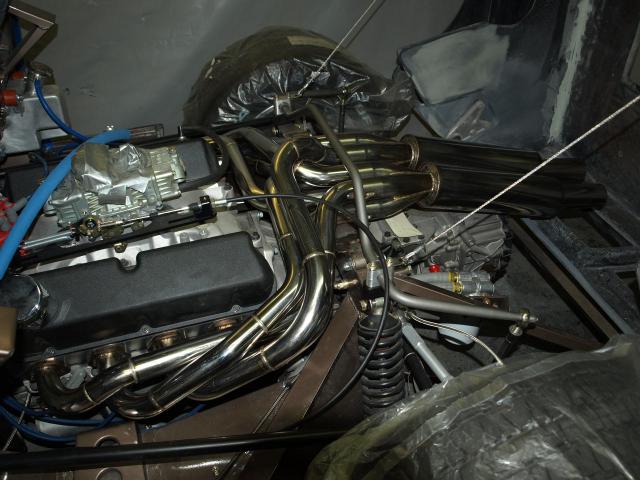

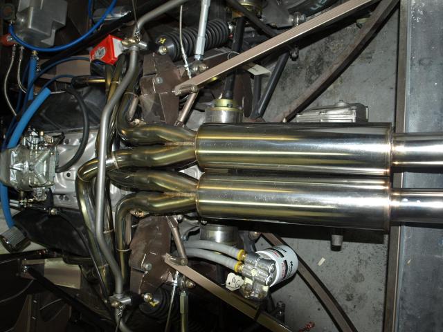

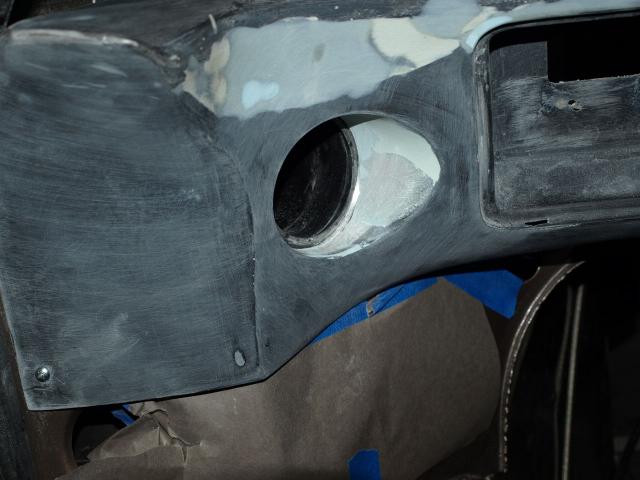

Here are a few progress photos: they show the dash vents located behind the dash, nicely set in- the dash comes out tomorrow and will go to the painters. Also the first install of the new exhaust system, although it is not tightly bolted up to the heads- waiting on gaskets and Allen-head bolts. Still, it seems to fit well and looks good. Along with the dash the first batch of access panel covers is going to the painters' as well, following which we'll bolt them in to keep them from getting lost....

Yeah, I have to admit I was thrilled when we bolted them up and it all fit. The paint shop is amazingly fast, so I should have all those little sheet-metal pieces back in a few days. Once we are able to get the whole car in for paint, the painter ought to be able to turn the car around in a month (unless we have an icy winter and he has a lot of collision work) I hope to have drawings and patterns made this week for the two brackets that hold up the back of the exhaust system and keep the remote oil filter lines from flapping around. Those won't take too long to make up, and then I can get them in and tucked away.
The dash was a LOT of work- the guys at Mamock's spent a lot of time and effort on getting the vents set into the monocoque, but the fit is at least as good as it is on 1072. They are moving along to the front clip: setting the headlights and driving lights in, getting the Hartwell latches to fit and hold, and the panels that close the backs of the headlights off from the front wheels. I hope to be in the paint shop in January- that would really be great, but there is a lot of stuff to do before then. The last thing to fit is the doors- the fit of the doors is bad and they will have to be partly cut apart and reglassed back together. They may have warped over time- a cautionary note to anyone who just has them leaning up against something. They sit proud of the roof and have to be brought into better alignment with the roof spider, plus those curved aluminum items that hold the very tips of the doors down have to be fitted and riveted on. (I assume they ARE riveted on, aren't they?)
