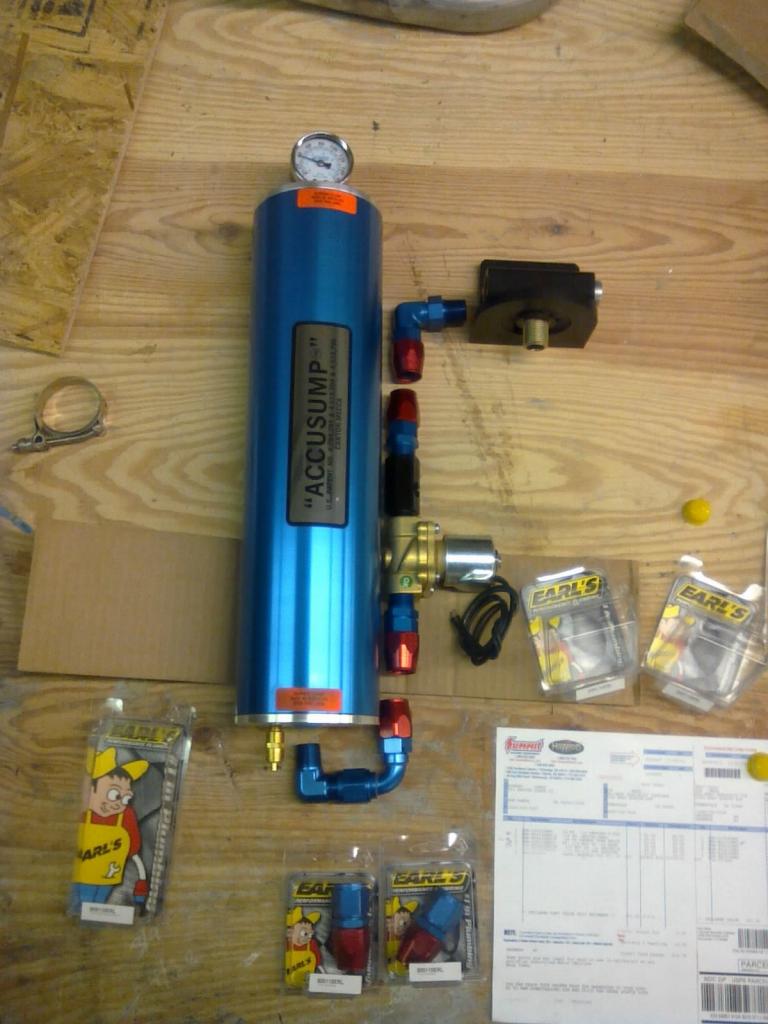

So I worked out the switch question. Ordered up the unit...stuffed it in the chassis, laid out the best routing for the plumbing, bought all the fittings......then came the realization that the fittings take up too much space to fit it all in the desired location. The run from the bottom of the tank to the entry into the remote oil filter housing can take no more than 14 inches. This leaves no space to actually connect the fittings with braided hoses. It's pretty much non-stop fittings.
I have seen a few on this site make the AC system plumbing out of copper tubing, utilizing components normally seen in home water systems. An approach such as this or some variation would eliminate most of these fittings and make the overall length much shorter.
So here is my question
If I wanted to make the connections using a tubing solution (possibly similar to what we all do with water system vent lines) - What material should be used? Of course it would be a much larger diameter tube as the oil system is -10. It would also take a serious tubing bender and flair tool to make the tube segments.
Or could one actually make this work using simple copper solder together fittings?
Regardless, the run from the engine side of the filter housing will be - 10 braided line.
Thoughts, comments and recommendations appreciated.

Rob,
Instead of using the most direct route between Accusump and filter can you go a different direction and then back to the filter to allow space for all the fittings? Do you have an oil cooler also? I wouldn't worry about keeping lines at an absolute minimum length. I have -12 lines and probably 8 feet of line between Accusump, cooler, and filter. Works fine for track days.
Hi Dave,
My problem is a space issue, the cleanest most efficient way is this picture. After that I start using up valuable engine room.
thanks for the thought
Rob
PS No oil cooler at this time.
Rob-
Can you rotate your fittings coming out of the sump between 90 and 180 degrees and bring your hose up along the left side? If so, a possible routing might be to run your hose up to the top, through a 180* bend down into the valve and out of the valve into a male by male elbow screwed directly into the remote filter.
Yes Dave - at the filter.
John - The tank sits in the far left corner of the space, there are frame members directly the left of the tank.

Rob,
Can use replace the top two fittings with one 90 degree male NPT fitting? Or replace the straight NPT fitting and the 90 degree AN fitting at the bottom with a NPT-male AN fitting and a 90 degree double AN female fitting? Either would shorten up your plumbing and eliminate one hose piece. It is hard to tell your spatial limitations without seeing your engine bay.

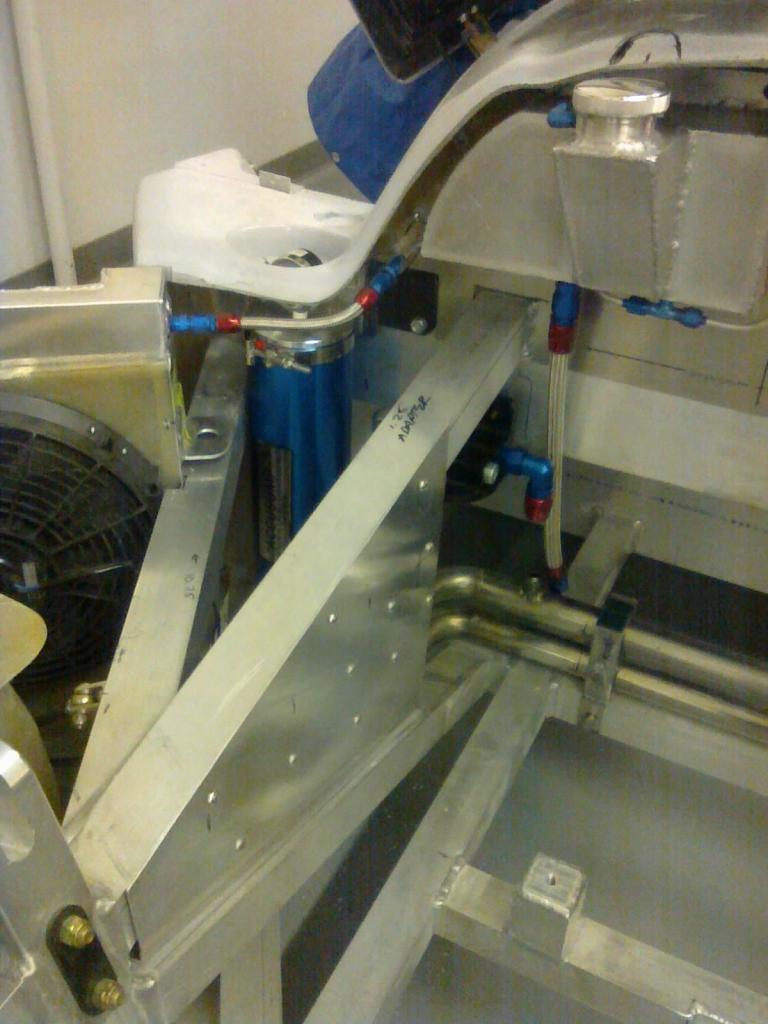

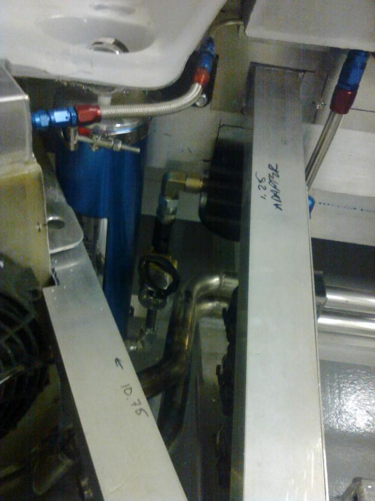

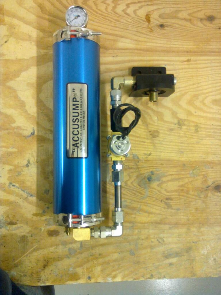

To close the loop on this, a local hydraulics house was able to piece together the proper length fittings and hardline to get this assembly into the car in the desired location. Although it is hard to tell, there is plenty of room for the oil filter to be removed from the space.
Thanks all for the suggestions.
